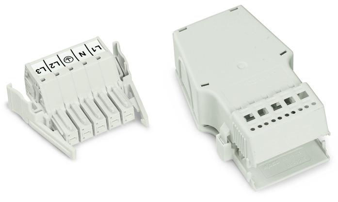

| Производитель | Wago |
| Серия | 831 |
| Parameters / Models | 831-137![]() | 831-3102![]() | 831-3102/000-9037![]() | 831-3102/037-000![]() | 831-3102/037-9037![]() | 831-3102/133-000![]() | 831-3103![]() | 831-3103/000-9037![]() | 831-3103/037-000![]() | 831-3103/037-9037![]() | 831-3103/133-000![]() | 831-3104![]() | 831-3104/000-9037![]() | 831-3104/037-000![]() | 831-3104/037-9037![]() | 831-3104/135-000![]() | 831-3105![]() | 831-3105/000-9035![]() | 831-3105/000-9037![]() | 831-3105/037-000![]() | 831-3105/037-9037![]() | 831-3105/1019-004![]() | 831-3105/1019-050![]() | 831-3105/135-000![]() | 831-3106![]() | 831-3106/000-9037![]() | 831-3106/037-000![]() | 831-3106/037-9037![]() | 831-3106/135-000![]() | 831-3107![]() | 831-3107/000-9037![]() | 831-3107/037-000![]() | 831-3107/037-9037![]() | 831-3107/136-000![]() | 831-3108![]() | 831-3108/000-9037![]() | 831-3108/037-000![]() | 831-3108/037-9037![]() | 831-3108/136-000![]() | 831-3109![]() | 831-3109/037-000![]() | 831-3109/136-000![]() | 831-3202![]() | 831-3202/000-9034![]() | 831-3202/007-000![]() | 831-3202/007-9034![]() | 831-3202/133-000![]() | 831-3203![]() | 831-3203/000-9034![]() | 831-3203/007-000![]() | 831-3203/007-9034![]() | 831-3203/133-000![]() | 831-3204![]() | 831-3204/000-9034![]() | 831-3204/007-000![]() | 831-3204/007-9034![]() | 831-3204/135-000![]() | 831-3205![]() | 831-3205/000-9032![]() | 831-3205/000-9034![]() | 831-3205/007-000![]() | 831-3205/007-9034![]() | 831-3205/1020-004![]() | 831-3205/1020-050![]() | 831-3205/135-000![]() | 831-3206![]() | 831-3206/000-9034![]() | 831-3206/007-000![]() | 831-3206/007-9034![]() | 831-3206/135-000![]() | 831-3207![]() | 831-3207/000-9034![]() | 831-3207/007-000![]() | 831-3207/007-9034![]() | 831-3207/136-000![]() | 831-3208![]() | 831-3208/000-9034![]() | 831-3208/007-000![]() | 831-3208/007-9034![]() | 831-3208/136-000![]() | 831-3209![]() | 831-3209/007-000![]() | 831-3209/136-000![]() | 831-3602![]() | 831-3603![]() | 831-3604![]() | 831-3605![]() | 831-3606![]() | 831-3607![]() | 831-3608![]() | 831-3609![]() | 831-3622![]() | 831-3623![]() | 831-3624![]() | 831-3625![]() | 831-3626![]() | 831-3627![]() | 831-3628![]() | 831-3629![]() | 831-500![]() |
| Actuation type | Operating tool | Operating tool | Operating tool | Operating tool | Operating tool | Operating tool | Operating tool | Operating tool | Operating tool | Operating tool | Operating tool | Operating tool | Operating tool | Operating tool | Operating tool | Operating tool | Operating tool | Operating tool | Operating tool | Operating tool | Operating tool | Operating tool | Operating tool | Operating tool | Operating tool | Operating tool | Operating tool | Operating tool | Operating tool | Operating tool | Operating tool | Operating tool | Operating tool | Operating tool | Operating tool | Operating tool | Operating tool | Operating tool | Operating tool | Operating tool | Operating tool | Operating tool | Operating tool | Operating tool | Operating tool | Operating tool | Operating tool | Operating tool | Operating tool | Operating tool | Operating tool | Operating tool | Operating tool | Operating tool | Operating tool | Operating tool | Operating tool | Operating tool | Operating tool | Operating tool | Operating tool | Operating tool | Operating tool | Operating tool | Operating tool | Operating tool | Operating tool | Operating tool | Operating tool | Operating tool | Operating tool | Operating tool | Operating tool | Operating tool | Operating tool | Operating tool | Operating tool | Operating tool | Operating tool | Operating tool | Operating tool | Operating tool | ||||||||||||||||||
| Clamping spring material | Chrome nickel spring steel (CrNi) | Chrome nickel spring steel (CrNi) | Chrome nickel spring steel (CrNi) | Chrome nickel spring steel (CrNi) | Chrome nickel spring steel (CrNi) | Chrome nickel spring steel (CrNi) | Chrome nickel spring steel (CrNi) | Chrome nickel spring steel (CrNi) | Chrome nickel spring steel (CrNi) | Chrome nickel spring steel (CrNi) | Chrome nickel spring steel (CrNi) | Chrome nickel spring steel (CrNi) | Chrome nickel spring steel (CrNi) | Chrome nickel spring steel (CrNi) | Chrome nickel spring steel (CrNi) | Chrome nickel spring steel (CrNi) | Chrome nickel spring steel (CrNi) | Chrome nickel spring steel (CrNi) | Chrome nickel spring steel (CrNi) | Chrome nickel spring steel (CrNi) | Chrome nickel spring steel (CrNi) | Chrome nickel spring steel (CrNi) | Chrome nickel spring steel (CrNi) | Chrome nickel spring steel (CrNi) | Chrome nickel spring steel (CrNi) | Chrome nickel spring steel (CrNi) | Chrome nickel spring steel (CrNi) | Chrome nickel spring steel (CrNi) | Chrome nickel spring steel (CrNi) | Chrome nickel spring steel (CrNi) | Chrome nickel spring steel (CrNi) | Chrome nickel spring steel (CrNi) | Chrome nickel spring steel (CrNi) | Chrome nickel spring steel (CrNi) | Chrome nickel spring steel (CrNi) | Chrome nickel spring steel (CrNi) | Chrome nickel spring steel (CrNi) | Chrome nickel spring steel (CrNi) | Chrome nickel spring steel (CrNi) | Chrome nickel spring steel (CrNi) | Chrome nickel spring steel (CrNi) | Chrome nickel spring steel (CrNi) | Chrome nickel spring steel (CrNi) | Chrome nickel spring steel (CrNi) | Chrome nickel spring steel (CrNi) | Chrome nickel spring steel (CrNi) | Chrome nickel spring steel (CrNi) | Chrome nickel spring steel (CrNi) | Chrome nickel spring steel (CrNi) | Chrome nickel spring steel (CrNi) | Chrome nickel spring steel (CrNi) | Chrome nickel spring steel (CrNi) | Chrome nickel spring steel (CrNi) | Chrome nickel spring steel (CrNi) | Chrome nickel spring steel (CrNi) | Chrome nickel spring steel (CrNi) | Chrome nickel spring steel (CrNi) | Chrome nickel spring steel (CrNi) | Chrome nickel spring steel (CrNi) | Chrome nickel spring steel (CrNi) | Chrome nickel spring steel (CrNi) | Chrome nickel spring steel (CrNi) | Chrome nickel spring steel (CrNi) | Chrome nickel spring steel (CrNi) | Chrome nickel spring steel (CrNi) | Chrome nickel spring steel (CrNi) | Chrome nickel spring steel (CrNi) | Chrome nickel spring steel (CrNi) | Chrome nickel spring steel (CrNi) | Chrome nickel spring steel (CrNi) | Chrome nickel spring steel (CrNi) | Chrome nickel spring steel (CrNi) | Chrome nickel spring steel (CrNi) | Chrome nickel spring steel (CrNi) | Chrome nickel spring steel (CrNi) | Chrome nickel spring steel (CrNi) | Chrome nickel spring steel (CrNi) | Chrome nickel spring steel (CrNi) | Chrome nickel spring steel (CrNi) | Chrome nickel spring steel (CrNi) | Chrome nickel spring steel (CrNi) | Chrome nickel spring steel (CrNi) | ||||||||||||||||||
| Coding | A | A | A | A | ||||||||||||||||||||||||||||||||||||||||||||||||||||||||||||||||||||||||||||||||||||||||||||||||
| Цвет | light gray | light gray | light gray | light gray | light gray | light gray | light gray | light gray | light gray | light gray | light gray | light gray | light gray | light gray | light gray | light gray | light gray | light gray | light gray | light gray | light gray | black | white | light gray | light gray | light gray | light gray | light gray | light gray | light gray | light gray | light gray | light gray | light gray | light gray | light gray | light gray | light gray | light gray | light gray | light gray | light gray | light gray | light gray | light gray | light gray | light gray | light gray | light gray | light gray | light gray | light gray | light gray | light gray | light gray | light gray | light gray | light gray | light gray | light gray | light gray | light gray | black | white | light gray | light gray | light gray | light gray | light gray | light gray | light gray | light gray | light gray | light gray | light gray | light gray | light gray | light gray | light gray | light gray | light gray | light gray | light gray | light gray | light gray | light gray | light gray | light gray | light gray | light gray | light gray | light gray | light gray | light gray | light gray | light gray | light gray | light gray | light gray | orange |
| Connectable sheathed cable diameter | 13 … 18 mm | 13 … 18 mm | 13 … 18 mm | 13 … 18 mm | ||||||||||||||||||||||||||||||||||||||||||||||||||||||||||||||||||||||||||||||||||||||||||||||||
| Connection technology | Push-in CAGE CLAMP® | Push-in CAGE CLAMP® | Push-in CAGE CLAMP® | Push-in CAGE CLAMP® | Push-in CAGE CLAMP® | Push-in CAGE CLAMP® | Push-in CAGE CLAMP® | Push-in CAGE CLAMP® | Push-in CAGE CLAMP® | Push-in CAGE CLAMP® | Push-in CAGE CLAMP® | Push-in CAGE CLAMP® | Push-in CAGE CLAMP® | Push-in CAGE CLAMP® | Push-in CAGE CLAMP® | Push-in CAGE CLAMP® | Push-in CAGE CLAMP® | Push-in CAGE CLAMP® | Push-in CAGE CLAMP® | Push-in CAGE CLAMP® | Push-in CAGE CLAMP® | Push-in CAGE CLAMP® | Push-in CAGE CLAMP® | Push-in CAGE CLAMP® | Push-in CAGE CLAMP® | Push-in CAGE CLAMP® | Push-in CAGE CLAMP® | Push-in CAGE CLAMP® | Push-in CAGE CLAMP® | Push-in CAGE CLAMP® | Push-in CAGE CLAMP® | Push-in CAGE CLAMP® | Push-in CAGE CLAMP® | Push-in CAGE CLAMP® | Push-in CAGE CLAMP® | Push-in CAGE CLAMP® | Push-in CAGE CLAMP® | Push-in CAGE CLAMP® | Push-in CAGE CLAMP® | Push-in CAGE CLAMP® | Push-in CAGE CLAMP® | Push-in CAGE CLAMP® | Push-in CAGE CLAMP® | Push-in CAGE CLAMP® | Push-in CAGE CLAMP® | Push-in CAGE CLAMP® | Push-in CAGE CLAMP® | Push-in CAGE CLAMP® | Push-in CAGE CLAMP® | Push-in CAGE CLAMP® | Push-in CAGE CLAMP® | Push-in CAGE CLAMP® | Push-in CAGE CLAMP® | Push-in CAGE CLAMP® | Push-in CAGE CLAMP® | Push-in CAGE CLAMP® | Push-in CAGE CLAMP® | Push-in CAGE CLAMP® | Push-in CAGE CLAMP® | Push-in CAGE CLAMP® | Push-in CAGE CLAMP® | Push-in CAGE CLAMP® | Push-in CAGE CLAMP® | Push-in CAGE CLAMP® | Push-in CAGE CLAMP® | Push-in CAGE CLAMP® | Push-in CAGE CLAMP® | Push-in CAGE CLAMP® | Push-in CAGE CLAMP® | Push-in CAGE CLAMP® | Push-in CAGE CLAMP® | Push-in CAGE CLAMP® | Push-in CAGE CLAMP® | Push-in CAGE CLAMP® | Push-in CAGE CLAMP® | Push-in CAGE CLAMP® | Push-in CAGE CLAMP® | Push-in CAGE CLAMP® | Push-in CAGE CLAMP® | Push-in CAGE CLAMP® | Push-in CAGE CLAMP® | Push-in CAGE CLAMP® | ||||||||||||||||||
| Connection technology 2 | Quick-connect/Solder contact | Quick-connect/Solder contact | Quick-connect/Solder contact | Quick-connect/Solder contact | Quick-connect/Solder contact | Quick-connect/Solder contact | Quick-connect/Solder contact | Quick-connect/Solder contact | Quick-connect/Solder contact | Quick-connect/Solder contact | Quick-connect/Solder contact | Quick-connect/Solder contact | Quick-connect/Solder contact | Quick-connect/Solder contact | Quick-connect/Solder contact | Quick-connect/Solder contact | Quick-connect/Solder contact | Quick-connect/Solder contact | Quick-connect/Solder contact | Quick-connect/Solder contact | Quick-connect/Solder contact | |||||||||||||||||||||||||||||||||||||||||||||||||||||||||||||||||||||||||||||||
| Connector connection type | for conductors | for conductors | for conductors | for conductors | for conductors | for conductors | for conductors | for conductors | for conductors | for conductors | for conductors | for conductors | for conductors | for conductors | for conductors | for conductors | for conductors | for conductors | for conductors | for conductors | for conductors | for conductors | for conductors | for conductors | for conductors | for conductors | for conductors | for conductors | for conductors | for conductors | for conductors | for conductors | for conductors | for conductors | for conductors | for conductors | for conductors | for conductors | for conductors | for conductors | for conductors | for conductors | for conductors | for conductors | for conductors | for conductors | for conductors | for conductors | for conductors | for conductors | for conductors | for conductors | for conductors | for conductors | for conductors | for conductors | for conductors | for conductors | for conductors | for conductors | for conductors | for conductors | for conductors | for conductors | for conductors | for conductors | for conductors | for conductors | for conductors | for conductors | for conductors | for conductors | for conductors | for conductors | for conductors | for conductors | for conductors | for conductors | for conductors | for conductors | for conductors | for conductors | for PCBs | for PCBs | for PCBs | for PCBs | for PCBs | for PCBs | for PCBs | for PCBs | for PCBs | for PCBs | for PCBs | for PCBs | for PCBs | for PCBs | for PCBs | for PCBs | ||
| Contact material | Electrolytic copper (Ecu) | Electrolytic copper (Ecu) | Electrolytic copper (Ecu) | Electrolytic copper (Ecu) | Electrolytic copper (Ecu) | Electrolytic copper (Ecu) | Electrolytic copper (Ecu) | Electrolytic copper (Ecu) | Electrolytic copper (Ecu) | Electrolytic copper (Ecu) | Electrolytic copper (Ecu) | Electrolytic copper (Ecu) | Electrolytic copper (Ecu) | Electrolytic copper (Ecu) | Electrolytic copper (Ecu) | Electrolytic copper (Ecu) | Electrolytic copper (Ecu) | Electrolytic copper (Ecu) | Electrolytic copper (Ecu) | Electrolytic copper (Ecu) | Copper or copper alloy, surface-treated | Copper or copper alloy, surface-treated | Electrolytic copper (Ecu) | Electrolytic copper (Ecu) | Electrolytic copper (Ecu) | Electrolytic copper (Ecu) | Electrolytic copper (Ecu) | Electrolytic copper (Ecu) | Electrolytic copper (Ecu) | Electrolytic copper (Ecu) | Electrolytic copper (Ecu) | Electrolytic copper (Ecu) | Electrolytic copper (Ecu) | Electrolytic copper (Ecu) | Electrolytic copper (Ecu) | Electrolytic copper (Ecu) | Electrolytic copper (Ecu) | Electrolytic copper (Ecu) | Electrolytic copper (Ecu) | Electrolytic copper (Ecu) | Electrolytic copper (Ecu) | Electrolytic copper (Ecu) | Electrolytic copper (Ecu) | Electrolytic copper (Ecu) | Electrolytic copper (Ecu) | Electrolytic copper (Ecu) | Electrolytic copper (Ecu) | Electrolytic copper (Ecu) | Electrolytic copper (Ecu) | Electrolytic copper (Ecu) | Electrolytic copper (Ecu) | Electrolytic copper (Ecu) | Electrolytic copper (Ecu) | Electrolytic copper (Ecu) | Electrolytic copper (Ecu) | Electrolytic copper (Ecu) | Electrolytic copper (Ecu) | Electrolytic copper (Ecu) | Electrolytic copper (Ecu) | Electrolytic copper (Ecu) | Electrolytic copper (Ecu) | Copper or copper alloy, surface-treated | Copper or copper alloy, surface-treated | Electrolytic copper (Ecu) | Electrolytic copper (Ecu) | Electrolytic copper (Ecu) | Electrolytic copper (Ecu) | Electrolytic copper (Ecu) | Electrolytic copper (Ecu) | Electrolytic copper (Ecu) | Electrolytic copper (Ecu) | Electrolytic copper (Ecu) | Electrolytic copper (Ecu) | Electrolytic copper (Ecu) | Electrolytic copper (Ecu) | Electrolytic copper (Ecu) | Electrolytic copper (Ecu) | Electrolytic copper (Ecu) | Electrolytic copper (Ecu) | Electrolytic copper (Ecu) | Electrolytic copper (Ecu) | Electrolytic copper (Ecu) | Electrolytic copper (Ecu) | Electrolytic copper (Ecu) | Electrolytic copper (Ecu) | Electrolytic copper (Ecu) | Electrolytic copper (Ecu) | Electrolytic copper (Ecu) | Electrolytic copper (Ecu) | Electrolytic copper (Ecu) | Electrolytic copper (Ecu) | Electrolytic copper (Ecu) | Electrolytic copper (Ecu) | Electrolytic copper (Ecu) | Electrolytic copper (Ecu) | Electrolytic copper (Ecu) | Electrolytic copper (Ecu) | Electrolytic copper (Ecu) | ||
| Contact plating | tin-plated | tin-plated | tin-plated | tin-plated | tin-plated | tin-plated | tin-plated | tin-plated | tin-plated | tin-plated | tin-plated | tin-plated | tin-plated | tin-plated | tin-plated | tin-plated | tin-plated | tin-plated | tin-plated | tin-plated | tin-plated | tin-plated | tin-plated | tin-plated | tin-plated | tin-plated | tin-plated | tin-plated | tin-plated | tin-plated | tin-plated | tin-plated | tin-plated | tin-plated | tin-plated | tin-plated | tin-plated | tin-plated | tin-plated | tin-plated | tin-plated | tin-plated | tin-plated | tin-plated | tin-plated | tin-plated | tin-plated | tin-plated | tin-plated | tin-plated | tin-plated | tin-plated | tin-plated | tin-plated | tin-plated | tin-plated | tin-plated | tin-plated | tin-plated | tin-plated | tin-plated | tin-plated | tin-plated | tin-plated | tin-plated | tin-plated | tin-plated | tin-plated | tin-plated | tin-plated | tin-plated | tin-plated | tin-plated | tin-plated | tin-plated | tin-plated | tin-plated | tin-plated | tin-plated | tin-plated | tin-plated | tin-plated | tin-plated | tin-plated | tin-plated | tin-plated | tin-plated | tin-plated | tin-plated | tin-plated | tin-plated | tin-plated | tin-plated | tin-plated | ||||||
| Contact type (pluggable connector) | Female connector/socket | Female connector/socket | Female connector/socket | Female connector/socket | Female connector/socket | Female connector/socket | Female connector/socket | Female connector/socket | Female connector/socket | Female connector/socket | Female connector/socket | Female connector/socket | Female connector/socket | Female connector/socket | Female connector/socket | Female connector/socket | Female connector/socket | Female connector/socket | Female connector/socket | Female connector/socket | Female connector/socket | Female connector/socket | Female connector/socket | Female connector/socket | Female connector/socket | Female connector/socket | Female connector/socket | Female connector/socket | Female connector/socket | Female connector/socket | Female connector/socket | Female connector/socket | Female connector/socket | Female connector/socket | Female connector/socket | Female connector/socket | Female connector/socket | Female connector/socket | Female connector/socket | Female connector/socket | Female connector/socket | Male connector/plug | Male connector/plug | Male connector/plug | Male connector/plug | Male connector/plug | Male connector/plug | Male connector/plug | Male connector/plug | Male connector/plug | Male connector/plug | Male connector/plug | Male connector/plug | Male connector/plug | Male connector/plug | Male connector/plug | Male connector/plug | Male connector/plug | Male connector/plug | Male connector/plug | Male connector/plug | Male connector/plug | Male connector/plug | Male connector/plug | Male connector/plug | Male connector/plug | Male connector/plug | Male connector/plug | Male connector/plug | Male connector/plug | Male connector/plug | Male connector/plug | Male connector/plug | Male connector/plug | Male connector/plug | Male connector/plug | Male connector/plug | Male connector/plug | Male connector/plug | Male connector/plug | Male connector/plug | Male connector/plug | Male connector/plug | Male connector/plug | Male connector/plug | Male connector/plug | Male connector/plug | Male connector/plug | Male connector/plug | Male connector/plug | Male connector/plug | Male connector/plug | Male connector/plug | Male connector/plug | Male connector/plug | Male connector/plug | Male connector/plug | Male connector/plug | ||
| Country of origin | DE | DE | DE | DE | DE | DE | DE | DE | DE | DE | DE | DE | DE | DE | DE | DE | DE | DE | DE | DE | DE | DE | DE | DE | DE | DE | DE | DE | DE | DE | DE | DE | DE | DE | DE | DE | DE | DE | DE | DE | DE | DE | DE | DE | DE | DE | DE | DE | DE | DE | DE | DE | DE | DE | DE | DE | DE | DE | DE | DE | DE | DE | DE | DE | DE | DE | DE | DE | DE | DE | DE | DE | DE | DE | DE | DE | DE | DE | DE | DE | DE | DE | DE | PL | PL | PL | PL | PL | PL | PL | PL | PL | PL | PL | PL | PL | PL | PL | PL | DE |
| Degree of protection | IP20 | IP20 | IP20 | IP20 | ||||||||||||||||||||||||||||||||||||||||||||||||||||||||||||||||||||||||||||||||||||||||||||||||
| Габариты: глубина | 41.9 mm / 1.65 inch | 41.9 mm / 1.65 inch | 41.9 mm / 1.65 inch | 41.9 mm / 1.65 inch | 41.9 mm / 1.65 inch | 41.9 mm / 1.65 inch | 41.9 mm / 1.65 inch | 41.9 mm / 1.65 inch | 41.9 mm / 1.65 inch | 41.9 mm / 1.65 inch | 41.9 mm / 1.65 inch | 41.9 mm / 1.65 inch | 41.9 mm / 1.65 inch | 41.9 mm / 1.65 inch | 41.9 mm / 1.65 inch | 41.9 mm / 1.65 inch | 41.9 mm / 1.65 inch | 41.9 mm / 1.65 inch | 41.9 mm / 1.65 inch | 41.9 mm / 1.65 inch | 41.9 mm / 1.65 inch | 41.9 mm / 1.65 inch | 41.9 mm / 1.65 inch | 41.9 mm / 1.65 inch | 41.9 mm / 1.65 inch | 41.9 mm / 1.65 inch | 41.9 mm / 1.65 inch | 41.9 mm / 1.65 inch | 41.9 mm / 1.65 inch | 41.9 mm / 1.65 inch | 41.9 mm / 1.65 inch | 41.9 mm / 1.65 inch | 41.9 mm / 1.65 inch | 41.9 mm / 1.65 inch | 41.9 mm / 1.65 inch | 41.9 mm / 1.65 inch | 41.9 mm / 1.65 inch | 41.9 mm / 1.65 inch | 41.9 mm / 1.65 inch | 41.9 mm / 1.65 inch | 41.9 mm / 1.65 inch | 46 mm / 1.811 inch | 46 mm / 1.811 inch | 46 mm / 1.811 inch | 46 mm / 1.811 inch | 46 mm / 1.811 inch | 46 mm / 1.811 inch | 46 mm / 1.811 inch | 46 mm / 1.811 inch | 46 mm / 1.811 inch | 46 mm / 1.811 inch | 46 mm / 1.811 inch | 46 mm / 1.811 inch | 46 mm / 1.811 inch | 46 mm / 1.811 inch | 46 mm / 1.811 inch | 46 mm / 1.811 inch | 46 mm / 1.811 inch | 46 mm / 1.811 inch | 46 mm / 1.811 inch | 46 mm / 1.811 inch | 46 mm / 1.811 inch | 46 mm / 1.811 inch | 46 mm / 1.811 inch | 46 mm / 1.811 inch | 46 mm / 1.811 inch | 46 mm / 1.811 inch | 46 mm / 1.811 inch | 46 mm / 1.811 inch | 46 mm / 1.811 inch | 46 mm / 1.811 inch | 46 mm / 1.811 inch | 46 mm / 1.811 inch | 46 mm / 1.811 inch | 46 mm / 1.811 inch | 46 mm / 1.811 inch | 46 mm / 1.811 inch | 46 mm / 1.811 inch | 46 mm / 1.811 inch | 46 mm / 1.811 inch | 46 mm / 1.811 inch | 46 mm / 1.811 inch | 14.8 mm / 0.583 inch | 14.8 mm / 0.583 inch | 14.8 mm / 0.583 inch | 14.8 mm / 0.583 inch | 14.8 mm / 0.583 inch | 14.8 mm / 0.583 inch | 14.8 mm / 0.583 inch | 14.8 mm / 0.583 inch | 29 mm / 1.142 inch | 29 mm / 1.142 inch | 29 mm / 1.142 inch | 29 mm / 1.142 inch | 29 mm / 1.142 inch | 29 mm / 1.142 inch | 29 mm / 1.142 inch | 29 mm / 1.142 inch | ||
| Drilled hole diameter (tolerance), мм | 1.7(+ 0.1) | 1.7(+ 0.1) | 1.7(+ 0.1) | 1.7(+ 0.1) | 1.7(+ 0.1) | 1.7(+ 0.1) | 1.7(+ 0.1) | 1.7(+ 0.1) | 1.7(+ 0.1) | 1.7(+ 0.1) | 1.7(+ 0.1) | 1.7(+ 0.1) | 1.7(+ 0.1) | 1.7(+ 0.1) | 1.7(+ 0.1) | 1.7(+ 0.1) | ||||||||||||||||||||||||||||||||||||||||||||||||||||||||||||||||||||||||||||||||||||
| Fine-stranded conductor | 0.5 … 10 mm² / 20 … 8 AWG | 0.5 … 10 mm² / 20 … 8 AWG | 0.5 … 10 mm² / 20 … 8 AWG | 0.5 … 10 mm² / 20 … 8 AWG | 0.5 … 10 mm² / 20 … 8 AWG | 0.5 … 10 mm² / 20 … 8 AWG | 0.5 … 10 mm² / 20 … 8 AWG | 0.5 … 10 mm² / 20 … 8 AWG | 0.5 … 10 mm² / 20 … 8 AWG | 0.5 … 10 mm² / 20 … 8 AWG | 0.5 … 10 mm² / 20 … 8 AWG | 0.5 … 10 mm² / 20 … 8 AWG | 0.5 … 10 mm² / 20 … 8 AWG | 0.5 … 10 mm² / 20 … 8 AWG | 0.5 … 10 mm² / 20 … 8 AWG | 0.5 … 10 mm² / 20 … 8 AWG | 0.5 … 10 mm² / 20 … 8 AWG | 0.5 … 10 mm² / 20 … 8 AWG | 0.5 … 10 mm² / 20 … 8 AWG | 0.5 … 10 mm² / 20 … 8 AWG | 0.5 … 6 mm² / 20 … 8 AWG | 0.5 … 6 mm² / 20 … 8 AWG | 0.5 … 10 mm² / 20 … 8 AWG | 0.5 … 10 mm² / 20 … 8 AWG | 0.5 … 10 mm² / 20 … 8 AWG | 0.5 … 10 mm² / 20 … 8 AWG | 0.5 … 10 mm² / 20 … 8 AWG | 0.5 … 10 mm² / 20 … 8 AWG | 0.5 … 10 mm² / 20 … 8 AWG | 0.5 … 10 mm² / 20 … 8 AWG | 0.5 … 10 mm² / 20 … 8 AWG | 0.5 … 10 mm² / 20 … 8 AWG | 0.5 … 10 mm² / 20 … 8 AWG | 0.5 … 10 mm² / 20 … 8 AWG | 0.5 … 10 mm² / 20 … 8 AWG | 0.5 … 10 mm² / 20 … 8 AWG | 0.5 … 10 mm² / 20 … 8 AWG | 0.5 … 10 mm² / 20 … 8 AWG | 0.5 … 10 mm² / 20 … 8 AWG | 0.5 … 10 mm² / 20 … 8 AWG | 0.5 … 10 mm² / 20 … 8 AWG | 0.5 … 10 mm² / 20 … 8 AWG | 0.5 … 10 mm² / 20 … 8 AWG | 0.5 … 10 mm² / 20 … 8 AWG | 0.5 … 10 mm² / 20 … 8 AWG | 0.5 … 10 mm² / 20 … 8 AWG | 0.5 … 10 mm² / 20 … 8 AWG | 0.5 … 10 mm² / 20 … 8 AWG | 0.5 … 10 mm² / 20 … 8 AWG | 0.5 … 10 mm² / 20 … 8 AWG | 0.5 … 10 mm² / 20 … 8 AWG | 0.5 … 10 mm² / 20 … 8 AWG | 0.5 … 10 mm² / 20 … 8 AWG | 0.5 … 10 mm² / 20 … 8 AWG | 0.5 … 10 mm² / 20 … 8 AWG | 0.5 … 10 mm² / 20 … 8 AWG | 0.5 … 10 mm² / 20 … 8 AWG | 0.5 … 10 mm² / 20 … 8 AWG | 0.5 … 10 mm² / 20 … 8 AWG | 0.5 … 10 mm² / 20 … 8 AWG | 0.5 … 10 mm² / 20 … 8 AWG | 0.5 … 6 mm² / 20 … 8 AWG | 0.5 … 6 mm² / 20 … 8 AWG | 0.5 … 10 mm² / 20 … 8 AWG | 0.5 … 10 mm² / 20 … 8 AWG | 0.5 … 10 mm² / 20 … 8 AWG | 0.5 … 10 mm² / 20 … 8 AWG | 0.5 … 10 mm² / 20 … 8 AWG | 0.5 … 10 mm² / 20 … 8 AWG | 0.5 … 10 mm² / 20 … 8 AWG | 0.5 … 10 mm² / 20 … 8 AWG | 0.5 … 10 mm² / 20 … 8 AWG | 0.5 … 10 mm² / 20 … 8 AWG | 0.5 … 10 mm² / 20 … 8 AWG | 0.5 … 10 mm² / 20 … 8 AWG | 0.5 … 10 mm² / 20 … 8 AWG | 0.5 … 10 mm² / 20 … 8 AWG | 0.5 … 10 mm² / 20 … 8 AWG | 0.5 … 10 mm² / 20 … 8 AWG | 0.5 … 10 mm² / 20 … 8 AWG | 0.5 … 10 mm² / 20 … 8 AWG | 0.5 … 10 mm² / 20 … 8 AWG | ||||||||||||||||||
| Fine-stranded conductor with ferrule with plastic collar | 0.5 … 6 mm² | 0.5 … 6 mm² | 0.5 … 6 mm² | 0.5 … 6 mm² | 0.5 … 6 mm² | 0.5 … 6 mm² | 0.5 … 6 mm² | 0.5 … 6 mm² | 0.5 … 6 mm² | 0.5 … 6 mm² | 0.5 … 6 mm² | 0.5 … 6 mm² | 0.5 … 6 mm² | 0.5 … 6 mm² | 0.5 … 6 mm² | 0.5 … 6 mm² | 0.5 … 6 mm² | 0.5 … 6 mm² | 0.5 … 6 mm² | 0.5 … 6 mm² | 0.5 … 6 mm² | 0.5 … 6 mm² | 0.5 … 6 mm² | 0.5 … 6 mm² | 0.5 … 6 mm² | 0.5 … 6 mm² | 0.5 … 6 mm² | 0.5 … 6 mm² | 0.5 … 6 mm² | 0.5 … 6 mm² | 0.5 … 6 mm² | 0.5 … 6 mm² | 0.5 … 6 mm² | 0.5 … 6 mm² | 0.5 … 6 mm² | 0.5 … 6 mm² | 0.5 … 6 mm² | 0.5 … 6 mm² | 0.5 … 6 mm² | 0.5 … 6 mm² | 0.5 … 6 mm² | 0.5 … 6 mm² | 0.5 … 6 mm² | 0.5 … 6 mm² | 0.5 … 6 mm² | 0.5 … 6 mm² | 0.5 … 6 mm² | 0.5 … 6 mm² | 0.5 … 6 mm² | 0.5 … 6 mm² | 0.5 … 6 mm² | 0.5 … 6 mm² | 0.5 … 6 mm² | 0.5 … 6 mm² | 0.5 … 6 mm² | 0.5 … 6 mm² | 0.5 … 6 mm² | 0.5 … 6 mm² | 0.5 … 6 mm² | 0.5 … 6 mm² | 0.5 … 6 mm² | 0.5 … 6 mm² | 0.5 … 6 mm² | 0.5 … 6 mm² | 0.5 … 6 mm² | 0.5 … 6 mm² | 0.5 … 6 mm² | 0.5 … 6 mm² | 0.5 … 6 mm² | 0.5 … 6 mm² | 0.5 … 6 mm² | 0.5 … 6 mm² | 0.5 … 6 mm² | 0.5 … 6 mm² | 0.5 … 6 mm² | 0.5 … 6 mm² | 0.5 … 6 mm² | 0.5 … 6 mm² | ||||||||||||||||||||||
| Fine-stranded conductor with ferrule without plastic collar | 0.5 … 6 mm² | 0.5 … 6 mm² | 0.5 … 6 mm² | 0.5 … 6 mm² | 0.5 … 6 mm² | 0.5 … 6 mm² | 0.5 … 6 mm² | 0.5 … 6 mm² | 0.5 … 6 mm² | 0.5 … 6 mm² | 0.5 … 6 mm² | 0.5 … 6 mm² | 0.5 … 6 mm² | 0.5 … 6 mm² | 0.5 … 6 mm² | 0.5 … 6 mm² | 0.5 … 6 mm² | 0.5 … 6 mm² | 0.5 … 6 mm² | 0.5 … 6 mm² | 0.5 … 6 mm² | 0.5 … 6 mm² | 0.5 … 6 mm² | 0.5 … 6 mm² | 0.5 … 6 mm² | 0.5 … 6 mm² | 0.5 … 6 mm² | 0.5 … 6 mm² | 0.5 … 6 mm² | 0.5 … 6 mm² | 0.5 … 6 mm² | 0.5 … 6 mm² | 0.5 … 6 mm² | 0.5 … 6 mm² | 0.5 … 6 mm² | 0.5 … 6 mm² | 0.5 … 6 mm² | 0.5 … 6 mm² | 0.5 … 6 mm² | 0.5 … 6 mm² | 0.5 … 6 mm² | 0.5 … 6 mm² | 0.5 … 6 mm² | 0.5 … 6 mm² | 0.5 … 6 mm² | 0.5 … 6 mm² | 0.5 … 6 mm² | 0.5 … 6 mm² | 0.5 … 6 mm² | 0.5 … 6 mm² | 0.5 … 6 mm² | 0.5 … 6 mm² | 0.5 … 6 mm² | 0.5 … 6 mm² | 0.5 … 6 mm² | 0.5 … 6 mm² | 0.5 … 6 mm² | 0.5 … 6 mm² | 0.5 … 6 mm² | 0.5 … 6 mm² | 0.5 … 6 mm² | 0.5 … 6 mm² | 0.5 … 6 mm² | 0.5 … 6 mm² | 0.5 … 6 mm² | 0.5 … 6 mm² | 0.5 … 6 mm² | 0.5 … 6 mm² | 0.5 … 6 mm² | 0.5 … 6 mm² | 0.5 … 6 mm² | 0.5 … 6 mm² | 0.5 … 6 mm² | 0.5 … 6 mm² | 0.5 … 6 mm² | 0.5 … 6 mm² | 0.5 … 6 mm² | 0.5 … 6 mm² | ||||||||||||||||||||||
| Fire load, MJ | 0.047 | 0.233 | 0.233 | 0.335 | 0.335 | 0.334 | 0.334 | 0.436 | 0.436 | 0.435 | 0.435 | 0.537 | 0.537 | 0.536 | 0.536 | 0.536 | 0.638 | 0.638 | 0.637 | 0.637 | 0.739 | 0.739 | 0.738 | 0.738 | 0.84 | 0.84 | 0.839 | 0.839 | 0.941 | 0.941 | 0.94 | 1.042 | 0.273 | 0.273 | 0.367 | 0.367 | 0.385 | 0.385 | 0.479 | 0.479 | 0.498 | 0.498 | 0.592 | 0.592 | 0.61 | 0.61 | 0.61 | 0.704 | 0.704 | 0.723 | 0.723 | 0.817 | 0.817 | 0.835 | 0.835 | 0.929 | 0.929 | 0.947 | 0.947 | 1.041 | 1.041 | 1.047 | 1.141 | 0.111 | 0.146 | 0.189 | 0.228 | 0.267 | 0.306 | 0.345 | 0.105 | 0.144 | 0.183 | 0.222 | 0.261 | 0.3 | 0.339 | 0.04 | ||||||||||||||||||||||
| Flammability class per UL94 | V0 | V0 | V0 | V0 | V0 | V0 | V0 | V0 | V0 | V0 | V0 | V0 | V0 | V0 | V0 | V0 | V0 | V0 | V0 | V0 | V0 | V0 | V0 | V0 | V0 | V0 | V0 | V0 | V0 | V0 | V0 | V0 | V0 | V0 | V0 | V0 | V0 | V0 | V0 | V0 | V0 | V0 | V0 | V0 | V0 | V0 | V0 | V0 | V0 | V0 | V0 | V0 | V0 | V0 | V0 | V0 | V0 | V0 | V0 | V0 | V0 | V0 | V0 | V0 | V0 | V0 | V0 | V0 | V0 | V0 | V0 | V0 | V0 | V0 | V0 | V0 | V0 | V0 | V0 | V0 | V0 | V0 | V0 | V0 | V0 | V0 | V0 | V0 | V0 | V0 | V0 | V0 | V0 | V0 | V0 | V0 | V0 | V0 | ||
| GTIN | 4045454226107 | 4044918935555 | 4050821240594 | 4045454333850 | 4050821240761 | 4055143492805 | 4045454002022 | 4050821240600 | 4045454333881 | 4050821240778 | 4055143511223 | 4045454002039 | 4050821240617 | 4045454333904 | 4050821240785 | 4055143511254 | 4045454002046 | 4045454772819 | 4050821240624 | 4045454333928 | 4050821240792 | 4055143500739 | 4055143500753 | 4055143511285 | 4045454002077 | 4050821240631 | 4045454333959 | 4050821240808 | 4055143511261 | 4045454002084 | 4050821240648 | 4045454334116 | 4050821240815 | 4055143512190 | 4045454002091 | 4050821240655 | 4045454334123 | 4050821240822 | 4055143511292 | 4050821345312 | 4050821614241 | 4055143511322 | 4045454160890 | 4050821241133 | 4045454333768 | 4050821241379 | 4055143511339 | 4045454160906 | 4050821241140 | 4045454333775 | 4050821241386 | 4055143511360 | 4045454063597 | 4050821241157 | 4045454333782 | 4050821241393 | 4055143511377 | 4045454160913 | 4045454772888 | 4050821241164 | 4045454333799 | 4050821241409 | 4055143500746 | 4055143500722 | 4055143511391 | 4045454160920 | 4050821241171 | 4045454333805 | 4050821241416 | 4055143511407 | 4045454160937 | 4050821241188 | 4045454333812 | 4050821241423 | 4055143511421 | 4045454160944 | 4050821241195 | 4045454333829 | 4050821241430 | 4055143511452 | 4050821345343 | 4050821536321 | 4055143511469 | 4045454002107 | 4045454002114 | 4045454002121 | 4045454002138 | 4045454002145 | 4045454002152 | 4045454002169 | 4055143589437 | 4045454002176 | 4045454002183 | 4045454002190 | 4045454002206 | 4045454002213 | 4045454002220 | 4045454002237 | 4055143589444 | 4050821176404 |
| Height | 27.5 mm / 1.083 inch | 27.5 mm / 1.083 inch | 27.5 mm / 1.083 inch | 27.5 mm / 1.083 inch | 27.5 mm / 1.083 inch | 27.5 mm / 1.083 inch | 27.5 mm / 1.083 inch | 27.5 mm / 1.083 inch | 27.5 mm / 1.083 inch | 27.5 mm / 1.083 inch | 27.5 mm / 1.083 inch | 27.5 mm / 1.083 inch | 27.5 mm / 1.083 inch | 27.5 mm / 1.083 inch | 27.5 mm / 1.083 inch | 27.5 mm / 1.083 inch | 27.5 mm / 1.083 inch | 27.5 mm / 1.083 inch | 27.5 mm / 1.083 inch | 27.5 mm / 1.083 inch | 27.55 mm / 1.085 inch | 27.55 mm / 1.085 inch | 27.5 mm / 1.083 inch | 27.5 mm / 1.083 inch | 27.5 mm / 1.083 inch | 27.5 mm / 1.083 inch | 27.5 mm / 1.083 inch | 27.5 mm / 1.083 inch | 27.5 mm / 1.083 inch | 27.5 mm / 1.083 inch | 27.5 mm / 1.083 inch | 27.5 mm / 1.083 inch | 27.5 mm / 1.083 inch | 27.5 mm / 1.083 inch | 27.5 mm / 1.083 inch | 27.5 mm / 1.083 inch | 27.5 mm / 1.083 inch | 27.5 mm / 1.083 inch | 27.5 mm / 1.083 inch | 27.5 mm / 1.083 inch | 27.5 mm / 1.083 inch | 27.5 mm / 1.083 inch | 27.5 mm / 1.083 inch | 39 mm / 1.535 inch | 39 mm / 1.535 inch | 27.5 mm / 1.083 inch | 27.5 mm / 1.083 inch | 27.5 mm / 1.083 inch | 39 mm / 1.535 inch | 39 mm / 1.535 inch | 27.5 mm / 1.083 inch | 27.5 mm / 1.083 inch | 27.5 mm / 1.083 inch | 39 mm / 1.535 inch | 39 mm / 1.535 inch | 27.5 mm / 1.083 inch | 27.5 mm / 1.083 inch | 27.5 mm / 1.083 inch | 27.5 mm / 1.083 inch | 39 mm / 1.535 inch | 39 mm / 1.535 inch | 27.55 mm / 1.085 inch | 27.55 mm / 1.085 inch | 27.5 mm / 1.083 inch | 27.5 mm / 1.083 inch | 27.5 mm / 1.083 inch | 39 mm / 1.535 inch | 39 mm / 1.535 inch | 27.5 mm / 1.083 inch | 27.5 mm / 1.083 inch | 27.5 mm / 1.083 inch | 39 mm / 1.535 inch | 39 mm / 1.535 inch | 27.5 mm / 1.083 inch | 27.5 mm / 1.083 inch | 27.5 mm / 1.083 inch | 39 mm / 1.535 inch | 39 mm / 1.535 inch | 27.5 mm / 1.083 inch | 27.5 mm / 1.083 inch | 39 mm / 1.535 inch | 27.5 mm / 1.083 inch | 33 mm / 1.299 inch | 33 mm / 1.299 inch | 33 mm / 1.299 inch | 33 mm / 1.299 inch | 33 mm / 1.299 inch | 33 mm / 1.299 inch | 33 mm / 1.299 inch | 33 mm / 1.299 inch | 18.8 mm / 0.74 inch | 18.8 mm / 0.74 inch | 18.8 mm / 0.74 inch | 18.8 mm / 0.74 inch | 18.8 mm / 0.74 inch | 18.8 mm / 0.74 inch | 18.8 mm / 0.74 inch | 18.8 mm / 0.74 inch | ||
| Height from the surface | 29 mm / 1.142 inch | 29 mm / 1.142 inch | 29 mm / 1.142 inch | 29 mm / 1.142 inch | 29 mm / 1.142 inch | 29 mm / 1.142 inch | 29 mm / 1.142 inch | 29 mm / 1.142 inch | 14.8 mm / 0.583 inch | 14.8 mm / 0.583 inch | 14.8 mm / 0.583 inch | 14.8 mm / 0.583 inch | 14.8 mm / 0.583 inch | 14.8 mm / 0.583 inch | 14.8 mm / 0.583 inch | 14.8 mm / 0.583 inch | ||||||||||||||||||||||||||||||||||||||||||||||||||||||||||||||||||||||||||||||||||||
| Height from upper-edge of DIN-35 rail | 34 mm / 1.339 inch | 34 mm / 1.339 inch | 34 mm / 1.339 inch | 34 mm / 1.339 inch | 34 mm / 1.339 inch | 34 mm / 1.339 inch | 34 mm / 1.339 inch | 34 mm / 1.339 inch | 34 mm / 1.339 inch | 34 mm / 1.339 inch | 34 mm / 1.339 inch | 34 mm / 1.339 inch | 34 mm / 1.339 inch | 34 mm / 1.339 inch | 34 mm / 1.339 inch | |||||||||||||||||||||||||||||||||||||||||||||||||||||||||||||||||||||||||||||||||||||
| Insulating material | Polyamide 66 (PA 66) | Polyamide 66 (PA 66) | Polyamide 66 (PA 66) | Polyamide 66 (PA 66) | Polyamide 66 (PA 66) | Polyamide 66 (PA 66) | Polyamide 66 (PA 66) | Polyamide 66 (PA 66) | Polyamide 66 (PA 66) | Polyamide 66 (PA 66) | Polyamide 66 (PA 66) | Polyamide 66 (PA 66) | Polyamide 66 (PA 66) | Polyamide 66 (PA 66) | Polyamide 66 (PA 66) | Polyamide 66 (PA 66) | Polyamide 66 (PA 66) | Polyamide 66 (PA 66) | Polyamide 66 (PA 66) | Polyamide 66 (PA 66) | Polyamide 66 (PA 66) | Polyamide 66 (PA 66) | Polyamide 66 (PA 66) | Polyamide 66 (PA 66) | Polyamide 66 (PA 66) | Polyamide 66 (PA 66) | Polyamide 66 (PA 66) | Polyamide 66 (PA 66) | Polyamide 66 (PA 66) | Polyamide 66 (PA 66) | Polyamide 66 (PA 66) | Polyamide 66 (PA 66) | Polyamide 66 (PA 66) | Polyamide 66 (PA 66) | Polyamide 66 (PA 66) | Polyamide 66 (PA 66) | Polyamide 66 (PA 66) | Polyamide 66 (PA 66) | Polyamide 66 (PA 66) | Polyamide 66 (PA 66) | Polyamide 66 (PA 66) | Polyamide 66 (PA 66) | Polyamide 66 (PA 66) | Polyamide 66 (PA 66) | Polyamide 66 (PA 66) | Polyamide 66 (PA 66) | Polyamide 66 (PA 66) | Polyamide 66 (PA 66) | Polyamide 66 (PA 66) | Polyamide 66 (PA 66) | Polyamide 66 (PA 66) | Polyamide 66 (PA 66) | Polyamide 66 (PA 66) | Polyamide 66 (PA 66) | Polyamide 66 (PA 66) | Polyamide 66 (PA 66) | Polyamide 66 (PA 66) | Polyamide 66 (PA 66) | Polyamide 66 (PA 66) | Polyamide 66 (PA 66) | Polyamide 66 (PA 66) | Polyamide 66 (PA 66) | Polyamide 66 (PA 66) | Polyamide 66 (PA 66) | Polyamide 66 (PA 66) | Polyamide 66 (PA 66) | Polyamide 66 (PA 66) | Polyamide 66 (PA 66) | Polyamide 66 (PA 66) | Polyamide 66 (PA 66) | Polyamide 66 (PA 66) | Polyamide 66 (PA 66) | Polyamide 66 (PA 66) | Polyamide 66 (PA 66) | Polyamide 66 (PA 66) | Polyamide 66 (PA 66) | Polyamide 66 (PA 66) | Polyamide 66 (PA 66) | Polyamide 66 (PA 66) | Polyamide 66 (PA 66) | Polyamide 66 (PA 66) | Polyamide 66 (PA 66) | Polyamide 66 (PA 66) | Polyamide 66 (PA 66) | Polyamide 66 (PA 66) | Polyamide 66 (PA 66) | Polyamide 66 (PA 66) | Polyamide 66 (PA 66) | Polyamide 66 (PA 66) | Polyamide 66 (PA 66) | Polyamide 66 (PA 66) | Polyamide 66 (PA 66) | Polyamide 66 (PA 66) | Polyamide 66 (PA 66) | Polyamide 66 (PA 66) | Polyamide 66 (PA 66) | Polyamide 66 (PA 66) | Polyamide 66 (PA 66) | ||
| Legend (ratings) | (III / 2) ≙ Overvoltage category III / Pollution degree 2 | (III / 2) ≙ Overvoltage category III / Pollution degree 2 | (III / 2) ≙ Overvoltage category III / Pollution degree 2 | (III / 2) ≙ Overvoltage category III / Pollution degree 2 | (III / 2) ≙ Overvoltage category III / Pollution degree 2 | (III / 2) ≙ Overvoltage category III / Pollution degree 2 | (III / 2) ≙ Overvoltage category III / Pollution degree 2 | (III / 2) ≙ Overvoltage category III / Pollution degree 2 | (III / 2) ≙ Overvoltage category III / Pollution degree 2 | (III / 2) ≙ Overvoltage category III / Pollution degree 2 | (III / 2) ≙ Overvoltage category III / Pollution degree 2 | (III / 2) ≙ Overvoltage category III / Pollution degree 2 | (III / 2) ≙ Overvoltage category III / Pollution degree 2 | (III / 2) ≙ Overvoltage category III / Pollution degree 2 | (III / 2) ≙ Overvoltage category III / Pollution degree 2 | (III / 2) ≙ Overvoltage category III / Pollution degree 2 | (III / 2) ≙ Overvoltage category III / Pollution degree 2 | (III / 2) ≙ Overvoltage category III / Pollution degree 2 | (III / 2) ≙ Overvoltage category III / Pollution degree 2 | (III / 2) ≙ Overvoltage category III / Pollution degree 2 | (III / 3) ≙ Overvoltage category III / Pollution degree 3 | (III / 3) ≙ Overvoltage category III / Pollution degree 3 | (III / 2) ≙ Overvoltage category III / Pollution degree 2 | (III / 2) ≙ Overvoltage category III / Pollution degree 2 | (III / 2) ≙ Overvoltage category III / Pollution degree 2 | (III / 2) ≙ Overvoltage category III / Pollution degree 2 | (III / 2) ≙ Overvoltage category III / Pollution degree 2 | (III / 2) ≙ Overvoltage category III / Pollution degree 2 | (III / 2) ≙ Overvoltage category III / Pollution degree 2 | (III / 2) ≙ Overvoltage category III / Pollution degree 2 | (III / 2) ≙ Overvoltage category III / Pollution degree 2 | (III / 2) ≙ Overvoltage category III / Pollution degree 2 | (III / 2) ≙ Overvoltage category III / Pollution degree 2 | (III / 2) ≙ Overvoltage category III / Pollution degree 2 | (III / 2) ≙ Overvoltage category III / Pollution degree 2 | (III / 2) ≙ Overvoltage category III / Pollution degree 2 | (III / 2) ≙ Overvoltage category III / Pollution degree 2 | (III / 2) ≙ Overvoltage category III / Pollution degree 2 | (III / 2) ≙ Overvoltage category III / Pollution degree 2 | (III / 2) ≙ Overvoltage category III / Pollution degree 2 | (III / 2) ≙ Overvoltage category III / Pollution degree 2 | (III / 2) ≙ Overvoltage category III / Pollution degree 2 | (III / 2) ≙ Overvoltage category III / Pollution degree 2 | (III / 2) ≙ Overvoltage category III / Pollution degree 2 | (III / 2) ≙ Overvoltage category III / Pollution degree 2 | (III / 2) ≙ Overvoltage category III / Pollution degree 2 | (III / 2) ≙ Overvoltage category III / Pollution degree 2 | (III / 2) ≙ Overvoltage category III / Pollution degree 2 | (III / 2) ≙ Overvoltage category III / Pollution degree 2 | (III / 2) ≙ Overvoltage category III / Pollution degree 2 | (III / 2) ≙ Overvoltage category III / Pollution degree 2 | (III / 2) ≙ Overvoltage category III / Pollution degree 2 | (III / 2) ≙ Overvoltage category III / Pollution degree 2 | (III / 2) ≙ Overvoltage category III / Pollution degree 2 | (III / 2) ≙ Overvoltage category III / Pollution degree 2 | (III / 2) ≙ Overvoltage category III / Pollution degree 2 | (III / 2) ≙ Overvoltage category III / Pollution degree 2 | (III / 2) ≙ Overvoltage category III / Pollution degree 2 | (III / 2) ≙ Overvoltage category III / Pollution degree 2 | (III / 2) ≙ Overvoltage category III / Pollution degree 2 | (III / 2) ≙ Overvoltage category III / Pollution degree 2 | (III / 3) ≙ Overvoltage category III / Pollution degree 3 | (III / 3) ≙ Overvoltage category III / Pollution degree 3 | (III / 2) ≙ Overvoltage category III / Pollution degree 2 | (III / 2) ≙ Overvoltage category III / Pollution degree 2 | (III / 2) ≙ Overvoltage category III / Pollution degree 2 | (III / 2) ≙ Overvoltage category III / Pollution degree 2 | (III / 2) ≙ Overvoltage category III / Pollution degree 2 | (III / 2) ≙ Overvoltage category III / Pollution degree 2 | (III / 2) ≙ Overvoltage category III / Pollution degree 2 | (III / 2) ≙ Overvoltage category III / Pollution degree 2 | (III / 2) ≙ Overvoltage category III / Pollution degree 2 | (III / 2) ≙ Overvoltage category III / Pollution degree 2 | (III / 2) ≙ Overvoltage category III / Pollution degree 2 | (III / 2) ≙ Overvoltage category III / Pollution degree 2 | (III / 2) ≙ Overvoltage category III / Pollution degree 2 | (III / 2) ≙ Overvoltage category III / Pollution degree 2 | (III / 2) ≙ Overvoltage category III / Pollution degree 2 | (III / 2) ≙ Overvoltage category III / Pollution degree 2 | (III / 2) ≙ Overvoltage category III / Pollution degree 2 | (III / 2) ≙ Overvoltage category III / Pollution degree 2 | (III / 2) ≙ Overvoltage category III / Pollution degree 2 | (III / 2) ≙ Overvoltage category III / Pollution degree 2 | (III / 2) ≙ Overvoltage category III / Pollution degree 2 | (III / 2) ≙ Overvoltage category III / Pollution degree 2 | (III / 2) ≙ Overvoltage category III / Pollution degree 2 | (III / 2) ≙ Overvoltage category III / Pollution degree 2 | (III / 2) ≙ Overvoltage category III / Pollution degree 2 | (III / 2) ≙ Overvoltage category III / Pollution degree 2 | (III / 2) ≙ Overvoltage category III / Pollution degree 2 | (III / 2) ≙ Overvoltage category III / Pollution degree 2 | (III / 2) ≙ Overvoltage category III / Pollution degree 2 | (III / 2) ≙ Overvoltage category III / Pollution degree 2 | (III / 2) ≙ Overvoltage category III / Pollution degree 2 | (III / 2) ≙ Overvoltage category III / Pollution degree 2 | (III / 2) ≙ Overvoltage category III / Pollution degree 2 | (III / 2) ≙ Overvoltage category III / Pollution degree 2 | (III / 2) ≙ Overvoltage category III / Pollution degree 2 | ||
| Limit temperature range | -60 … +105 °C | -60 … +105 °C | -60 … +105 °C | -60 … +105 °C | -60 … +105 °C | -60 … +105 °C | -60 … +105 °C | -60 … +105 °C | -60 … +105 °C | -60 … +105 °C | -60 … +105 °C | -60 … +105 °C | -60 … +105 °C | -60 … +105 °C | -60 … +105 °C | -60 … +105 °C | -60 … +105 °C | -60 … +105 °C | -60 … +105 °C | -60 … +105 °C | -60 … +105 °C | -60 … +105 °C | -60 … +105 °C | -60 … +105 °C | -60 … +105 °C | -60 … +105 °C | -60 … +105 °C | -60 … +105 °C | -60 … +105 °C | -60 … +105 °C | -60 … +105 °C | -60 … +105 °C | -60 … +105 °C | -60 … +105 °C | -60 … +105 °C | -60 … +105 °C | -60 … +105 °C | -60 … +105 °C | -60 … +105 °C | -60 … +105 °C | -60 … +105 °C | -60 … +105 °C | -60 … +105 °C | -60 … +105 °C | -60 … +105 °C | -60 … +105 °C | -60 … +105 °C | -60 … +105 °C | -60 … +105 °C | -60 … +105 °C | -60 … +105 °C | -60 … +105 °C | -60 … +105 °C | -60 … +105 °C | -60 … +105 °C | -60 … +105 °C | -60 … +105 °C | -60 … +105 °C | -60 … +105 °C | -60 … +105 °C | -60 … +105 °C | -60 … +105 °C | -60 … +105 °C | -60 … +105 °C | -60 … +105 °C | -60 … +105 °C | -60 … +105 °C | -60 … +105 °C | -60 … +105 °C | -60 … +105 °C | -60 … +105 °C | -60 … +105 °C | -60 … +105 °C | -60 … +105 °C | -60 … +105 °C | -60 … +105 °C | -60 … +105 °C | -60 … +105 °C | -60 … +105 °C | -60 … +105 °C | -60 … +105 °C | -60 … +105 °C | -60 … +105 °C | -60 … +105 °C | -60 … +105 °C | -60 … +105 °C | -60 … +105 °C | -60 … +105 °C | -60 … +105 °C | -60 … +105 °C | -60 … +105 °C | -60 … +105 °C | -60 … +105 °C | -60 … +105 °C | ||||||
| Locking lever | нет | нет | нет | нет | ||||||||||||||||||||||||||||||||||||||||||||||||||||||||||||||||||||||||||||||||||||||||||||||||
| Locking of plug-in connection | locking lever | locking lever | locking lever | locking lever | locking lever | locking lever | locking lever | locking lever | locking lever | locking lever | locking lever | locking lever | locking lever | locking lever | locking lever | locking lever | locking lever | locking lever | locking lever | |||||||||||||||||||||||||||||||||||||||||||||||||||||||||||||||||||||||||||||||||
| Main product function | Mounting Accessories | |||||||||||||||||||||||||||||||||||||||||||||||||||||||||||||||||||||||||||||||||||||||||||||||||||
| Marking | L1 N ⏚ L2 L3 | L1 N ⏚ L2 L3 | L1 N ⏚ L2 L3 | L1 N ⏚ L2 L3 | ||||||||||||||||||||||||||||||||||||||||||||||||||||||||||||||||||||||||||||||||||||||||||||||||
| Material group | I | I | I | I | I | I | I | I | I | I | I | I | I | I | I | I | I | I | I | I | I | I | I | I | I | I | I | I | I | I | I | I | I | I | I | I | I | I | I | I | I | I | I | I | I | I | I | I | I | I | I | I | I | I | I | I | I | I | I | I | I | I | I | I | I | I | I | I | I | I | I | I | I | I | I | I | I | I | I | I | I | I | I | I | I | I | I | I | I | I | I | I | I | I | ||||||
| Material of the additional spring for socket contact | Chrome nickel spring steel (CrNi) | Chrome nickel spring steel (CrNi) | Chrome nickel spring steel (CrNi) | Chrome nickel spring steel (CrNi) | Chrome nickel spring steel (CrNi) | Chrome nickel spring steel (CrNi) | Chrome nickel spring steel (CrNi) | Chrome nickel spring steel (CrNi) | Chrome nickel spring steel (CrNi) | Chrome nickel spring steel (CrNi) | Chrome nickel spring steel (CrNi) | Chrome nickel spring steel (CrNi) | Chrome nickel spring steel (CrNi) | Chrome nickel spring steel (CrNi) | Chrome nickel spring steel (CrNi) | Chrome nickel spring steel (CrNi) | Chrome nickel spring steel (CrNi) | Chrome nickel spring steel (CrNi) | Chrome nickel spring steel (CrNi) | Chrome nickel spring steel (CrNi) | Chrome nickel spring steel (CrNi) | Chrome nickel spring steel (CrNi) | Chrome nickel spring steel (CrNi) | Chrome nickel spring steel (CrNi) | Chrome nickel spring steel (CrNi) | Chrome nickel spring steel (CrNi) | Chrome nickel spring steel (CrNi) | Chrome nickel spring steel (CrNi) | Chrome nickel spring steel (CrNi) | Chrome nickel spring steel (CrNi) | Chrome nickel spring steel (CrNi) | Chrome nickel spring steel (CrNi) | Chrome nickel spring steel (CrNi) | Chrome nickel spring steel (CrNi) | Chrome nickel spring steel (CrNi) | Chrome nickel spring steel (CrNi) | Chrome nickel spring steel (CrNi) | Chrome nickel spring steel (CrNi) | Chrome nickel spring steel (CrNi) | |||||||||||||||||||||||||||||||||||||||||||||||||||||||||||||
| Mating direction to the PCB, ° | 90 | 90 | 90 | 90 | 90 | 90 | 90 | 90 | ||||||||||||||||||||||||||||||||||||||||||||||||||||||||||||||||||||||||||||||||||||||||||||
| Mating force of a plug-in connection | approx. 30–70N (depending on number of poles) | approx. 30–70N (depending on number of poles) | approx. 30–70N (depending on number of poles) | approx. 30–70N (depending on number of poles) | ||||||||||||||||||||||||||||||||||||||||||||||||||||||||||||||||||||||||||||||||||||||||||||||||
| Mismating protection | Yes | Yes | Yes | Yes | Yes | Yes | Yes | Yes | Yes | Yes | Yes | Yes | Yes | Yes | Yes | Yes | Yes | Yes | Yes | Yes | Yes | Yes | Yes | Yes | Yes | Yes | Yes | Yes | Yes | Yes | Yes | Yes | Yes | Yes | Yes | Yes | Yes | Yes | Yes | Yes | Yes | Yes | Yes | Yes | Yes | Yes | Yes | Yes | Yes | Yes | Yes | Yes | Yes | Yes | Yes | Yes | Yes | Yes | Yes | Yes | Yes | Yes | Yes | Yes | Yes | Yes | Yes | Yes | Yes | Yes | Yes | Yes | Yes | Yes | Yes | Yes | Yes | Yes | Yes | Yes | Yes | Yes | Yes | Yes | Yes | Yes | Yes | Yes | Yes | Yes | Yes | Yes | Yes | Yes | Yes | Yes | Yes | Yes | ||
| Nominal cross section | 6 mm² | 6 mm² | 6 mm² | 6 mm² | ||||||||||||||||||||||||||||||||||||||||||||||||||||||||||||||||||||||||||||||||||||||||||||||||
| Note (strip length) | see also packaging or instructions | see also packaging or instructions | see also packaging or instructions | see also packaging or instructions | ||||||||||||||||||||||||||||||||||||||||||||||||||||||||||||||||||||||||||||||||||||||||||||||||
| Number of Poles | 2 | 2 | 2 | 2 | 2 | 3 | 3 | 3 | 3 | 3 | 4 | 4 | 4 | 4 | 4 | 5 | 5 | 5 | 5 | 5 | 5 | 5 | 5 | 6 | 6 | 6 | 6 | 6 | 7 | 7 | 7 | 7 | 7 | 8 | 8 | 8 | 8 | 8 | 9 | 9 | 9 | 2 | 2 | 2 | 2 | 2 | 3 | 3 | 3 | 3 | 3 | 4 | 4 | 4 | 4 | 4 | 5 | 5 | 5 | 5 | 5 | 5 | 5 | 5 | 6 | 6 | 6 | 6 | 6 | 7 | 7 | 7 | 7 | 7 | 8 | 8 | 8 | 8 | 8 | 9 | 9 | 9 | 2 | 3 | 4 | 5 | 6 | 7 | 8 | 9 | 2 | 3 | 4 | 5 | 6 | 7 | 8 | 9 | ||
| Number of connection types | 1 | 1 | 1 | 1 | 1 | 1 | 1 | 1 | 1 | 1 | 1 | 1 | 1 | 1 | 1 | 1 | 1 | 1 | 1 | 1 | 1 | 1 | 1 | 1 | 1 | 1 | 1 | 1 | 1 | 1 | 1 | 1 | 1 | 1 | 1 | 1 | 1 | 1 | 1 | 1 | 1 | 1 | 1 | 1 | 1 | 1 | 1 | 1 | 1 | 1 | 1 | 1 | 1 | 1 | 1 | 1 | 1 | 1 | 1 | 1 | 1 | 1 | 1 | 1 | 1 | 1 | 1 | 1 | 1 | 1 | 1 | 1 | 1 | 1 | 1 | 1 | 1 | 1 | ||||||||||||||||||||||
| Number of levels | 1 | 1 | 1 | 1 | 1 | 1 | 1 | 1 | 1 | 1 | 1 | 1 | 1 | 1 | 1 | 1 | 1 | 1 | 1 | 1 | 1 | 1 | 1 | 1 | 1 | 1 | 1 | 1 | 1 | 1 | 1 | 1 | 1 | 1 | 1 | 1 | 1 | 1 | 1 | 1 | 1 | 1 | 1 | 1 | 1 | 1 | 1 | 1 | 1 | 1 | 1 | 1 | 1 | 1 | 1 | 1 | 1 | 1 | 1 | 1 | 1 | 1 | 1 | 1 | 1 | 1 | 1 | 1 | 1 | 1 | 1 | 1 | 1 | 1 | 1 | 1 | 1 | 1 | 1 | 1 | 1 | 1 | 1 | 1 | 1 | 1 | 1 | 1 | 1 | 1 | 1 | 1 | 1 | 1 | ||||||
| Number of solder pins per potential | 3 | 3 | 3 | 3 | 3 | 3 | 3 | 3 | 3 | 3 | 3 | 3 | 3 | 3 | 3 | 3 | ||||||||||||||||||||||||||||||||||||||||||||||||||||||||||||||||||||||||||||||||||||
| PCB contact | THT | THT | THT | THT | THT | THT | THT | THT | THT | THT | THT | THT | THT | THT | THT | THT | ||||||||||||||||||||||||||||||||||||||||||||||||||||||||||||||||||||||||||||||||||||
| Packaging type | BOX | |||||||||||||||||||||||||||||||||||||||||||||||||||||||||||||||||||||||||||||||||||||||||||||||||||
| Pin spacing | 7.62 mm (0.3 inch) | 7.62 mm (0.3 inch) | 7.62 mm (0.3 inch) | 7.62 mm (0.3 inch) | 7.62 mm (0.3 inch) | 7.62 mm (0.3 inch) | 7.62 mm (0.3 inch) | 7.62 mm (0.3 inch) | 7.62 mm (0.3 inch) | 7.62 mm (0.3 inch) | 7.62 mm (0.3 inch) | 7.62 mm (0.3 inch) | 7.62 mm (0.3 inch) | 7.62 mm (0.3 inch) | 7.62 mm (0.3 inch) | 7.62 mm (0.3 inch) | 7.62 mm (0.3 inch) | 7.62 mm (0.3 inch) | 7.62 mm (0.3 inch) | 7.62 mm (0.3 inch) | 7.62 mm (0.3 inch) | 7.62 mm (0.3 inch) | 7.62 mm (0.3 inch) | 7.62 mm (0.3 inch) | 7.62 mm (0.3 inch) | 7.62 mm (0.3 inch) | 7.62 mm (0.3 inch) | 7.62 mm (0.3 inch) | 7.62 mm (0.3 inch) | 7.62 mm (0.3 inch) | 7.62 mm (0.3 inch) | 7.62 mm (0.3 inch) | 7.62 mm (0.3 inch) | 7.62 mm (0.3 inch) | 7.62 mm (0.3 inch) | 7.62 mm (0.3 inch) | 7.62 mm (0.3 inch) | 7.62 mm (0.3 inch) | 7.62 mm (0.3 inch) | 7.62 mm (0.3 inch) | 7.62 mm (0.3 inch) | 7.62 mm (0.3 inch) | 7.62 mm (0.3 inch) | 7.62 mm (0.3 inch) | 7.62 mm (0.3 inch) | 7.62 mm (0.3 inch) | 7.62 mm (0.3 inch) | 7.62 mm (0.3 inch) | 7.62 mm (0.3 inch) | 7.62 mm (0.3 inch) | 7.62 mm (0.3 inch) | 7.62 mm (0.3 inch) | 7.62 mm (0.3 inch) | 7.62 mm (0.3 inch) | 7.62 mm (0.3 inch) | 7.62 mm (0.3 inch) | 7.62 mm (0.3 inch) | 7.62 mm (0.3 inch) | 7.62 mm (0.3 inch) | 7.62 mm (0.3 inch) | 7.62 mm (0.3 inch) | 7.62 mm (0.3 inch) | 7.62 mm (0.3 inch) | 7.62 mm (0.3 inch) | 7.62 mm (0.3 inch) | 7.62 mm (0.3 inch) | 7.62 mm (0.3 inch) | 7.62 mm (0.3 inch) | 7.62 mm (0.3 inch) | 7.62 mm (0.3 inch) | 7.62 mm (0.3 inch) | 7.62 mm (0.3 inch) | 7.62 mm (0.3 inch) | 7.62 mm (0.3 inch) | 7.62 mm (0.3 inch) | 7.62 mm (0.3 inch) | 7.62 mm (0.3 inch) | 7.62 mm (0.3 inch) | 7.62 mm (0.3 inch) | 7.62 mm (0.3 inch) | 7.62 mm (0.3 inch) | 7.62 mm (0.3 inch) | 7.62 mm (0.3 inch) | 7.62 mm (0.3 inch) | 7.62 mm (0.3 inch) | 7.62 mm (0.3 inch) | 7.62 mm (0.3 inch) | 7.62 mm (0.3 inch) | 7.62 mm (0.3 inch) | 7.62 mm (0.3 inch) | 7.62 mm (0.3 inch) | 7.62 mm (0.3 inch) | 7.62 mm (0.3 inch) | 7.62 mm (0.3 inch) | 7.62 mm (0.3 inch) | 7.62 mm (0.3 inch) | 7.62 mm (0.3 inch) | 7.62 mm (0.3 inch) | ||
| Potential marking | L1 N ⏚ L2 L3 | L1 N ⏚ L2 L3 | L1 N ⏚ L2 L3 | L1 N ⏚ L2 L3 | ||||||||||||||||||||||||||||||||||||||||||||||||||||||||||||||||||||||||||||||||||||||||||||||||
| Product Group | 3 (Multi Conn. System) | 3 (Multi Conn. System) | 3 (Multi Conn. System) | 3 (Multi Conn. System) | 3 (Multi Conn. System) | 3 (Multi Conn. System) | 3 (Multi Conn. System) | 3 (Multi Conn. System) | 3 (Multi Conn. System) | 3 (Multi Conn. System) | 3 (Multi Conn. System) | 3 (Multi Conn. System) | 3 (Multi Conn. System) | 3 (Multi Conn. System) | 3 (Multi Conn. System) | 3 (Multi Conn. System) | 3 (Multi Conn. System) | 3 (Multi Conn. System) | 3 (Multi Conn. System) | 3 (Multi Conn. System) | 3 (Multi Conn. System) | 3 (Multi Conn. System) | 3 (Multi Conn. System) | 3 (Multi Conn. System) | 3 (Multi Conn. System) | 3 (Multi Conn. System) | 3 (Multi Conn. System) | 3 (Multi Conn. System) | 3 (Multi Conn. System) | 3 (Multi Conn. System) | 3 (Multi Conn. System) | 3 (Multi Conn. System) | 3 (Multi Conn. System) | 3 (Multi Conn. System) | 3 (Multi Conn. System) | 3 (Multi Conn. System) | 3 (Multi Conn. System) | 3 (Multi Conn. System) | 3 (Multi Conn. System) | 3 (Multi Conn. System) | 3 (Multi Conn. System) | 3 (Multi Conn. System) | 3 (Multi Conn. System) | 3 (Multi Conn. System) | 3 (Multi Conn. System) | 3 (Multi Conn. System) | 3 (Multi Conn. System) | 3 (Multi Conn. System) | 3 (Multi Conn. System) | 3 (Multi Conn. System) | 3 (Multi Conn. System) | 3 (Multi Conn. System) | 3 (Multi Conn. System) | 3 (Multi Conn. System) | 3 (Multi Conn. System) | 3 (Multi Conn. System) | 3 (Multi Conn. System) | 3 (Multi Conn. System) | 3 (Multi Conn. System) | 3 (Multi Conn. System) | 3 (Multi Conn. System) | 3 (Multi Conn. System) | 3 (Multi Conn. System) | 3 (Multi Conn. System) | 3 (Multi Conn. System) | 3 (Multi Conn. System) | 3 (Multi Conn. System) | 3 (Multi Conn. System) | 3 (Multi Conn. System) | 3 (Multi Conn. System) | 3 (Multi Conn. System) | 3 (Multi Conn. System) | 3 (Multi Conn. System) | 3 (Multi Conn. System) | 3 (Multi Conn. System) | 3 (Multi Conn. System) | ||||||||||||||||||||||||
| Rated current, A | 41 | 41 | 41 | 41 | 41 | 41 | 41 | 41 | 41 | 41 | 41 | 41 | 41 | 41 | 41 | 41 | 41 | 41 | 41 | 41 | 35 | 35 | 41 | 41 | 41 | 41 | 41 | 41 | 41 | 41 | 41 | 41 | 41 | 41 | 41 | 41 | 41 | 41 | 41 | 41 | 41 | 41 | 41 | 41 | 41 | 41 | 41 | 41 | 41 | 41 | 41 | 41 | 41 | 41 | 41 | 41 | 41 | 41 | 41 | 41 | 41 | 35 | 35 | 41 | 41 | 41 | 41 | 41 | 41 | 41 | 41 | 41 | 41 | 41 | 41 | 41 | 41 | 41 | 41 | 41 | 41 | 41 | 41 | 41 | 41 | 41 | 41 | 41 | 41 | 41 | 41 | 41 | 41 | 41 | 41 | 41 | 41 | 41 | ||
| Rated impulse voltage (II / 2), kV | 8 | 8 | 8 | 8 | 8 | 8 | 8 | 8 | 8 | 8 | 8 | 8 | 8 | 8 | 8 | 8 | 8 | 8 | 8 | 8 | 8 | 8 | 8 | 8 | 8 | 8 | 8 | 8 | 8 | 8 | 8 | 8 | 8 | 8 | 8 | 8 | 8 | 8 | 8 | 8 | 8 | 8 | 8 | 8 | 8 | 8 | 8 | 8 | 8 | 8 | 8 | 8 | 8 | 8 | 8 | 8 | 8 | 8 | 8 | 8 | 8 | 8 | 8 | 8 | 8 | 8 | 8 | 8 | 8 | 8 | 8 | 8 | 8 | 8 | 8 | 8 | 8 | 8 | 6 | 6 | 6 | 6 | 6 | 6 | 6 | 6 | 6 | 6 | 6 | 6 | 6 | 6 | 6 | 6 | ||||||
| Rated impulse voltage (III / 2), kV | 8 | 8 | 8 | 8 | 8 | 8 | 8 | 8 | 8 | 8 | 8 | 8 | 8 | 8 | 8 | 8 | 8 | 8 | 8 | 8 | 8 | 8 | 8 | 8 | 8 | 8 | 8 | 8 | 8 | 8 | 8 | 8 | 8 | 8 | 8 | 8 | 8 | 8 | 8 | 8 | 8 | 8 | 8 | 8 | 8 | 8 | 8 | 8 | 8 | 8 | 8 | 8 | 8 | 8 | 8 | 8 | 8 | 8 | 8 | 8 | 8 | 8 | 8 | 8 | 8 | 8 | 8 | 8 | 8 | 8 | 8 | 8 | 8 | 8 | 8 | 8 | 8 | 8 | 6 | 6 | 6 | 6 | 6 | 6 | 6 | 6 | 6 | 6 | 6 | 6 | 6 | 6 | 6 | 6 | ||||||
| Rated impulse voltage (III / 3), kV | 8 | 8 | 8 | 8 | 8 | 8 | 8 | 8 | 8 | 8 | 8 | 8 | 8 | 8 | 8 | 8 | 8 | 8 | 8 | 8 | 6 | 6 | 8 | 8 | 8 | 8 | 8 | 8 | 8 | 8 | 8 | 8 | 8 | 8 | 8 | 8 | 8 | 8 | 8 | 8 | 8 | 8 | 8 | 8 | 8 | 8 | 8 | 8 | 8 | 8 | 8 | 8 | 8 | 8 | 8 | 8 | 8 | 8 | 8 | 8 | 8 | 6 | 6 | 8 | 8 | 8 | 8 | 8 | 8 | 8 | 8 | 8 | 8 | 8 | 8 | 8 | 8 | 8 | 8 | 8 | 8 | 8 | 6 | 6 | 6 | 6 | 6 | 6 | 6 | 6 | 6 | 6 | 6 | 6 | 6 | 6 | 6 | 6 | ||
| Rated voltage (II / 2), В | 1000 | 1000 | 1000 | 1000 | 1000 | 1000 | 1000 | 1000 | 1000 | 1000 | 1000 | 1000 | 1000 | 1000 | 1000 | 1000 | 1000 | 1000 | 1000 | 1000 | 1000 | 1000 | 1000 | 1000 | 1000 | 1000 | 1000 | 1000 | 1000 | 1000 | 1000 | 1000 | 1000 | 1000 | 1000 | 1000 | 1000 | 1000 | 1000 | 1000 | 1000 | 1000 | 1000 | 1000 | 1000 | 1000 | 1000 | 1000 | 1000 | 1000 | 1000 | 1000 | 1000 | 1000 | 1000 | 1000 | 1000 | 1000 | 1000 | 1000 | 1000 | 1000 | 1000 | 1000 | 1000 | 1000 | 1000 | 1000 | 1000 | 1000 | 1000 | 1000 | 1000 | 1000 | 1000 | 1000 | 1000 | 1000 | 1000 | 1000 | 1000 | 1000 | 1000 | 1000 | 1000 | 1000 | 1000 | 1000 | 1000 | 1000 | 1000 | 1000 | 1000 | 1000 | ||||||
| Rated voltage (III / 2), В | 1000 | 1000 | 1000 | 1000 | 1000 | 1000 | 1000 | 1000 | 1000 | 1000 | 1000 | 1000 | 1000 | 1000 | 1000 | 1000 | 1000 | 1000 | 1000 | 1000 | 1000 | 1000 | 1000 | 1000 | 1000 | 1000 | 1000 | 1000 | 1000 | 1000 | 1000 | 1000 | 1000 | 1000 | 1000 | 1000 | 1000 | 1000 | 1000 | 1000 | 1000 | 1000 | 1000 | 1000 | 1000 | 1000 | 1000 | 1000 | 1000 | 1000 | 1000 | 1000 | 1000 | 1000 | 1000 | 1000 | 1000 | 1000 | 1000 | 1000 | 1000 | 1000 | 1000 | 1000 | 1000 | 1000 | 1000 | 1000 | 1000 | 1000 | 1000 | 1000 | 1000 | 1000 | 1000 | 1000 | 1000 | 1000 | 630 | 630 | 630 | 630 | 630 | 630 | 630 | 630 | 630 | 630 | 630 | 630 | 630 | 630 | 630 | 630 | ||||||
| Rated voltage (III / 3), В | 800 | 800 | 800 | 800 | 800 | 800 | 800 | 800 | 800 | 800 | 800 | 800 | 800 | 800 | 800 | 800 | 800 | 800 | 800 | 800 | 400 | 400 | 800 | 800 | 800 | 800 | 800 | 800 | 800 | 800 | 800 | 800 | 800 | 800 | 800 | 800 | 800 | 800 | 800 | 800 | 800 | 800 | 800 | 800 | 800 | 800 | 800 | 800 | 800 | 800 | 800 | 800 | 800 | 800 | 800 | 800 | 800 | 800 | 800 | 800 | 800 | 400 | 400 | 800 | 800 | 800 | 800 | 800 | 800 | 800 | 800 | 800 | 800 | 800 | 800 | 800 | 800 | 800 | 800 | 800 | 800 | 800 | 500 | 500 | 500 | 500 | 500 | 500 | 500 | 500 | 500 | 500 | 500 | 500 | 500 | 500 | 500 | 500 | ||
| Retention force of a plug-in connection | when locked: > 80N | when locked: > 80N | when locked: > 80N | when locked: > 80N | ||||||||||||||||||||||||||||||||||||||||||||||||||||||||||||||||||||||||||||||||||||||||||||||||
| Solder pin arrangement | over the entire male connector, in line | over the entire male connector, in line | over the entire male connector, in line | over the entire male connector, in line | over the entire male connector, in line | over the entire male connector, in line | over the entire male connector, in line | over the entire male connector, in line | over the entire male connector, in line | over the entire male connector, in line | over the entire male connector, in line | over the entire male connector, in line | over the entire male connector, in line | over the entire male connector, in line | over the entire male connector, in line | over the entire male connector, in line | ||||||||||||||||||||||||||||||||||||||||||||||||||||||||||||||||||||||||||||||||||||
| Solder pin dimensions | 1 x 1.2 mm | 1 x 1.2 mm | 1 x 1.2 mm | 1 x 1.2 mm | 1 x 1.2 mm | 1 x 1.2 mm | 1 x 1.2 mm | 1 x 1.2 mm | 1 x 1.2 mm | 1 x 1.2 mm | 1 x 1.2 mm | 1 x 1.2 mm | 1 x 1.2 mm | 1 x 1.2 mm | 1 x 1.2 mm | 1 x 1.2 mm | ||||||||||||||||||||||||||||||||||||||||||||||||||||||||||||||||||||||||||||||||||||
| Solder pin length, мм | 4 | 4 | 4 | 4 | 4 | 4 | 4 | 4 | 4 | 4 | 4 | 4 | 4 | 4 | 4 | 4 | ||||||||||||||||||||||||||||||||||||||||||||||||||||||||||||||||||||||||||||||||||||
| Solid conductor | 0.5 … 10 mm² / 20 … 8 AWG | 0.5 … 10 mm² / 20 … 8 AWG | 0.5 … 10 mm² / 20 … 8 AWG | 0.5 … 10 mm² / 20 … 8 AWG | 0.5 … 10 mm² / 20 … 8 AWG | 0.5 … 10 mm² / 20 … 8 AWG | 0.5 … 10 mm² / 20 … 8 AWG | 0.5 … 10 mm² / 20 … 8 AWG | 0.5 … 10 mm² / 20 … 8 AWG | 0.5 … 10 mm² / 20 … 8 AWG | 0.5 … 10 mm² / 20 … 8 AWG | 0.5 … 10 mm² / 20 … 8 AWG | 0.5 … 10 mm² / 20 … 8 AWG | 0.5 … 10 mm² / 20 … 8 AWG | 0.5 … 10 mm² / 20 … 8 AWG | 0.5 … 10 mm² / 20 … 8 AWG | 0.5 … 10 mm² / 20 … 8 AWG | 0.5 … 10 mm² / 20 … 8 AWG | 0.5 … 10 mm² / 20 … 8 AWG | 0.5 … 10 mm² / 20 … 8 AWG | 0.5 … 6 mm² / 20 … 8 AWG | 0.5 … 6 mm² / 20 … 8 AWG | 0.5 … 10 mm² / 20 … 8 AWG | 0.5 … 10 mm² / 20 … 8 AWG | 0.5 … 10 mm² / 20 … 8 AWG | 0.5 … 10 mm² / 20 … 8 AWG | 0.5 … 10 mm² / 20 … 8 AWG | 0.5 … 10 mm² / 20 … 8 AWG | 0.5 … 10 mm² / 20 … 8 AWG | 0.5 … 10 mm² / 20 … 8 AWG | 0.5 … 10 mm² / 20 … 8 AWG | 0.5 … 10 mm² / 20 … 8 AWG | 0.5 … 10 mm² / 20 … 8 AWG | 0.5 … 10 mm² / 20 … 8 AWG | 0.5 … 10 mm² / 20 … 8 AWG | 0.5 … 10 mm² / 20 … 8 AWG | 0.5 … 10 mm² / 20 … 8 AWG | 0.5 … 10 mm² / 20 … 8 AWG | 0.5 … 10 mm² / 20 … 8 AWG | 0.5 … 10 mm² / 20 … 8 AWG | 0.5 … 10 mm² / 20 … 8 AWG | 0.5 … 10 mm² / 20 … 8 AWG | 0.5 … 10 mm² / 20 … 8 AWG | 0.5 … 10 mm² / 20 … 8 AWG | 0.5 … 10 mm² / 20 … 8 AWG | 0.5 … 10 mm² / 20 … 8 AWG | 0.5 … 10 mm² / 20 … 8 AWG | 0.5 … 10 mm² / 20 … 8 AWG | 0.5 … 10 mm² / 20 … 8 AWG | 0.5 … 10 mm² / 20 … 8 AWG | 0.5 … 10 mm² / 20 … 8 AWG | 0.5 … 10 mm² / 20 … 8 AWG | 0.5 … 10 mm² / 20 … 8 AWG | 0.5 … 10 mm² / 20 … 8 AWG | 0.5 … 10 mm² / 20 … 8 AWG | 0.5 … 10 mm² / 20 … 8 AWG | 0.5 … 10 mm² / 20 … 8 AWG | 0.5 … 10 mm² / 20 … 8 AWG | 0.5 … 10 mm² / 20 … 8 AWG | 0.5 … 10 mm² / 20 … 8 AWG | 0.5 … 10 mm² / 20 … 8 AWG | 0.5 … 6 mm² / 20 … 8 AWG | 0.5 … 6 mm² / 20 … 8 AWG | 0.5 … 10 mm² / 20 … 8 AWG | 0.5 … 10 mm² / 20 … 8 AWG | 0.5 … 10 mm² / 20 … 8 AWG | 0.5 … 10 mm² / 20 … 8 AWG | 0.5 … 10 mm² / 20 … 8 AWG | 0.5 … 10 mm² / 20 … 8 AWG | 0.5 … 10 mm² / 20 … 8 AWG | 0.5 … 10 mm² / 20 … 8 AWG | 0.5 … 10 mm² / 20 … 8 AWG | 0.5 … 10 mm² / 20 … 8 AWG | 0.5 … 10 mm² / 20 … 8 AWG | 0.5 … 10 mm² / 20 … 8 AWG | 0.5 … 10 mm² / 20 … 8 AWG | 0.5 … 10 mm² / 20 … 8 AWG | 0.5 … 10 mm² / 20 … 8 AWG | 0.5 … 10 mm² / 20 … 8 AWG | 0.5 … 10 mm² / 20 … 8 AWG | 0.5 … 10 mm² / 20 … 8 AWG | 0.5 … 10 mm² / 20 … 8 AWG | ||||||||||||||||||
| Strain relief | Strain relief housing | Strain relief housing | Strain relief housing | Strain relief housing | ||||||||||||||||||||||||||||||||||||||||||||||||||||||||||||||||||||||||||||||||||||||||||||||||
| Stranded conductor | 0.5 … 4 mm² / 20 … 12 AWG | 0.5 … 4 mm² / 20 … 12 AWG | 0.5 … 4 mm² / 20 … 12 AWG | 0.5 … 4 mm² / 20 … 12 AWG | ||||||||||||||||||||||||||||||||||||||||||||||||||||||||||||||||||||||||||||||||||||||||||||||||
| Strip length | 13 … 15 mm / 0.51 … 0.59 Inch | 13 … 15 mm / 0.51 … 0.59 Inch | 13 … 15 mm / 0.51 … 0.59 Inch | 13 … 15 mm / 0.51 … 0.59 Inch | 13 … 15 mm / 0.51 … 0.59 Inch | 13 … 15 mm / 0.51 … 0.59 Inch | 13 … 15 mm / 0.51 … 0.59 Inch | 13 … 15 mm / 0.51 … 0.59 Inch | 13 … 15 mm / 0.51 … 0.59 Inch | 13 … 15 mm / 0.51 … 0.59 Inch | 13 … 15 mm / 0.51 … 0.59 Inch | 13 … 15 mm / 0.51 … 0.59 Inch | 13 … 15 mm / 0.51 … 0.59 Inch | 13 … 15 mm / 0.51 … 0.59 Inch | 13 … 15 mm / 0.51 … 0.59 Inch | 13 … 15 mm / 0.51 … 0.59 Inch | 13 … 15 mm / 0.51 … 0.59 Inch | 13 … 15 mm / 0.51 … 0.59 Inch | 13 … 15 mm / 0.51 … 0.59 Inch | 13 … 15 mm / 0.51 … 0.59 Inch | 13 mm / 0.51 Inch | 13 mm / 0.51 Inch | 13 … 15 mm / 0.51 … 0.59 Inch | 13 … 15 mm / 0.51 … 0.59 Inch | 13 … 15 mm / 0.51 … 0.59 Inch | 13 … 15 mm / 0.51 … 0.59 Inch | 13 … 15 mm / 0.51 … 0.59 Inch | 13 … 15 mm / 0.51 … 0.59 Inch | 13 … 15 mm / 0.51 … 0.59 Inch | 13 … 15 mm / 0.51 … 0.59 Inch | 13 … 15 mm / 0.51 … 0.59 Inch | 13 … 15 mm / 0.51 … 0.59 Inch | 13 … 15 mm / 0.51 … 0.59 Inch | 13 … 15 mm / 0.51 … 0.59 Inch | 13 … 15 mm / 0.51 … 0.59 Inch | 13 … 15 mm / 0.51 … 0.59 Inch | 13 … 15 mm / 0.51 … 0.59 Inch | 13 … 15 mm / 0.51 … 0.59 Inch | 13 … 15 mm / 0.51 … 0.59 Inch | 13 … 15 mm / 0.51 … 0.59 Inch | 13 … 15 mm / 0.51 … 0.59 Inch | 13 … 15 mm / 0.51 … 0.59 Inch | 13 … 15 mm / 0.51 … 0.59 Inch | 13 … 15 mm / 0.51 … 0.59 Inch | 13 … 15 mm / 0.51 … 0.59 Inch | 13 … 15 mm / 0.51 … 0.59 Inch | 13 … 15 mm / 0.51 … 0.59 Inch | 13 … 15 mm / 0.51 … 0.59 Inch | 13 … 15 mm / 0.51 … 0.59 Inch | 13 … 15 mm / 0.51 … 0.59 Inch | 13 … 15 mm / 0.51 … 0.59 Inch | 13 … 15 mm / 0.51 … 0.59 Inch | 13 … 15 mm / 0.51 … 0.59 Inch | 13 … 15 mm / 0.51 … 0.59 Inch | 13 … 15 mm / 0.51 … 0.59 Inch | 13 … 15 mm / 0.51 … 0.59 Inch | 13 … 15 mm / 0.51 … 0.59 Inch | 13 … 15 mm / 0.51 … 0.59 Inch | 13 … 15 mm / 0.51 … 0.59 Inch | 13 … 15 mm / 0.51 … 0.59 Inch | 13 … 15 mm / 0.51 … 0.59 Inch | 13 mm / 0.51 Inch | 13 mm / 0.51 Inch | 13 … 15 mm / 0.51 … 0.59 Inch | 13 … 15 mm / 0.51 … 0.59 Inch | 13 … 15 mm / 0.51 … 0.59 Inch | 13 … 15 mm / 0.51 … 0.59 Inch | 13 … 15 mm / 0.51 … 0.59 Inch | 13 … 15 mm / 0.51 … 0.59 Inch | 13 … 15 mm / 0.51 … 0.59 Inch | 13 … 15 mm / 0.51 … 0.59 Inch | 13 … 15 mm / 0.51 … 0.59 Inch | 13 … 15 mm / 0.51 … 0.59 Inch | 13 … 15 mm / 0.51 … 0.59 Inch | 13 … 15 mm / 0.51 … 0.59 Inch | 13 … 15 mm / 0.51 … 0.59 Inch | 13 … 15 mm / 0.51 … 0.59 Inch | 13 … 15 mm / 0.51 … 0.59 Inch | 13 … 15 mm / 0.51 … 0.59 Inch | 13 … 15 mm / 0.51 … 0.59 Inch | 13 … 15 mm / 0.51 … 0.59 Inch | 13 … 15 mm / 0.51 … 0.59 Inch | ||||||||||||||||||
| Surrounding air (operating) temperature | -35 … 85 °C | -35 … 85 °C | -35 … 85 °C | -35 … 85 °C | ||||||||||||||||||||||||||||||||||||||||||||||||||||||||||||||||||||||||||||||||||||||||||||||||
| Total number of connection points | 2 | 2 | 2 | 2 | 2 | 3 | 3 | 3 | 3 | 3 | 4 | 4 | 4 | 4 | 4 | 5 | 5 | 5 | 5 | 5 | 5 | 5 | 5 | 6 | 6 | 6 | 6 | 6 | 7 | 7 | 7 | 7 | 7 | 8 | 8 | 8 | 8 | 8 | 9 | 9 | 9 | 2 | 2 | 2 | 2 | 2 | 3 | 3 | 3 | 3 | 3 | 4 | 4 | 4 | 4 | 4 | 5 | 5 | 5 | 5 | 5 | 5 | 5 | 5 | 6 | 6 | 6 | 6 | 6 | 7 | 7 | 7 | 7 | 7 | 8 | 8 | 8 | 8 | 8 | 9 | 9 | |||||||||||||||||||
| Total number of potentials | 2 | 2 | 2 | 2 | 2 | 3 | 3 | 3 | 3 | 3 | 4 | 4 | 4 | 4 | 4 | 5 | 5 | 5 | 5 | 5 | 5 | 5 | 5 | 6 | 6 | 6 | 6 | 6 | 7 | 7 | 7 | 7 | 7 | 8 | 8 | 8 | 8 | 8 | 9 | 9 | 9 | 2 | 2 | 2 | 2 | 2 | 3 | 3 | 3 | 3 | 3 | 4 | 4 | 4 | 4 | 4 | 5 | 5 | 5 | 5 | 5 | 5 | 5 | 5 | 6 | 6 | 6 | 6 | 6 | 7 | 7 | 7 | 7 | 7 | 8 | 8 | 8 | 8 | 8 | 9 | 9 | 9 | 2 | 3 | 4 | 5 | 6 | 7 | 8 | 9 | 2 | 3 | 4 | 5 | 6 | 7 | 8 | 9 | ||
| Type of mounting | DIN-35 rail | DIN-35 rail | DIN-35 rail | DIN-35 rail | DIN-35 rail | DIN-35 rail | DIN-35 rail | DIN-35 rail | DIN-35 rail | DIN-35 rail | DIN-35 rail | DIN-35 rail | DIN-35 rail | DIN-35 rail | DIN-35 rail | |||||||||||||||||||||||||||||||||||||||||||||||||||||||||||||||||||||||||||||||||||||
| Unmating force of a plug-in connection | when unlocked: approx. 30–70N (depending on number of poles) | when unlocked: approx. 30–70N (depending on number of poles) | when unlocked: approx. 30–70N (depending on number of poles) | when unlocked: approx. 30–70N (depending on number of poles) | ||||||||||||||||||||||||||||||||||||||||||||||||||||||||||||||||||||||||||||||||||||||||||||||||
| Вес, г | 1.61 | 15.486 | 15.486 | 18.67 | 18.67 | 16.77 | 22.704 | 22.704 | 25.82 | 25.82 | 23.938 | 29.922 | 29.922 | 32.97 | 32.97 | 32.537 | 37.14 | 37.14 | 37.14 | 40.12 | 40.12 | 76.69 | 74.54 | 39.705 | 44.358 | 44.1 | 47.27 | 47.27 | 46.873 | 51.576 | 51.576 | 54.42 | 54.42 | 56.356 | 57.95 | 58.794 | 62.45 | 61.57 | 63.524 | 66.012 | 68.72 | 70.692 | 14 | 14.26 | 17.48 | 17.48 | 15.364 | 20.57 | 20.57 | 23.79 | 23.79 | 21 | 27 | 26.91 | 29.8 | 30.13 | 29.795 | 33.23 | 33.178 | 33.23 | 36.45 | 36.45 | 69.105 | 66.955 | 36.025 | 39.56 | 39.56 | 42.78 | 42.78 | 42.355 | 45.88 | 45.88 | 49.1 | 49.1 | 53.785 | 52.21 | 52.21 | 55.504 | 55.43 | 57.32 | 58.1 | 61.32 | 63.21 | 6.34 | 8.81 | 11.58 | 14.2 | 16.82 | 19.44 | 22.06 | 24.77 | 5.77 | 8.205 | 10.64 | 13.075 | 15.51 | 17.945 | 20.38 | 22.965 | 1.34 |
| Ширина | 17.12 mm / 0.674 inch | 17.12 mm / 0.674 inch | 41.92 mm / 1.65 inch | 41.92 mm / 1.65 inch | 17.12 mm / 0.674 inch | 24.74 mm / 0.974 inch | 24.74 mm / 0.974 inch | 49.54 mm / 1.95 inch | 49.54 mm / 1.95 inch | 24.74 mm / 0.974 inch | 32.36 mm / 1.274 inch | 32.36 mm / 1.274 inch | 57.16 mm / 2.25 inch | 57.16 mm / 2.25 inch | 32.36 mm / 1.274 inch | 39.98 mm / 1.574 inch | 39.98 mm / 1.574 inch | 39.98 mm / 1.574 inch | 64.78 mm / 2.55 inch | 64.78 mm / 2.55 inch | 64 mm / 2.52 inch | 64 mm / 2.52 inch | 39.98 mm / 1.574 inch | 47.6 mm / 1.874 inch | 47.6 mm / 1.874 inch | 72.4 mm / 2.85 inch | 72.4 mm / 2.85 inch | 47.6 mm / 1.874 inch | 55.22 mm / 2.174 inch | 55.22 mm / 2.174 inch | 80.02 mm / 3.15 inch | 80.02 mm / 3.15 inch | 55.22 mm / 2.174 inch | 62.84 mm / 2.474 inch | 62.84 mm / 2.474 inch | 87.64 mm / 3.45 inch | 87.64 mm / 3.45 inch | 62.84 mm / 2.474 inch | 70.46 mm / 2.774 inch | 95.26 mm / 3.75 inch | 70.46 mm / 2.774 inch | 17.12 mm / 0.674 inch | 17.12 mm / 0.674 inch | 17.12 mm / 0.674 inch | 17.12 mm / 0.674 inch | 17.12 mm / 0.674 inch | 24.74 mm / 0.974 inch | 24.74 mm / 0.974 inch | 24.74 mm / 0.974 inch | 24.74 mm / 0.974 inch | 24.74 mm / 0.974 inch | 32.36 mm / 1.274 inch | 32.36 mm / 1.274 inch | 32.36 mm / 1.274 inch | 32.36 mm / 1.274 inch | 32.36 mm / 1.274 inch | 39.98 mm / 1.574 inch | 39.98 mm / 1.574 inch | 39.98 mm / 1.574 inch | 39.98 mm / 1.574 inch | 39.98 mm / 1.574 inch | 48 mm / 1.89 inch | 48 mm / 1.89 inch | 39.98 mm / 1.574 inch | 47.6 mm / 1.874 inch | 47.6 mm / 1.874 inch | 47.6 mm / 1.874 inch | 47.6 mm / 1.874 inch | 47.6 mm / 1.874 inch | 55.22 mm / 2.174 inch | 55.22 mm / 2.174 inch | 55.22 mm / 2.174 inch | 55.22 mm / 2.174 inch | 55.22 mm / 2.174 inch | 62.84 mm / 2.474 inch | 62.84 mm / 2.474 inch | 62.84 mm / 2.474 inch | 62.84 mm / 2.474 inch | 62.84 mm / 2.474 inch | 70.46 mm / 2.774 inch | 70.46 mm / 2.774 inch | 70.46 mm / 2.474 inch | 18.12 mm / 0.713 inch | 25.74 mm / 1.013 inch | 33.36 mm / 1.313 inch | 40.98 mm / 1.613 inch | 48.6 mm / 1.913 inch | 56.22 mm / 2.213 inch | 63.84 mm / 2.513 inch | 71.46 mm / 2.813 inch | 18.12 mm / 0.713 inch | 25.74 mm / 1.013 inch | 33.36 mm / 1.313 inch | 40.98 mm / 1.613 inch | 48.6 mm / 1.913 inch | 56.22 mm / 2.213 inch | 63.84 mm / 2.513 inch | 71.46 mm / 2.813 inch |
