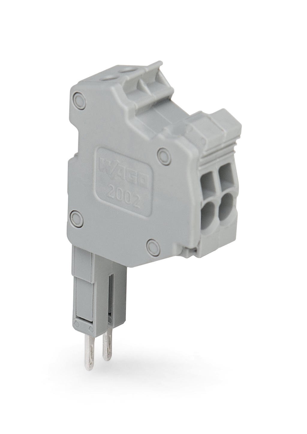

Соединительная планка TOPJOB S; для серии 2000; для гнезда перемычки; 2-полюсная; серая

| Connection technology | Push-in CAGE CLAMP® |
| Country of origin | DE |
| Fine-stranded conductor | 0.14 … 1.5 mm² / 24 … 16 AWG |
| Fine-stranded conductor with ferrule, push-in termination, from | 0.5 mm² / 20 AWG |
| GTIN | 4055143391016 |
| Insulating material | Polyamide 66 (PA 66) |
| Marking level | Center/side marking |
| Nominal cross section | 1 mm² |
| Number of Poles | 2 |
| Rated current | 13.5 A |
| Rated impulse voltage (III / 3) | 6 kV |
| Rated voltage (III / 3) | 500 В |
| Solid conductor | 0.14 … 1.5 mm² / 24 … 16 AWG |
| Solid conductor, push-in termination | 0.5 … 1.5 mm² / 20 … 16 AWG |
| Strip length | 9 … 11 mm / 0.35 … 0.43 Inch |
| Total number of connection points | 2 |
| Total number of potentials | 2 |
| Type of wiring | Side-entry wiring |
| Вес | 4.21 г |
| Ширина | 8.5 mm / 0.335 inch |
