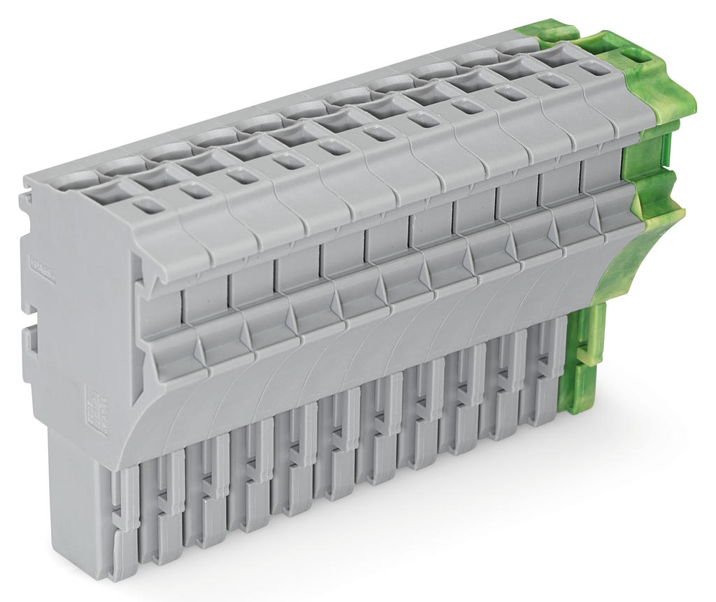

Модель2022-112/000-036
Datasheet Wago 2022-112/000-036
1-проводниковая розетка; 2,5 мм²; 12-пол.
Augswan
2022-112/000-036
Wago
Actuation typeOperating tool Push-in
Цветgray, green-yellow
Connectable conductor materialsCopper
Connection technologyPush-in CAGE CLAMP®
Connector connection typefor conductors
Contact type (pluggable connector)Female connector/socket
Country of originDE
Габариты: глубина22.4 mm / 0.882 inch
Fine-stranded conductor0.25 … 4 mm² / 22 … 12 AWG
Fine-stranded conductor with ferrule, push-in termination, from0.75 mm² / 18 AWG
Fire load0.643 MJ
GTIN4045454912901
Height40.5 mm / 1.594 inch
Insulating materialPolyamide 66 (PA 66)
Legend (ratings)(III / 3) ≙ Overvoltage category III / Pollution degree 3
Marking levelSide marking
Nominal cross section2.5 mm²
Number of Poles12
Product Group18 (X-COM-System)
Rated current24 A
Rated current (2)32 A
Rated impulse voltage (III / 3)6 kV
Rated voltage (III / 3)690 В
Solid conductor0.25 … 4 mm² / 22 … 12 AWG
Solid conductor, push-in termination0.75 … 4 mm² / 18 … 12 AWG
Strip length10 … 12 mm / 0.39 … 0.47 Inch
Total number of connection points12
Total number of potentials12
Type of wiringFront-entry wiring
Вес39.65 г
Ширина62.4 mm / 2.457 inch
