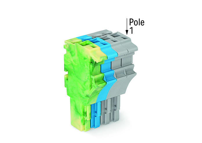

Datasheet Wago 2022-104/000-039/999-953 — Даташит
1-проводниковая розетка; 2,5 мм²; 4-пол.
1-CONDUCTOR FEMALE PLUG; 2.5 MM; | |||
2022-104/000-039 Wago | 1 612 ₽ | ||
2022-104/000-039 Wago | по запросу |
Actuation type | Operating tool Push-in |
Цвет | green-yellow/blue/gray |
Connectable conductor materials | Copper |
Connection technology | Push-in CAGE CLAMP® |
Connector connection type | for conductors |
Contact type (pluggable connector) | Female connector/socket |
Country of origin | DE |
Габариты: глубина | 22.4 mm / 0.882 inch |
Fine-stranded conductor | 0.25 … 4 mm² / 22 … 12 AWG |
Fine-stranded conductor with ferrule, push-in termination, from | 0.75 mm² / 18 AWG |
GTIN | 4055143534390 |
Height | 40.5 mm / 1.594 inch |
Marking level | Side marking |
Nominal cross section | 2.5 mm² |
Number of Poles | 4 |
Rated voltage EN (Ex e II) | 630 В |
Solid conductor | 0.25 … 4 mm² / 22 … 12 AWG |
Solid conductor, push-in termination | 0.75 … 4 mm² / 18 … 12 AWG |
Strip length | 10 … 12 mm / 0.39 … 0.47 Inch |
Total number of connection points | 4 |
Total number of potentials | 4 |
Type of wiring | Front-entry wiring |
Вес | 13.357 г |
Ширина | 20.8 mm / 0.819 inch |
