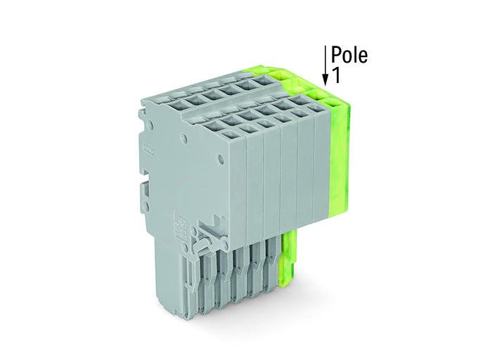

Datasheet Wago 2020-207/000-036 — Даташит
2-проводная розетка; 1,5; 7-пол.
| 2-CONDUCTOR FEMALE CONNECTOR; 1. | |||
| 2020-207 Wago | по запросу | ||
| Actuation type | Open Tool Slot |
| Цвет | gray, green-yellow |
| Connectable conductor materials | Copper |
| Connection technology | Push-in CAGE CLAMP® |
| Connector connection type | for conductors |
| Contact type (pluggable connector) | Female connector/socket |
| Country of origin | DE |
| Габариты: глубина | 25 mm / 0.984 inch |
| Fine-stranded conductor | 0.14 … 1.5 mm² / 24 … 16 AWG |
| Fine-stranded conductor with ferrule, push-in termination, from | 0.5 mm² / 20 AWG |
| Fire load | 0.324 MJ |
| GTIN | 4050821091387 |
| Height | 40.5 mm / 1.594 inch |
| Insulating material | Polyamide 66 (PA 66) |
| Legend (ratings) | (III / 3) ≙ Overvoltage category III / Pollution degree 3 |
| Marking level | Side marking |
| Nominal cross section | 1 mm² |
| Number of Poles | 7 |
| Product Group | 18 (X-COM-System) |
| Rated current | 13.5 A |
| Rated impulse voltage (III / 3) | 6 kV |
| Rated voltage (III / 3) | 500 В |
| Solid conductor | 0.14 … 1.5 mm² / 24 … 16 AWG |
| Solid conductor, push-in termination | 0.5 … 1.5 mm² / 20 … 16 AWG |
| Strip length | 9 … 11 mm / 0.35 … 0.43 Inch |
| Total number of connection points | 14 |
| Total number of potentials | 7 |
| Type of wiring | Front-entry wiring |
| Вес | 19.32 г |
| Ширина | 25.2 mm / 0.992 inch |
