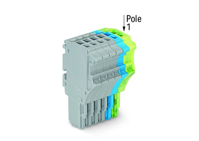

1-проводниковая розетка; 1,5; 6-пол.
Maybo
2020-106/000-038
Wago
Wago 2020-106/000-038
Actuation typeOpen Tool Slot
Цветgray, blue, green-yellow
Connectable conductor materialsCopper
Connection technologyPush-in CAGE CLAMP®
Connector connection typefor conductors
Contact type (pluggable connector)Female connector/socket
Country of originDE
Габариты: глубина22.4 mm / 0.882 inch
Fine-stranded conductor0.14 … 1.5 mm² / 24 … 16 AWG
Fine-stranded conductor with ferrule, push-in termination, from0.5 mm² / 20 AWG
Fire load0.251 MJ
GTIN4050821027232
Height40.5 mm / 1.594 inch
Insulating materialPolyamide 66 (PA 66)
Legend (ratings)(III / 3) ≙ Overvoltage category III / Pollution degree 3
Marking levelSide marking
Nominal cross section1 mm²
Number of Poles6
Product Group18 (X-COM-System)
Rated current13.5 A
Rated impulse voltage (III / 3)6 kV
Rated voltage (III / 3)500 В
Solid conductor0.14 … 1.5 mm² / 24 … 16 AWG
Solid conductor, push-in termination0.5 … 1.5 mm² / 20 … 16 AWG
Strip length9 … 11 mm / 0.35 … 0.43 Inch
Total number of connection points6
Total number of potentials6
Type of wiringFront-entry wiring
Вес13.89 г
Ширина21.7 mm / 0.854 inch
