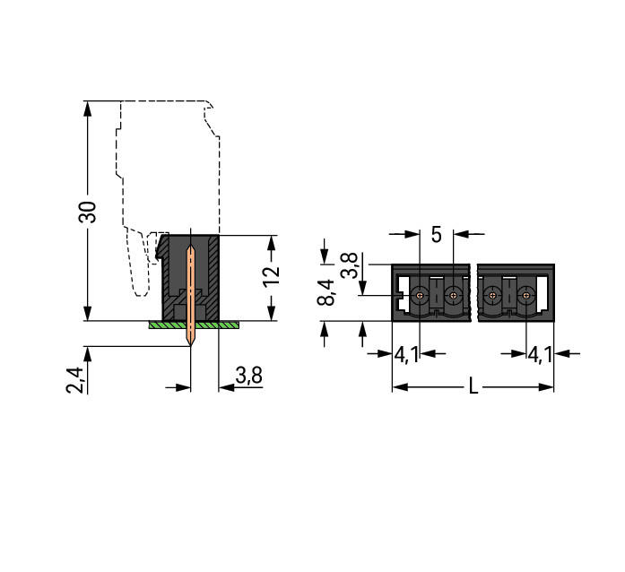

Вилка под пайку THR; 1.2 x 1.2 mm solder pin; прямые; упаковка в ленте на бобине; Шаг контактов 5 мм; 5-пол.
THR MALE HEADER; 1.2 X 1.2 MM SO | |||
231-165/001-000/105-604/997-407 Wago | по запросу |
Цвет | black |
Connector connection type | for PCBs |
Contact material | Electrolytic copper (Ecu) |
Contact plating | tin-plated |
Contact type (pluggable connector) | Male connector/plug |
Country of origin | DE |
Габариты: глубина | 8.4 mm / 0.331 inch |
Fire load | 0.044 MJ |
GTIN | 4050821003939 |
Height | 14.4 mm / 0.567 inch |
Height from the surface | 12 mm / 0.472 inch |
Insulating material | Polyphtalamide (PPA GF) |
Legend (ratings) | (III / 2) ≙ Overvoltage category III / Pollution degree 2 |
Limit temperature range | -60 … +100 °C |
Material group | I |
Mating direction to the PCB | 90 ° |
Mismating protection | No |
Number of Poles | 5 |
Number of levels | 1 |
Number of solder pins per potential | 1 |
PCB contact | THR |

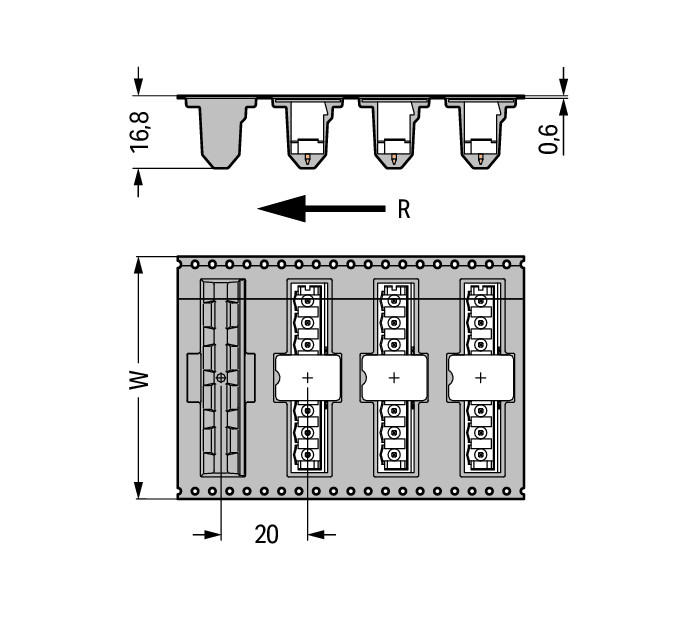

Packaging type | bag |
Pin spacing | 5 mm (0.197 inch) |
Plated through-hole diameter (THR) | 1.7 (+ 0.1) мм |
Rated current | 16 A |
Rated impulse voltage (II / 2) | 4 kV |
Rated impulse voltage (III / 2) | 4 kV |
Rated impulse voltage (III / 3) | 4 kV |
Rated voltage (II / 2) | 630 В |
Rated voltage (III / 2) | 320 В |
Rated voltage (III / 3) | 250 В |
Reel diameter of tape-and-reel packaging | 330 мм |
Solder pin arrangement | over the entire male connector, in line |
Solder pin dimensions | 1.2 x 1.2 mm |
Solder pin length | 2.4 мм |
Tape width | 56 мм |
Total number of potentials | 5 |
Вес | 1.725 г |
Ширина | 28.2 mm / 1.11 inch |
