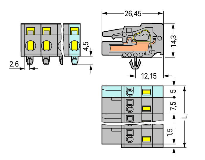

1-проводниковая розетка; Монтажные ножки; 2,5 мм²; Шаг контактов 7,5 мм; 9-пол.
Augswan
231-209/008-000
Wago
Wago 231-209/008-000
Actuation typeOperating tool
Clamping spring materialChrome nickel spring steel (CrNi)
Цветgray
Connection technologyCAGE CLAMP®
Connector connection typefor conductors
Contact materialCopper alloy
Contact platingtin-plated
Contact type (pluggable connector)Female connector/socket
Country of originDE
Габариты: глубина26.45 mm / 1.041 inch
Fine-stranded conductor0.08 … 2.5 mm² / 28 … 12 AWG
Fine-stranded conductor with ferrule with plastic collar0.25 … 1.5 mm²
Fine-stranded conductor with ferrule without plastic collar0.25 … 2.5 mm²
Fire load0.312 MJ
Flammability class per UL94V0
GTIN4044918374903
Gehäuseblechstärke0.6 … 1.2 mm / 0.024 … 0.047 inch
Height18.8 mm / 0.74 inch
Height from the surface14.3 mm / 0.563 inch
Insulating materialPolyamide 66 (PA 66)
Legend (ratings)(III / 2) ≙ Overvoltage category III / Pollution degree 2
Limit temperature range-60 … +85 °C
Material groupI
Mismating protectionNo
Mounting typeSnap-in mounting foot
Number of Poles9
Number of connection types1
Number of levels1
Pin spacing7.5 mm (0.295 inch)
Product Group3 (Multi Conn. System)
Rated current16 A
Rated impulse voltage (II / 2)6 kV
Rated impulse voltage (III / 2)6 kV
Rated impulse voltage (III / 3)6 kV
Rated voltage (II / 2)1000 В
Rated voltage (III / 2)630 В
Rated voltage (III / 3)500 В
Solid conductor0.08 … 2.5 mm² / 28 … 12 AWG
Strip length8 … 9 mm / 0.31 … 0.35 Inch
Total number of connection points9
Total number of potentials9
Type of mountingPanel mounting
Вес18.917 г
Ширина66.5 mm / 2.618 inch
