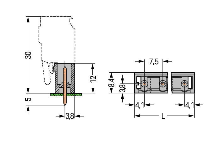

Вилка THT; 1.0 x 1.0 mm solder pin; прямые; Шаг контактов 7,5 мм; 5-пол.

Габариты: глубина | 8.4 mm / 0.331 inch |
Drilled hole diameter (tolerance) | 1.4(+ 0.1) мм |
Fire load | 0.042 MJ |
GTIN | 4044918864633 |
Height | 17 mm / 0.669 inch |
Height from the surface | 12 mm / 0.472 inch |
Legend (ratings) | (III / 2) ≙ Overvoltage category III / Pollution degree 2 |
Limit temperature range | -60 … +100 °C |
Material group | I |
Mating direction to the PCB | 90 ° |
Mismating protection | No |
Number of Poles | 5 |
Number of levels | 1 |
Number of solder pins per potential | 1 |
PCB contact | THT |
Pin spacing | 7.5 mm (0.295 inch) |
Product Group | 3 (Multi Conn. System) |
Rated current | 12 A |
Rated impulse voltage (II / 2) | 6 kV |
Rated impulse voltage (III / 2) | 6 kV |
Rated impulse voltage (III / 3) | 6 kV |
Rated voltage (II / 2) | 1000 В |
Rated voltage (III / 2) | 630 В |
Rated voltage (III / 3) | 500 В |
Solder pin arrangement | over the entire male connector, in line |
Solder pin dimensions | 1 x 1 mm |
Solder pin length | 5 мм |
Total number of potentials | 5 |
Вес | 2.03 г |
Ширина | 38.2 mm / 1.504 inch |
