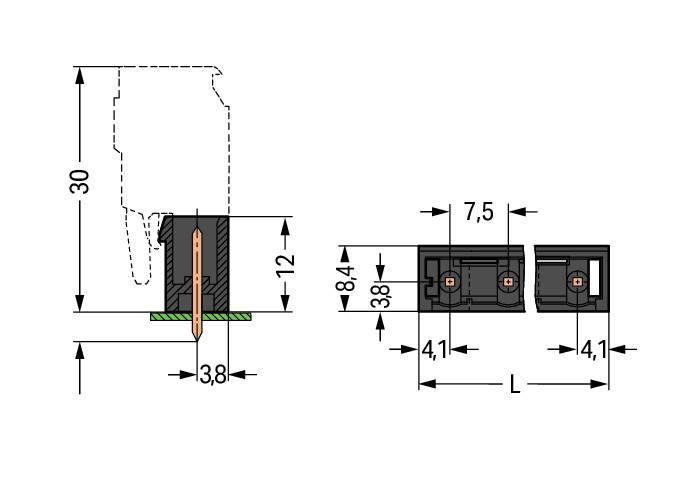

Вилка под пайку THR; 1.2 x 1.2 mm solder pin; прямые; упаковка в ленте на бобине; Шаг контактов 7,5 мм; 5-пол.
THR MALE HEADER; 1.2 X 1.2 MM SO | |||
| 231-265/001-000/105-604/997-407 Wago | по запросу | ||
| Цвет | black |
| Connector connection type | for PCBs |
| Contact material | Electrolytic copper (Ecu) |
| Contact plating | tin-plated |
| Contact type (pluggable connector) | Male connector/plug |
| Country of origin | DE |
| Габариты: глубина | 8.4 mm / 0.331 inch |
| Fire load | 0.056 MJ |
| Flammability class per UL94 | V0 |
| GTIN | 4050821004172 |
| Height | 14.4 mm / 0.567 inch |
| Height from the surface | 12 mm / 0.472 inch |
| Insulating material | Polyphtalamide (PPA GF) |
| Legend (ratings) | (III / 2) ≙ Overvoltage category III / Pollution degree 2 |
| Limit temperature range | -60 … +100 °C |
| Material group | I |
| Mating direction to the PCB | 90 ° |
| Mismating protection | No |
| Number of Poles | 5 |
| Number of levels | 1 |
| Number of solder pins per potential | 1 |
| PCB contact | THR |
| Packaging type | bag |
| Pin spacing | 7.5 mm (0.295 inch) |
| Plated through-hole diameter (THR) | 1.7 (+ 0.1) мм |
| Rated current | 16 A |
| Rated impulse voltage (II / 2) | 6 kV |
| Rated impulse voltage (III / 2) | 6 kV |
| Rated impulse voltage (III / 3) | 6 kV |
| Rated voltage (II / 2) | 1000 В |
| Rated voltage (III / 2) | 630 В |
| Rated voltage (III / 3) | 500 В |

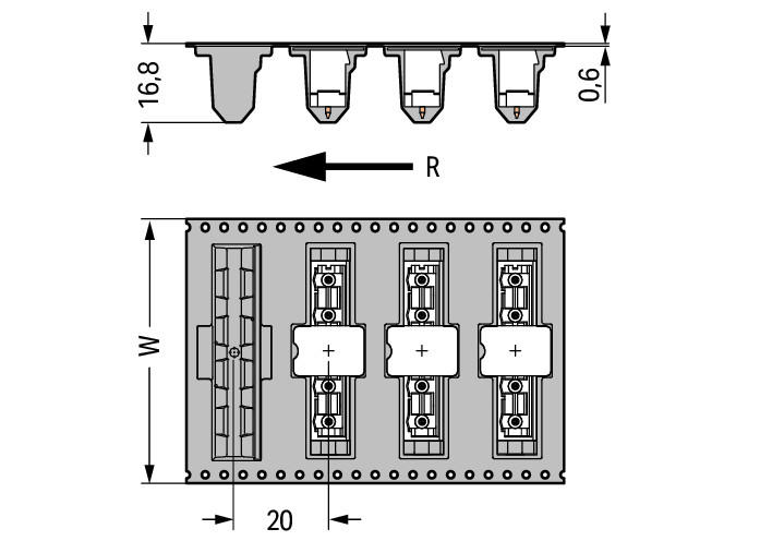

| Reel diameter of tape-and-reel packaging | 330 мм |
| Solder pin arrangement | over the entire male connector, in line |
| Solder pin dimensions | 1.2 x 1.2 mm |
| Solder pin length | 2.4 мм |
| Tape width | 56 мм |
| Total number of potentials | 5 |
| Вес | 2.125 г |
| Ширина | 38.2 mm / 1.504 inch |
