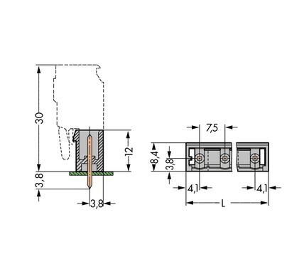

Вилка THT; 1.2 x 1.2 mm solder pin; прямые; Шаг контактов 7,5 мм; 10-пол.
231-270/046-000 Wago | по запросу |
Цвет | gray |
Connector connection type | for PCBs |
Contact material | Electrolytic copper (Ecu) |
Contact plating | tin-plated |
Contact type (pluggable connector) | Male connector/plug |
Country of origin | DE |
Габариты: глубина | 8.4 mm / 0.331 inch |
Drilled hole diameter (tolerance) | 1.7(+ 0.1) мм |
Fire load | 0.08 MJ |
GTIN | 4044918899574 |
Height | 15.8 mm / 0.662 inch |
Height from the surface | 12 mm / 0.472 inch |
Legend (ratings) | (III / 2) ≙ Overvoltage category III / Pollution degree 2 |
Limit temperature range | -60 … +100 °C |
Material group | I |
Mating direction to the PCB | 90 ° |
Mismating protection | No |
Number of Poles | 10 |
Number of levels | 1 |
Number of solder pins per potential | 1 |
PCB contact | THT |
Pin spacing | 7.5 mm (0.295 inch) |
Product Group | 3 (Multi Conn. System) |
Rated current | 16 A |
Rated impulse voltage (II / 2) | 6 kV |
Rated impulse voltage (III / 2) | 6 kV |
Rated impulse voltage (III / 3) | 6 kV |
Rated voltage (II / 2) | 1000 В |
Rated voltage (III / 2) | 630 В |
Rated voltage (III / 3) | 500 В |
Solder pin arrangement | over the entire male connector, in line |
Solder pin dimensions | 1.2 x 1.2 mm |
Solder pin length | 3.8 мм |
Total number of potentials | 10 |
Вес | 4.5 г |
Ширина | 75.7 mm / 2.98 inch |
