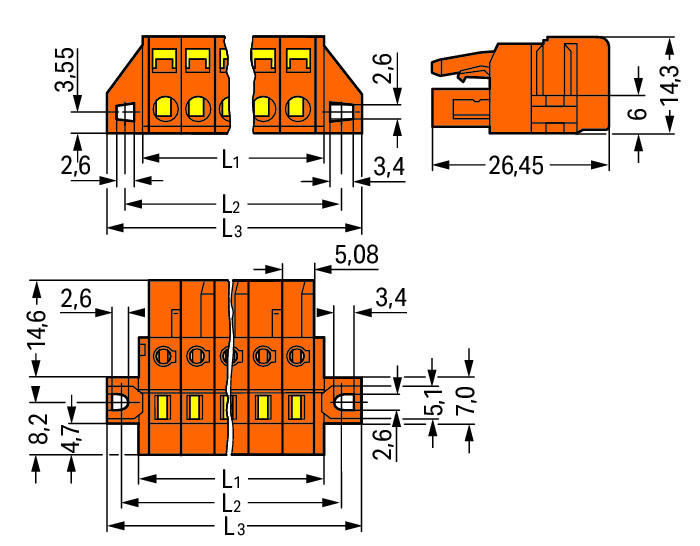

1-проводниковая розетка; зажимное кольцо; 2,5 мм²; Шаг контактов 5,08 мм; 20-пол.
1-CONDUCTOR FEMALE PLUG; CLAMPIN | |||
231-320/031-000 Wago | 5 197 ₽ | ||
231-320/031-000 Wago | по запросу |
Actuation type | Operating tool |
Clamping spring material | Chrome nickel spring steel (CrNi) |
Цвет | orange |
Connection technology | CAGE CLAMP® |
Connector connection type | for conductors |
Contact material | Copper alloy |
Contact plating | tin-plated |
Contact type (pluggable connector) | Female connector/socket |
Country of origin | DE |
Габариты: глубина | 26.45 mm / 1.041 inch |
Fine-stranded conductor | 0.08 … 2.5 mm² / 28 … 12 AWG |
Fine-stranded conductor with ferrule with plastic collar | 0.25 … 1.5 mm² |
Fine-stranded conductor with ferrule without plastic collar | 0.25 … 2.5 mm² |
Fire load | 0.53 MJ |
GTIN | 4044918350112 |
Height | 14.3 mm / 0.563 inch |
Legend (ratings) | (III / 2) ≙ Overvoltage category III / Pollution degree 2 |
Limit temperature range | -60 … +85 °C |
Material group | I |
Mismating protection | No |
Mounting type | Mounting flange |
Number of Poles | 20 |
Number of connection types | 1 |
Number of levels | 1 |
Pin spacing | 5.08 mm (0.2 inch) |
Product Group | 3 (Multi Conn. System) |
Rated current | 16 A |
Rated impulse voltage (II / 2) | 4 kV |
Rated impulse voltage (III / 2) | 4 kV |
Rated impulse voltage (III / 3) | 4 kV |
Rated voltage (II / 2) | 630 В |
Rated voltage (III / 2) | 320 В |
Rated voltage (III / 3) | 320 В |
Solid conductor | 0.08 … 2.5 mm² / 28 … 12 AWG |
Strip length | 8 … 9 mm / 0.31 … 0.35 Inch |
Total number of connection points | 20 |
Total number of potentials | 20 |
Type of mounting | Feed-through mounting Panel mounting |
Вес | 36.94 г |
Ширина | 116.4 mm / 4.583 inch |
