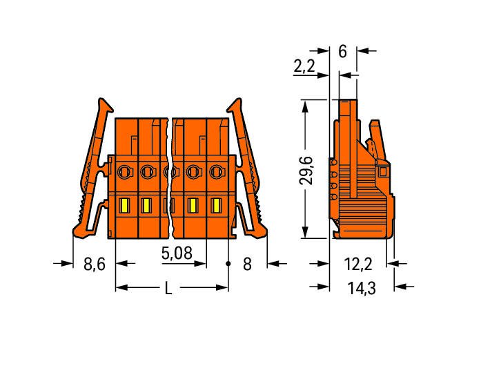

1-проводниковая розетка; Фиксирующий рычаг; 2,5 мм²; Шаг контактов 5,08 мм; 20-пол.
231-320/037-000, 20-контакт. розетка, шаг 5,08 мм, бок. защелки, оранжевая
231-320/037-000
Wago
Оф. дистрибьютор
2 115 ₽
Augswan
231-320/037-000
Wago
Wago 231-320/037-000
Actuation typeOperating tool
Clamping spring materialChrome nickel spring steel (CrNi)
Цветorange
Connection technologyCAGE CLAMP®
Connector connection typefor conductors
Contact materialCopper alloy
Contact platingtin-plated
Contact type (pluggable connector)Female connector/socket
Country of originDE
Габариты: глубина29.6 mm / 1.165 inch
Fine-stranded conductor0.08 … 2.5 mm² / 28 … 12 AWG
Fine-stranded conductor with ferrule with plastic collar0.25 … 1.5 mm²
Fine-stranded conductor with ferrule without plastic collar0.25 … 2.5 mm²
Fire load0.551 MJ
Flammability class per UL94V0
GTIN4044918350136
Height14.3 mm / 0.563 inch
Insulating materialPolyamide 66 (PA 66)
Legend (ratings)(III / 2) ≙ Overvoltage category III / Pollution degree 2
Limit temperature range-60 … +85 °C
Locking of plug-in connectionlocking lever
Material groupI
Mismating protectionNo
Number of Poles20
Number of connection types1
Number of levels1
Pin spacing5.08 mm (0.2 inch)
Product Group3 (Multi Conn. System)
Rated current16 A
Rated impulse voltage (II / 2)4 kV
Rated impulse voltage (III / 2)4 kV
Rated impulse voltage (III / 3)4 kV
Rated voltage (II / 2)630 В
Rated voltage (III / 2)320 В
Rated voltage (III / 3)320 В
Solid conductor0.08 … 2.5 mm² / 28 … 12 AWG
Strip length8 … 9 mm / 0.31 … 0.35 Inch
Total number of connection points20
Total number of potentials20
Вес37.64 г
Ширина118.2 mm / 4.654 inch
