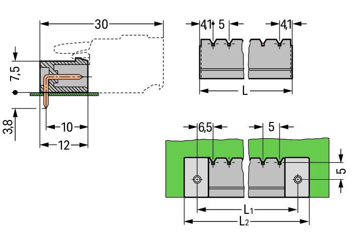

Вилка THT; 1.0 x 1.0 mm solder pin; угловые; Шаг контактов 5 мм; 3-пол.

Габариты: глубина | 12 mm / 0.472 inch |
Drilled hole diameter (tolerance) | 1.4(+ 0.1) мм |
Fire load | 0.021 MJ |
GTIN | 4044918866095 |
Height | 12.2 mm / 0.48 inch |
Height from the surface | 8.4 mm / 0.331 inch |
Legend (ratings) | (III / 2) ≙ Overvoltage category III / Pollution degree 2 |
Limit temperature range | -60 … +100 °C |
Material group | I |
Mismating protection | No |
Number of Poles | 3 |
Number of levels | 1 |
Number of solder pins per potential | 1 |
PCB contact | THT |
Pin spacing | 5 mm (0.197 inch) |
Product Group | 3 (Multi Conn. System) |
Rated current | 12 A |
Rated impulse voltage (II / 2) | 4 kV |
Rated impulse voltage (III / 2) | 4 kV |
Rated impulse voltage (III / 3) | 4 kV |
Rated voltage (II / 2) | 630 В |
Rated voltage (III / 2) | 320 В |
Rated voltage (III / 3) | 320 В |
Solder pin arrangement | over the entire male connector, in line |
Solder pin dimensions | 1 x 1 mm |
Solder pin length | 3.8 мм |
Total number of potentials | 3 |
Вес | 1.084 г |
Ширина | 18.2 mm / 0.717 inch |
