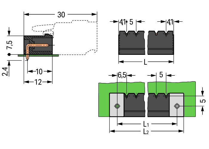

Вилка под пайку THR; 1.0 x 1.0 mm solder pin; угловые; упаковка в ленте на бобине; Шаг контактов 5 мм; 3-пол.
Augswan
231-433/001-000/105-604/997-405
Wago
Wago 231-433/001-000/105-604/997-405 Wago 231-433/001-000/105-604/997-405
Цветblack
Connector connection typefor PCBs
Contact materialElectrolytic copper (Ecu)
Contact platingtin-plated
Contact type (pluggable connector)Male connector/plug
Country of originDE
Габариты: глубина12 mm / 0.472 inch
Fire load0.027 MJ
Flammability class per UL94V0
GTIN4044918936491
Height10.8 mm / 0.425 inch
Height from the surface8.4 mm / 0.331 inch
Insulating materialPolyphtalamide (PPA GF)
Legend (ratings)(III / 2) ≙ Overvoltage category III / Pollution degree 2
Limit temperature range-60 … +100 °C
Material groupI
Mismating protectionNo
Number of Poles3
Number of levels1
Number of solder pins per potential1
PCB contactTHR

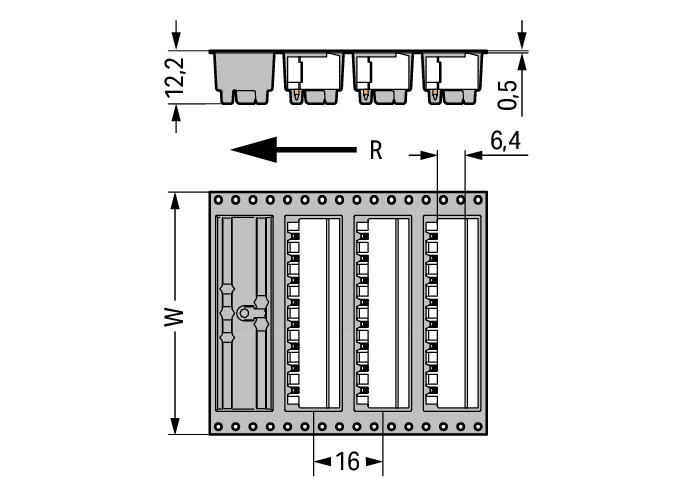

Packaging typebag
Pin spacing5 mm (0.197 inch)
Plated through-hole diameter (THR)1.4 (+ 0.1) мм
Rated current12 A
Rated impulse voltage (II / 2)4 kV
Rated impulse voltage (III / 2)4 kV
Rated impulse voltage (III / 3)4 kV
Rated voltage (II / 2)630 В
Rated voltage (III / 2)320 В
Rated voltage (III / 3)320 В
Reel diameter of tape-and-reel packaging330 мм
Solder pin arrangementover the entire male connector, in line
Solder pin dimensions1 x 1 mm
Solder pin length2.4 мм
Tape width32 мм
Total number of potentials3
Вес1.3 г
Ширина18.2 mm / 0.717 inch
