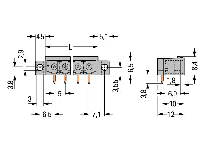

Datasheet Wago 231-436/040-000 — Даташит
Вилка THT; 1.0 x 1.0 mm solder pin; угловые; зажимное кольцо; Шаг контактов 5 мм; 6-пол.
| THT MALE HEADER; 1.0 X 1.0 MM SO | |||
| 231-436/040-000 Wago | по запросу | ||
| Цвет | gray |
| Connector connection type | for PCBs |
| Contact material | Electrolytic copper (Ecu) |
| Contact plating | tin-plated |
| Contact type (pluggable connector) | Male connector/plug |
| Country of origin | DE |
| Габариты: глубина | 12 mm / 0.472 inch |
| Drilled hole diameter (tolerance) | 1.4(+ 0.1) мм |
| Fire load | 0.046 MJ |
| Flammability class per UL94 | V0 |
| GTIN | 4044918866217 |
| Height | 12.2 mm / 0.48 inch |
| Height from the surface | 8.4 mm / 0.331 inch |
| Insulating material | Polyamide 66 (PA 66) |
| Legend (ratings) | (III / 2) ≙ Overvoltage category III / Pollution degree 2 |
| Limit temperature range | -60 … +100 °C |
| Material group | I |
| Mismating protection | No |
| Mounting type | Mounting flange |
| Number of Poles | 6 |
| Number of levels | 1 |
| Number of solder pins per potential | 1 |
| PCB contact | THT |
| Pin spacing | 5 mm (0.197 inch) |
| Product Group | 3 (Multi Conn. System) |
| Rated current | 12 A |
| Rated impulse voltage (II / 2) | 4 kV |
| Rated impulse voltage (III / 2) | 4 kV |
| Rated impulse voltage (III / 3) | 4 kV |
| Rated voltage (II / 2) | 630 В |
| Rated voltage (III / 2) | 320 В |
| Rated voltage (III / 3) | 320 В |
| Solder pin arrangement | over the entire male connector, in line |
| Solder pin dimensions | 1 x 1 mm |
| Solder pin length | 3.8 мм |
| Total number of potentials | 6 |
| Type of mounting | Feed-through mounting Panel mounting |
| Вес | 2.298 г |
| Ширина | 42.8 mm / 1.685 inch |
