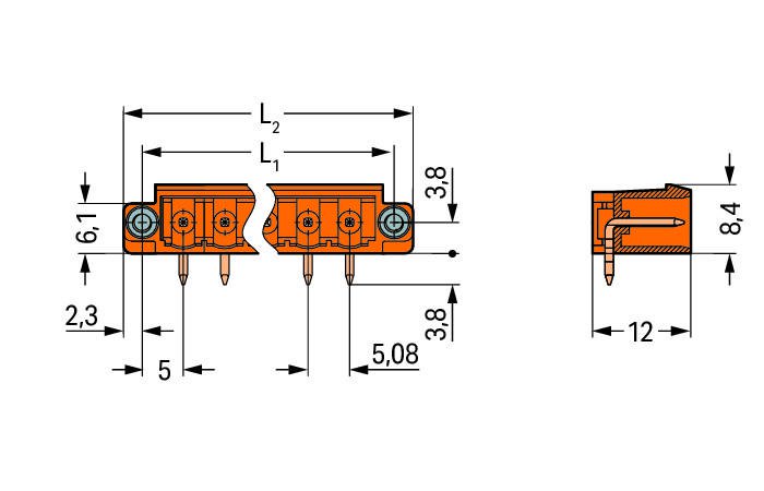

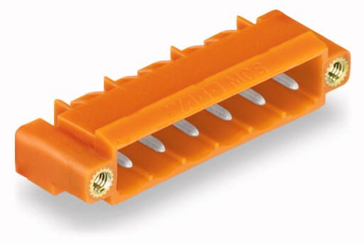

Вилка THT; 1.0 x 1.0 mm solder pin; угловые; Резьбовой фланец; Шаг контактов 5,08 мм; 2-пол.
THT MALE HEADER; 1.0 X 1.0 MM SO | |||
231-532/108-000 Wago | 241 ₽ | ||
231-532/108-000 Wago | по запросу |
Цвет | orange |
Connector connection type | for PCBs |
Contact material | Electrolytic copper (Ecu) |
Contact plating | tin-plated |
Contact type (pluggable connector) | Male connector/plug |
Country of origin | DE |
Габариты: глубина | 12 mm / 0.472 inch |
Drilled hole diameter (tolerance) | 1.4(+ 0.1) мм |
Fire load | 0.026 MJ |
GTIN | 4044918866798 |
Height | 12.2 mm / 0.48 inch |
Height from the surface | 8.4 mm / 0.331 inch |
Legend (ratings) | (III / 2) ≙ Overvoltage category III / Pollution degree 2 |
Limit temperature range | -60 … +100 °C |
Locking of plug-in connection | Threaded flange |
Material group | I |
Mismating protection | No |
Number of Poles | 2 |
Number of levels | 1 |
Number of solder pins per potential | 1 |
PCB contact | THT |
Pin spacing | 5.08 mm (0.2 inch) |
Product Group | 3 (Multi Conn. System) |
Rated current | 12 A |
Rated impulse voltage (II / 2) | 4 kV |
Rated impulse voltage (III / 2) | 4 kV |
Rated impulse voltage (III / 3) | 4 kV |
Rated voltage (II / 2) | 630 В |
Rated voltage (III / 2) | 320 В |
Rated voltage (III / 3) | 320 В |
Solder pin arrangement | over the entire male connector, in line |
Solder pin dimensions | 1 x 1 mm |
Solder pin length | 3.8 мм |
Total number of potentials | 2 |
Вес | 1.476 г |
Ширина | 20.16 mm / 0.794 inch |
