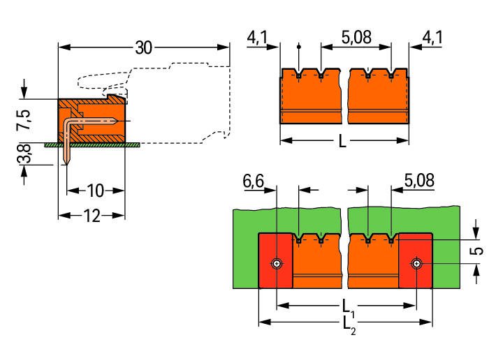

Вилка THT; 1.0 x 1.0 mm solder pin; угловые; Шаг контактов 5,08 мм; 24-пол.

| Габариты: глубина | 12 mm / 0.472 inch |
| Drilled hole diameter (tolerance) | 1.4(+ 0.1) мм |
| Fire load | 0.133 MJ |
| Flammability class per UL94 | V0 |
| GTIN | 4044918867702 |
| Height | 12.2 mm / 0.48 inch |
| Height from the surface | 8.4 mm / 0.331 inch |
| Insulating material | Polyamide 66 (PA 66) |
| Legend (ratings) | (III / 2) ≙ Overvoltage category III / Pollution degree 2 |
| Limit temperature range | -60 … +100 °C |
| Material group | I |
| Mismating protection | No |
| Number of Poles | 24 |
| Number of levels | 1 |
| Number of solder pins per potential | 1 |
| PCB contact | THT |
| Pin spacing | 5.08 mm (0.2 inch) |
| Product Group | 3 (Multi Conn. System) |
| Rated current | 12 A |
| Rated impulse voltage (II / 2) | 4 kV |
| Rated impulse voltage (III / 2) | 4 kV |
| Rated impulse voltage (III / 3) | 4 kV |
| Rated voltage (II / 2) | 630 В |
| Rated voltage (III / 2) | 320 В |
| Rated voltage (III / 3) | 320 В |
| Solder pin arrangement | over the entire male connector, in line |
| Solder pin dimensions | 1 x 1 mm |
| Solder pin length | 3.8 мм |
| Total number of potentials | 24 |
| Вес | 7.85 г |
| Ширина | 125.04 mm / 4.923 inch |
