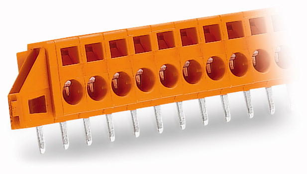

Клеммная колодка для сквозного монтажа на печатную плату; угловой вывод под пайку 1x1,2 мм; 2-полюсный; с крепежными фланцами; шаг выводов 5,08 мм / 0,2 дюйма; для скрытого монтажа; оранжевый
| PCB TERMINAL BLOCK; 2.5 MM; PIN | |||
| 231-632/023-000 Wago | по запросу | ||
| Actuation type | Operating tool |
| Clamping spring material | Chrome nickel spring steel (CrNi) |
| Цвет | orange |
| Connection technology | CAGE CLAMP® |
| Contact material | Electrolytic copper (Ecu) |
| Contact plating | tin-plated |
| Country of origin | DE |
| Габариты: глубина | 19.1 mm / 0.752 inch |
| Drilled hole diameter (tolerance) | 1.8(+ 0.1) мм |
| Fine-stranded conductor | 0.08 … 2.5 mm² / 28 … 14 AWG |
| Fine-stranded conductor with ferrule with plastic collar | 0.25 … 1.5 mm² |
| Fine-stranded conductor with ferrule without plastic collar | 0.25 … 2.5 mm² |
| Fire load | 0.072 MJ |
| Flammability class per UL94 | V0 |
| GTIN | 4044918282901 |
| Gehäuseblechstärke | 1.5 … 1.5 mm / 0.059 … 0.059 inch |
| Height | 19 mm / 0.748 inch |
| Height from the surface | 14.3 mm / 0.563 inch |
| Insulating material | Polyamide 66 (PA 66) |
| Legend (ratings) | (III / 2) ≙ Overvoltage category III / Pollution degree 2 |
| Limit temperature range | -60 … +105 °C |
| Material group | I |
| Mounting type | Mounting flange |
| Number of Poles | 2 |
| Number of connection types | 1 |
| Number of levels | 1 |
| Number of solder pins per potential | 1 |
| PCB contact | THT |
| Pin spacing | 5.08 mm (0.2 inch) |
| Product Group | 3 (Multi Conn. System) |
| Rated current | 16 A |
| Rated impulse voltage (II / 2) | 4 kV |
| Rated impulse voltage (III / 2) | 4 kV |
| Rated impulse voltage (III / 3) | 4 kV |
| Rated voltage (II / 2) | 630 В |
| Rated voltage (III / 2) | 320 В |
| Rated voltage (III / 3) | 320 В |
| Solder pin arrangement | over the entire terminal strip, in line |
| Solder pin dimensions | 0.8 x 1.3 mm |
| Solder pin length | 4.7 мм |
| Solid conductor | 0.08 … 2.5 mm² / 28 … 14 AWG |
| Strip length | 8 … 9 mm / 0.31 … 0.35 Inch |
| Total number of connection points | 2 |
| Total number of potentials | 2 |
| Type of mounting | Feed-through mounting Panel mounting |
| Вес | 3.744 г |
| Ширина | 25.36 mm / 0.998 inch |
