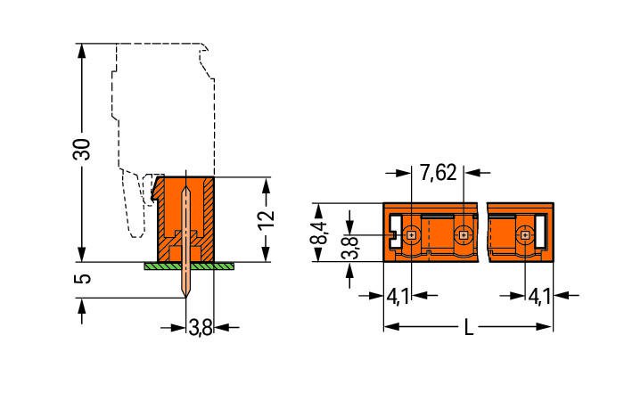

Вилка THT; 1.2 x 1.2 mm solder pin; прямые; Шаг контактов 7,62 мм; 6-пол.
Augswan
231-766/001-000
Wago
Wago 231-766/001-000
Цветorange
Connector connection typefor PCBs
Contact materialElectrolytic copper (Ecu)
Contact platingtin-plated
Contact type (pluggable connector)Male connector/plug
Country of originDE
Габариты: глубина8.4 mm / 0.331 inch
Drilled hole diameter (tolerance)1.7(+ 0.1) мм
Fire load0.05 MJ
Flammability class per UL94V0
GTIN4044918931830
Height17 mm / 0.669 inch
Height from the surface12 mm / 0.472 inch
Insulating materialPolyamide 66 (PA 66)
Legend (ratings)(III / 2) ≙ Overvoltage category III / Pollution degree 2
Limit temperature range-60 … +100 °C
Material groupI
Mating direction to the PCB90 °
Mismating protectionNo
Number of Poles6
Number of levels1
Number of solder pins per potential1
PCB contactTHT
Pin spacing7.62 mm (0.3 inch)
Product Group3 (Multi Conn. System)
Rated current16 A
Rated impulse voltage (II / 2)6 kV
Rated impulse voltage (III / 2)6 kV
Rated impulse voltage (III / 3)6 kV
Rated voltage (II / 2)1000 В
Rated voltage (III / 2)630 В
Rated voltage (III / 3)500 В
Solder pin arrangementover the entire male connector, in line
Solder pin dimensions1.2 x 1.2 mm
Solder pin length5 мм
Total number of potentials6
Вес2.8 г
Ширина46.3 mm / 1.823 inch
