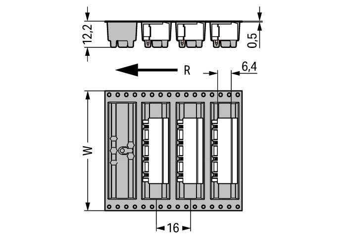

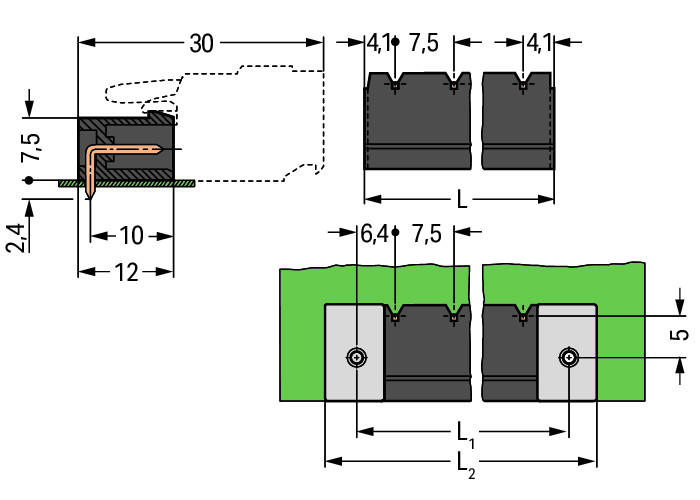

Вилка под пайку THR; 1.0 x 1.0 mm solder pin; угловые; упаковка в ленте на бобине; Шаг контактов 7,5 мм; 5-пол.
THR MALE HEADER; 1.0 X 1.0 MM SO | |||
231-835/001-000/105-604/997-407 Wago | по запросу |
Цвет | black |
Connector connection type | for PCBs |
Contact material | Electrolytic copper (Ecu) |
Contact plating | tin-plated |
Contact type (pluggable connector) | Male connector/plug |
Country of origin | DE |
Габариты: глубина | 12 mm / 0.472 inch |
Fire load | 0.05 MJ |
GTIN | 4050821043157 |
Height | 10.8 mm / 0.425 inch |
Height from the surface | 8.4 mm / 0.331 inch |
Insulating material | Polyphtalamide (PPA GF) |
Legend (ratings) | (III / 2) ≙ Overvoltage category III / Pollution degree 2 |
Limit temperature range | -60 … +100 °C |
Material group | I |
Mismating protection | No |
Number of Poles | 5 |
Number of levels | 1 |
Number of solder pins per potential | 1 |
PCB contact | THR |
Packaging type | bag |
Pin spacing | 7.5 mm (0.295 inch) |
Plated through-hole diameter (THR) | 1.4 (+ 0.1) мм |
Rated current | 12 A |
Rated impulse voltage (II / 2) | 6 kV |
Rated impulse voltage (III / 2) | 6 kV |
Rated impulse voltage (III / 3) | 6 kV |
Rated voltage (II / 2) | 1000 В |
Rated voltage (III / 2) | 630 В |
Rated voltage (III / 3) | 500 В |
Reel diameter of tape-and-reel packaging | 330 мм |
Solder pin arrangement | over the entire male connector, in line |
Solder pin dimensions | 1 x 1 mm |
Solder pin length | 2.4 мм |
Tape width | 56 мм |
Total number of potentials | 5 |
Вес | 2.3 г |
Ширина | 38.2 mm / 1.504 inch |
