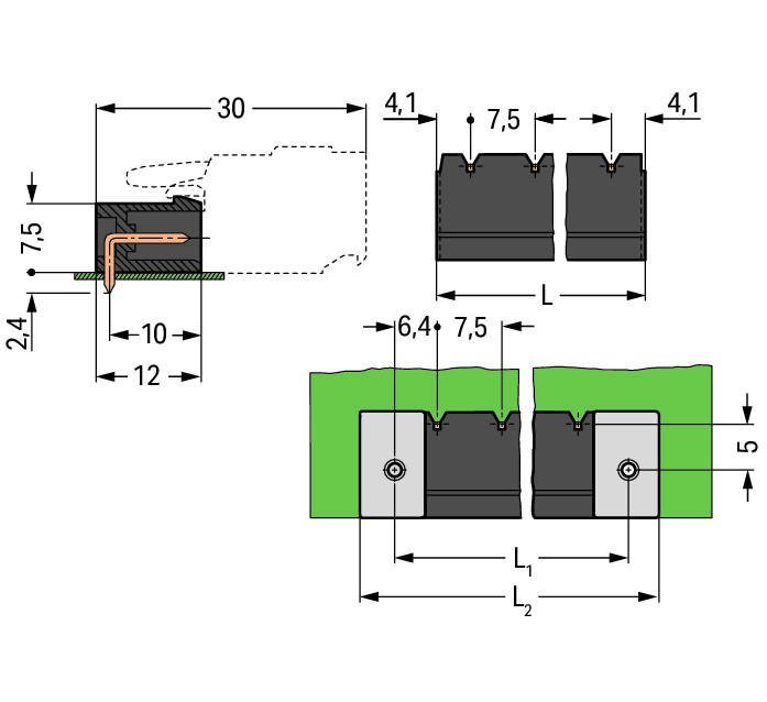

Габариты: глубина12 mm / 0.472 inch
Flammability class per UL94V0
GTIN4050821043249
Height10.8 mm / 0.425 inch
Height from the surface8.4 mm / 0.331 inch

Pin spacing7.5 mm (0.295 inch)

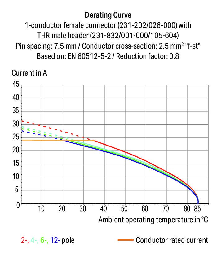

Plated through-hole diameter (THR)1.7 (+ 0.1) мм
Rated current16 A
Rated impulse voltage (II / 2)6 kV
Rated impulse voltage (III / 2)6 kV
Rated impulse voltage (III / 3)6 kV
Rated voltage (II / 2)1000 В
Rated voltage (III / 2)630 В
Rated voltage (III / 3)500 В

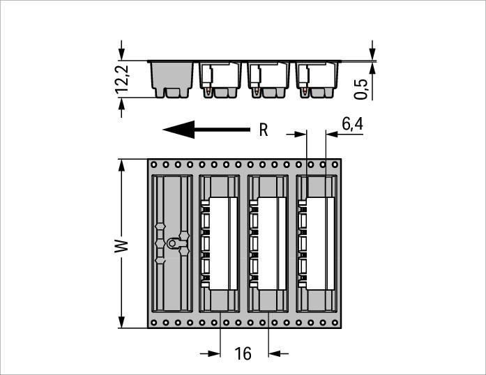

Reel diameter of tape-and-reel packaging330 мм
Solder pin arrangementover the entire male connector, in line
Solder pin dimensions1.2 x 1.2 mm
Solder pin length2.4 мм
Tape width56 мм
