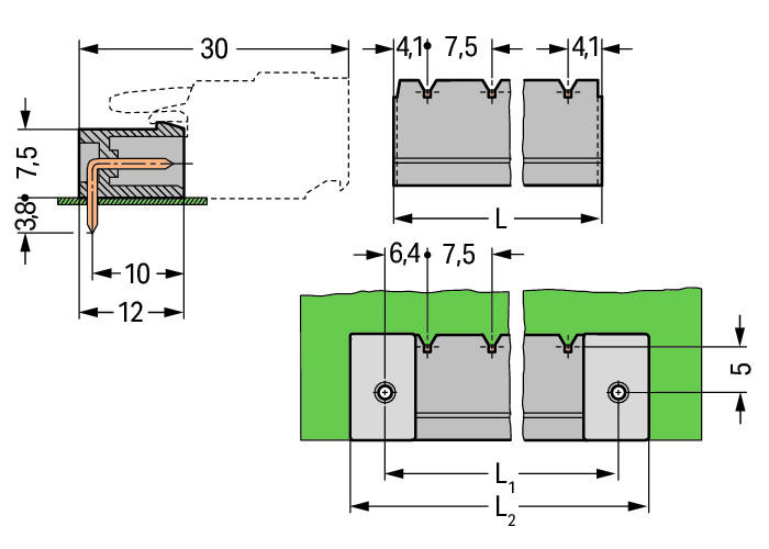

Вилка THT; 1.2 x 1.2 mm solder pin; угловые; Шаг контактов 7,5 мм; 5-пол.
Augswan
231-865/001-000
Wago
Maybo
231-865/001-000/105-604
Wago
Wago 231-865/001-000
Цветgray
Connector connection typefor PCBs
Contact materialElectrolytic copper (Ecu)
Contact platingtin-plated
Contact type (pluggable connector)Male connector/plug
Country of originDE
Габариты: глубина12 mm / 0.472 inch
Drilled hole diameter (tolerance)1.7(+ 0.1) мм
Fire load0.042 MJ
Flammability class per UL94V0
GTIN4044918932134
Height12.2 mm / 0.48 inch
Height from the surface8.4 mm / 0.331 inch
Insulating materialPolyamide 66 (PA 66)
Legend (ratings)(III / 2) ≙ Overvoltage category III / Pollution degree 2
Limit temperature range-60 … +100 °C
Material groupI
Mismating protectionNo
Number of Poles5
Number of levels1
Number of solder pins per potential1
PCB contactTHT
Pin spacing7.5 mm (0.295 inch)
Product Group3 (Multi Conn. System)
Rated current16 A
Rated impulse voltage (II / 2)6 kV
Rated impulse voltage (III / 2)6 kV
Rated impulse voltage (III / 3)6 kV
Rated voltage (II / 2)1000 В
Rated voltage (III / 2)630 В
Rated voltage (III / 3)500 В
Solder pin arrangementover the entire male connector, in line
Solder pin dimensions1.2 x 1.2 mm
Solder pin length3.8 мм
Total number of potentials5
Вес2.3 г
Ширина38.2 mm / 1.504 inch
