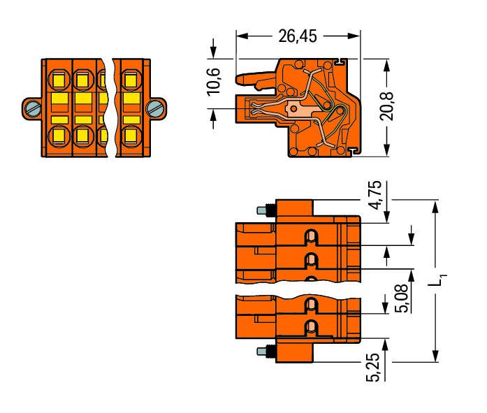

2-проводная розетка; Винтовой фланец; 2,5 мм²; Шаг контактов 5,08 мм; 15-пол.
Augswan
231-2315/026-000
Wago
Wago 231-2315/107-000 Wago 231-2315/107-000
Actuation typeOperating tool
Clamping spring materialChrome nickel spring steel (CrNi)
Цветorange
Connection technologyPush-in CAGE CLAMP®
Connector connection typefor conductors
Contact materialCopper alloy
Contact platingtin-plated
Contact type (pluggable connector)Female connector/socket
Country of originPL
Габариты: глубина26.45 mm / 1.041 inch
Fine-stranded conductor0.2 … 2.5 mm² / 24 … 12 AWG
Fine-stranded conductor with ferrule with plastic collar0.25 … 1.5 mm²
Fine-stranded conductor with ferrule without plastic collar0.25 … 2.5 mm²
Flammability class per UL94V0
GTIN4055143760270
Height20.8 mm / 0.819 inch
Insulating materialPolyamide 66 (PA 66)
Legend (ratings)(III / 2) ≙ Overvoltage category III / Pollution degree 2
Limit temperature range-60 … +85 °C
Locking of plug-in connectionScrew flange
Material groupI
Mismating protectionNo
Number of Poles15
Number of connection types1
Number of levels1
Packaging typeBOX
Pin spacing5.08 mm (0.2 inch)
Rated current16 A
Rated impulse voltage (II / 2)4 kV
Rated impulse voltage (III / 2)4 kV
Rated impulse voltage (III / 3)4 kV
Rated voltage (II / 2)630 В
Rated voltage (III / 2)320 В
Rated voltage (III / 3)320 В
Solid conductor0.2 … 2.5 mm² / 24 … 12 AWG
Strip length9 … 10 mm / 0.35 … 0.39 Inch
Total number of connection points15
Total number of potentials15
Вес34.7 г
Ширина86.04 mm / 3.387 inch
