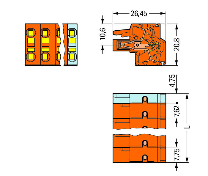

2-проводная розетка; 2,5 мм²; Шаг контактов 7,62 мм; 7-пол.
Augswan
231-2707/026-000
Wago
Wago 231-2707/026-000
Actuation typeOperating tool
Clamping spring materialChrome nickel spring steel (CrNi)
Цветorange
Connection technologyPush-in CAGE CLAMP®
Connector connection typefor conductors
Contact materialCopper alloy
Contact platingtin-plated
Contact type (pluggable connector)Female connector/socket
Country of originPL
Габариты: глубина26.45 mm / 1.041 inch
Fine-stranded conductor0.2 … 2.5 mm² / 24 … 12 AWG
Fine-stranded conductor with ferrule with plastic collar0.25 … 1.5 mm²
Fine-stranded conductor with ferrule without plastic collar0.25 … 2.5 mm²
Fire load0.357 MJ
Flammability class per UL94V0
GTIN4044918565486
Height20.8 mm / 0.819 inch
Insulating materialPolyamide 66 (PA 66)
Legend (ratings)(III / 2) ≙ Overvoltage category III / Pollution degree 2
Limit temperature range-60 … +85 °C
Material groupI
Mismating protectionNo
Number of Poles7
Number of connection types1
Number of levels1
Pin spacing7.62 mm (0.3 inch)
Product Group3 (Multi Conn. System)
Rated current16 A
Rated impulse voltage (II / 2)6 kV
Rated impulse voltage (III / 2)6 kV
Rated impulse voltage (III / 3)6 kV
Rated voltage (II / 2)1000 В
Rated voltage (III / 2)630 В
Rated voltage (III / 3)500 В
Solid conductor0.2 … 2.5 mm² / 24 … 12 AWG
Strip length9 … 10 mm / 0.35 … 0.39 Inch
Total number of connection points14
Total number of potentials7
Вес19.128 г
Ширина50.6 mm / 1.992 inch
