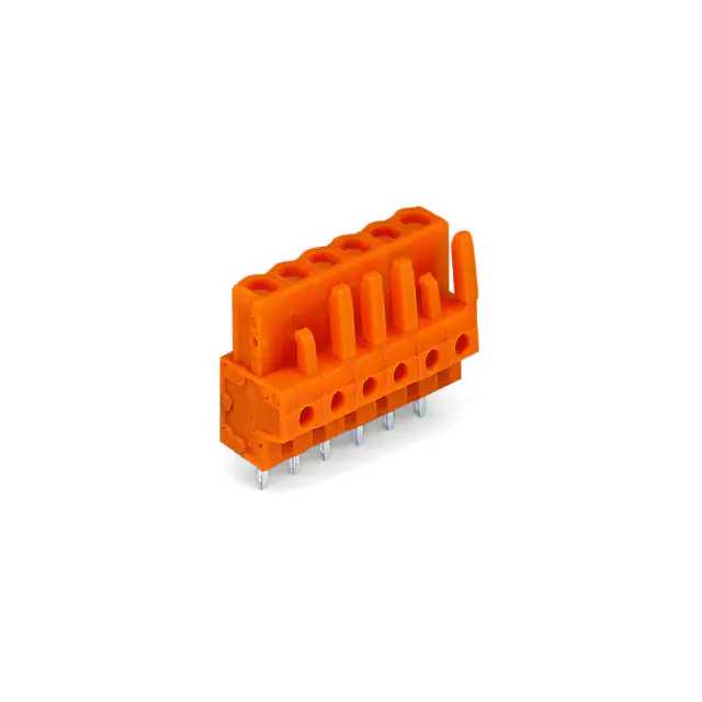

Datasheet Wago 232-162/039-000 — Даташит
Розетка под пайку THT; 0.6 x 1.0 mm solder pin; прямые; Фиксирующий рычаг; Шаг контактов 5,08 мм; 2-пол.

Цвет | orange |
Connector connection type | for PCBs |
Contact material | Copper alloy |
Contact plating | tin-plated |
Contact type (pluggable connector) | Female connector/socket |
Country of origin | DE |
Габариты: глубина | 11.6 mm / 0.457 inch |
Drilled hole diameter (tolerance) | 1.3(+ 0.1) мм |
Fire load | 0.057 MJ |
GTIN | 4044918623735 |
Height | 26.6 mm / 1.047 inch |
Height from the surface | 21.6 mm / 0.85 inch |
Legend (ratings) | (III / 2) ≙ Overvoltage category III / Pollution degree 2 |
Limit temperature range | -60 … +85 °C |
Locking of plug-in connection | locking lever |
Material group | I |
Mating direction to the PCB | 90 ° |
Mismating protection | No |
Number of Poles | 2 |
Number of levels | 1 |
Number of solder pins per potential | 1 |
PCB contact | THT |
Pin spacing | 5.08 mm (0.2 inch) |
Product Group | 3 (Multi Conn. System) |
Rated current | 12 A |
Rated impulse voltage (II / 2) | 4 kV |
Rated impulse voltage (III / 2) | 4 kV |
Rated impulse voltage (III / 3) | 4 kV |
Rated voltage (II / 2) | 630 В |
Rated voltage (III / 2) | 320 В |
Rated voltage (III / 3) | 320 В |
Solder pin arrangement | over the entire female connector, in line |
Solder pin dimensions | 0.6 x 1 mm |
Solder pin length | 5 мм |
Total number of connection points | 2 |
Total number of potentials | 2 |
Вес | 2.69 г |
Ширина | 25.96 mm / 1.022 inch |
