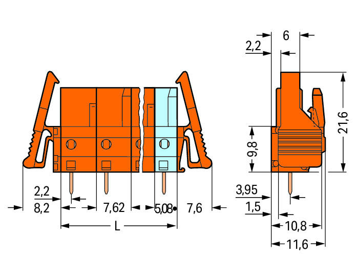

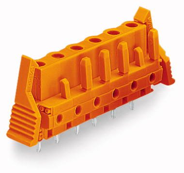

Розетка под пайку THT; 0.6 x 1.0 mm solder pin; прямые; Фиксирующий рычаг; Шаг контактов 7,62 мм; 4-пол.
Maybo
232-764/039-000
Wago
Wago 232-764/039-000
Цветorange
Connector connection typefor PCBs
Contact materialCopper alloy
Contact platingtin-plated
Contact type (pluggable connector)Female connector/socket
Country of originDE
Габариты: глубина11.6 mm / 0.457 inch
Drilled hole diameter (tolerance)1.3(+ 0.1) мм
Fire load0.107 MJ
Flammability class per UL94V0
GTIN4044918626057
Height23.25 mm / 0.915 inch
Height from the surface18.25 mm / 0.719 inch
Insulating materialPolyamide 66 (PA 66)
Legend (ratings)(III / 2) ≙ Overvoltage category III / Pollution degree 2
Limit temperature range-60 … +85 °C
Locking of plug-in connectionlocking lever
Material groupI
Mating direction to the PCB90 °
Mismating protectionNo
Number of Poles4
Number of levels1
Number of solder pins per potential1
PCB contactTHT
Pin spacing7.62 mm (0.3 inch)
Product Group3 (Multi Conn. System)
Rated current12 A
Rated impulse voltage (II / 2)6 kV
Rated impulse voltage (III / 2)6 kV
Rated impulse voltage (III / 3)6 kV
Rated voltage (II / 2)1000 В
Rated voltage (III / 2)630 В
Rated voltage (III / 3)500 В
Solder pin arrangementover the entire female connector, in line
Solder pin dimensions0.6 x 1 mm
Solder pin length5 мм
Total number of potentials4
Вес5.14 г
Ширина43.74 mm / 1.722 inch
