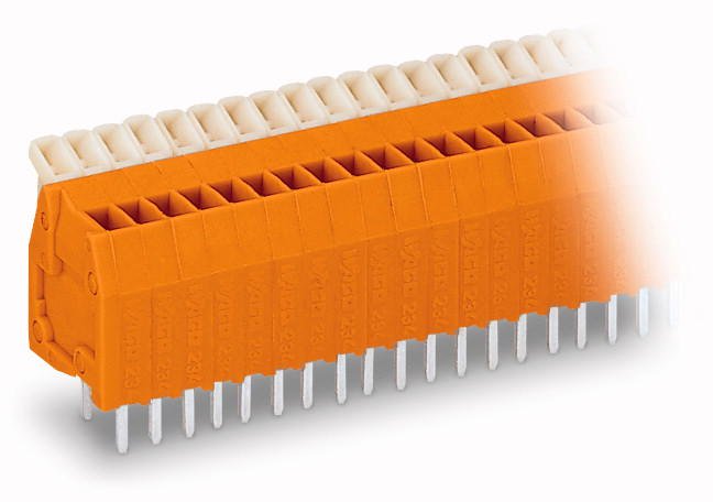

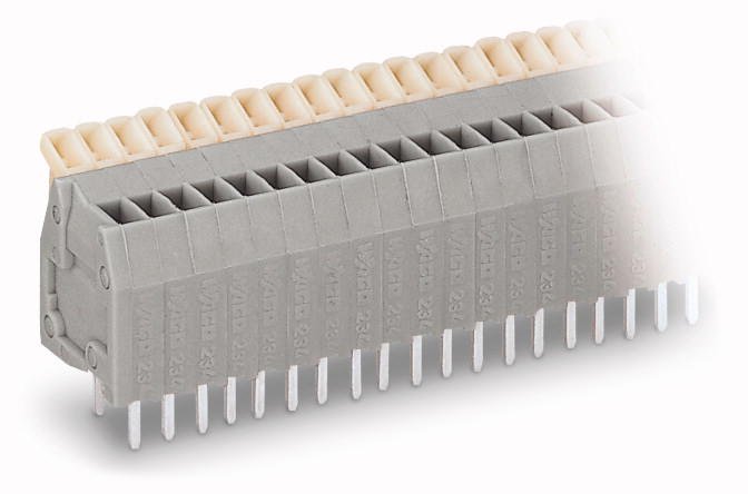

Parameters / Models | 234-202![]() | 234-203![]() | 234-204![]() | 234-205![]() | 234-206![]() | 234-207![]() | 234-208![]() | 234-209![]() | 234-210![]() | 234-212![]() | 234-216![]() | 234-224![]() | 234-236![]() | 234-248![]() | 234-502![]() | 234-503![]() | 234-504![]() | 234-505![]() | 234-505/000-006![]() | 234-506![]() | 234-507![]() | 234-508![]() | 234-509![]() | 234-510![]() | 234-512![]() | 234-516![]() | 234-524![]() | 234-536![]() | 234-548![]() |
Actuation type | Push-button | Push-button | Push-button | Push-button | Push-button | Push-button | Push-button | Push-button | Push-button | Push-button | Push-button | Push-button | Push-button | Push-button | Push-button | Push-button | Push-button | Push-button | Push-button | Push-button | Push-button | Push-button | Push-button | Push-button | Push-button | Push-button | Push-button | Push-button | Push-button |
Clamping spring material | Chrome nickel spring steel (CrNi) | Chrome nickel spring steel (CrNi) | Chrome nickel spring steel (CrNi) | Chrome nickel spring steel (CrNi) | Chrome nickel spring steel (CrNi) | Chrome nickel spring steel (CrNi) | Chrome nickel spring steel (CrNi) | Chrome nickel spring steel (CrNi) | Chrome nickel spring steel (CrNi) | Chrome nickel spring steel (CrNi) | Chrome nickel spring steel (CrNi) | Chrome nickel spring steel (CrNi) | Chrome nickel spring steel (CrNi) | Chrome nickel spring steel (CrNi) | Chrome nickel spring steel (CrNi) | Chrome nickel spring steel (CrNi) | Chrome nickel spring steel (CrNi) | Chrome nickel spring steel (CrNi) | Chrome nickel spring steel (CrNi) | Chrome nickel spring steel (CrNi) | Chrome nickel spring steel (CrNi) | Chrome nickel spring steel (CrNi) | Chrome nickel spring steel (CrNi) | Chrome nickel spring steel (CrNi) | Chrome nickel spring steel (CrNi) | Chrome nickel spring steel (CrNi) | Chrome nickel spring steel (CrNi) | Chrome nickel spring steel (CrNi) | Chrome nickel spring steel (CrNi) |
Цвет | gray | gray | gray | gray | gray | gray | gray | gray | gray | gray | gray | gray | gray | gray | orange | orange | orange | orange | blue | orange | orange | orange | orange | orange | orange | orange | orange | orange | orange |
Conductor entry angle to the PCB, ° | 90 | 90 | 90 | 90 | 90 | 90 | 90 | 90 | 90 | 90 | 90 | 90 | 90 | 90 | 90 | 90 | 90 | 90 | 90 | 90 | 90 | 90 | 90 | 90 | 90 | 90 | 90 | 90 | 90 |
Connection technology | CAGE CLAMP® | CAGE CLAMP® | CAGE CLAMP® | CAGE CLAMP® | CAGE CLAMP® | CAGE CLAMP® | CAGE CLAMP® | CAGE CLAMP® | CAGE CLAMP® | CAGE CLAMP® | CAGE CLAMP® | CAGE CLAMP® | CAGE CLAMP® | CAGE CLAMP® | CAGE CLAMP® | CAGE CLAMP® | CAGE CLAMP® | CAGE CLAMP® | CAGE CLAMP® | CAGE CLAMP® | CAGE CLAMP® | CAGE CLAMP® | CAGE CLAMP® | CAGE CLAMP® | CAGE CLAMP® | CAGE CLAMP® | CAGE CLAMP® | CAGE CLAMP® | CAGE CLAMP® |
Contact material | Electrolytic copper (Ecu) | Electrolytic copper (Ecu) | Electrolytic copper (Ecu) | Electrolytic copper (Ecu) | Electrolytic copper (Ecu) | Electrolytic copper (Ecu) | Electrolytic copper (Ecu) | Electrolytic copper (Ecu) | Electrolytic copper (Ecu) | Electrolytic copper (Ecu) | Electrolytic copper (Ecu) | Electrolytic copper (Ecu) | Electrolytic copper (Ecu) | Electrolytic copper (Ecu) | Electrolytic copper (Ecu) | Electrolytic copper (Ecu) | Electrolytic copper (Ecu) | Electrolytic copper (Ecu) | Electrolytic copper (Ecu) | Electrolytic copper (Ecu) | Electrolytic copper (Ecu) | Electrolytic copper (Ecu) | Electrolytic copper (Ecu) | Electrolytic copper (Ecu) | Electrolytic copper (Ecu) | Electrolytic copper (Ecu) | Electrolytic copper (Ecu) | Electrolytic copper (Ecu) | Electrolytic copper (Ecu) |
Contact plating | tin-plated | tin-plated | tin-plated | tin-plated | tin-plated | tin-plated | tin-plated | tin-plated | tin-plated | tin-plated | tin-plated | tin-plated | tin-plated | tin-plated | tin-plated | tin-plated | tin-plated | tin-plated | tin-plated | tin-plated | tin-plated | tin-plated | tin-plated | tin-plated | tin-plated | tin-plated | tin-plated | tin-plated | tin-plated |
Country of origin | CH | CH | CH | CH | CH | CH | CH | CH | CH | CH | CH | CH | CH | CH | CH | CH | CH | CH | CH | CH | CH | CH | CH | CH | CH | CH | CH | CH | CH |
Габариты: глубина | 14.4 mm / 0.567 inch | 14.4 mm / 0.567 inch | 14.4 mm / 0.567 inch | 14.4 mm / 0.567 inch | 14.4 mm / 0.567 inch | 14.4 mm / 0.567 inch | 14.4 mm / 0.567 inch | 14.4 mm / 0.567 inch | 14.4 mm / 0.567 inch | 14.4 mm / 0.567 inch | 14.4 mm / 0.567 inch | 14.4 mm / 0.567 inch | 14.4 mm / 0.567 inch | 14.4 mm / 0.567 inch | 14.4 mm / 0.567 inch | 14.4 mm / 0.567 inch | 14.4 mm / 0.567 inch | 14.4 mm / 0.567 inch | 14.4 mm / 0.567 inch | 14.4 mm / 0.567 inch | 14.4 mm / 0.567 inch | 14.4 mm / 0.567 inch | 14.4 mm / 0.567 inch | 14.4 mm / 0.567 inch | 14.4 mm / 0.567 inch | 14.4 mm / 0.567 inch | 14.4 mm / 0.567 inch | 14.4 mm / 0.567 inch | 14.4 mm / 0.567 inch |
Drilled hole diameter (tolerance), мм | 1.1(+ 0.1) | 1.1(+ 0.1) | 1.1(+ 0.1) | 1.1(+ 0.1) | 1.1(+ 0.1) | 1.1(+ 0.1) | 1.1(+ 0.1) | 1.1(+ 0.1) | 1.1(+ 0.1) | 1.1(+ 0.1) | 1.1(+ 0.1) | 1.1(+ 0.1) | 1.1(+ 0.1) | 1.1(+ 0.1) | 1.1(+ 0.1) | 1.1(+ 0.1) | 1.1(+ 0.1) | 1.1(+ 0.1) | 1.1(+ 0.1) | 1.1(+ 0.1) | 1.1(+ 0.1) | 1.1(+ 0.1) | 1.1(+ 0.1) | 1.1(+ 0.1) | 1.1(+ 0.1) | 1.1(+ 0.1) | 1.1(+ 0.1) | 1.1(+ 0.1) | 1.1(+ 0.1) |
Fine-stranded conductor | 0.08 … 0.5 mm² / 28 … 20 AWG | 0.08 … 0.5 mm² / 28 … 20 AWG | 0.08 … 0.5 mm² / 28 … 20 AWG | 0.08 … 0.5 mm² / 28 … 20 AWG | 0.08 … 0.5 mm² / 28 … 20 AWG | 0.08 … 0.5 mm² / 28 … 20 AWG | 0.08 … 0.5 mm² / 28 … 20 AWG | 0.08 … 0.5 mm² / 28 … 20 AWG | 0.08 … 0.5 mm² / 28 … 20 AWG | 0.08 … 0.5 mm² / 28 … 20 AWG | 0.08 … 0.5 mm² / 28 … 20 AWG | 0.08 … 0.5 mm² / 28 … 20 AWG | 0.08 … 0.5 mm² / 28 … 20 AWG | 0.08 … 0.5 mm² / 28 … 20 AWG | 0.08 … 0.5 mm² / 28 … 20 AWG | 0.08 … 0.5 mm² / 28 … 20 AWG | 0.08 … 0.5 mm² / 28 … 20 AWG | 0.08 … 0.5 mm² / 28 … 20 AWG | 0.08 … 0.5 mm² / 28 … 20 AWG | 0.08 … 0.5 mm² / 28 … 20 AWG | 0.08 … 0.5 mm² / 28 … 20 AWG | 0.08 … 0.5 mm² / 28 … 20 AWG | 0.08 … 0.5 mm² / 28 … 20 AWG | 0.08 … 0.5 mm² / 28 … 20 AWG | 0.08 … 0.5 mm² / 28 … 20 AWG | 0.08 … 0.5 mm² / 28 … 20 AWG | 0.08 … 0.5 mm² / 28 … 20 AWG | 0.08 … 0.5 mm² / 28 … 20 AWG | 0.08 … 0.5 mm² / 28 … 20 AWG |
Fine-stranded conductor with ferrule with plastic collar | 0.25 mm² | 0.25 mm² | 0.25 mm² | 0.25 mm² | 0.25 mm² | 0.25 mm² | 0.25 mm² | 0.25 mm² | 0.25 mm² | 0.25 mm² | 0.25 mm² | 0.25 mm² | 0.25 mm² | 0.25 mm² | 0.25 mm² | 0.25 mm² | 0.25 mm² | 0.25 mm² | 0.25 mm² | 0.25 mm² | 0.25 mm² | 0.25 mm² | 0.25 mm² | 0.25 mm² | 0.25 mm² | 0.25 mm² | 0.25 mm² | 0.25 mm² | 0.25 mm² |
Fine-stranded conductor with ferrule without plastic collar | 0.25 mm² | 0.25 mm² | 0.25 mm² | 0.25 mm² | 0.25 mm² | 0.25 mm² | 0.25 mm² | 0.25 mm² | 0.25 mm² | 0.25 mm² | 0.25 mm² | 0.25 mm² | 0.25 mm² | 0.25 mm² | 0.25 mm² | 0.25 mm² | 0.25 mm² | 0.25 mm² | 0.25 mm² | 0.25 mm² | 0.25 mm² | 0.25 mm² | 0.25 mm² | 0.25 mm² | 0.25 mm² | 0.25 mm² | 0.25 mm² | 0.25 mm² | 0.25 mm² |
Fire load, MJ | 0.018 | 0.025 | 0.032 | 0.039 | 0.046 | 0.053 | 0.06 | 0.067 | 0.074 | 0.088 | 0.116 | 0.172 | 0.256 | 0.34 | 0.018 | 0.025 | 0.032 | 0.039 | 0.039 | 0.046 | 0.053 | 0.06 | 0.067 | 0.074 | 0.088 | 0.116 | 0.172 | 0.256 | 0.34 |
Flammability class per UL94 | V0 | V0 | V0 | V0 | V0 | V0 | V0 | V0 | V0 | V0 | V0 | V0 | V0 | V0 | V0 | V0 | V0 | V0 | V0 | V0 | V0 | V0 | V0 | V0 | V0 | V0 | V0 | V0 | V0 |
GTIN | 4044918651486 | 4044918651493 | 4044918651509 | 4044918651516 | 4044918651523 | 4044918651530 | 4044918651547 | 4044918651554 | 4044918651561 | 4044918651585 | 4044918651622 | 4044918651707 | 4044918651769 | 4044918651929 | 4044918652100 | 4044918652117 | 4044918652124 | 4044918652131 | 4050821510734 | 4044918652148 | 4044918652155 | 4044918652162 | 4044918652179 | 4044918652186 | 4044918652209 | 4044918652247 | 4044918652322 | 4044918652810 | 4044918652353 |
Height | 18 mm / 0.709 inch | 18 mm / 0.709 inch | 18 mm / 0.709 inch | 18 mm / 0.709 inch | 18 mm / 0.709 inch | 18 mm / 0.709 inch | 18 mm / 0.709 inch | 18 mm / 0.709 inch | 18 mm / 0.709 inch | 18 mm / 0.709 inch | 18 mm / 0.709 inch | 18 mm / 0.709 inch | 18 mm / 0.709 inch | 18 mm / 0.709 inch | 18 mm / 0.709 inch | 18 mm / 0.709 inch | 18 mm / 0.709 inch | 18 mm / 0.709 inch | 18 mm / 0.709 inch | 18 mm / 0.709 inch | 18 mm / 0.709 inch | 18 mm / 0.709 inch | 18 mm / 0.709 inch | 18 mm / 0.709 inch | 18 mm / 0.709 inch | 18 mm / 0.709 inch | 18 mm / 0.709 inch | 18 mm / 0.709 inch | 18 mm / 0.709 inch |
Height from the surface | 14 mm / 0.551 inch | 14 mm / 0.551 inch | 14 mm / 0.551 inch | 14 mm / 0.551 inch | 14 mm / 0.551 inch | 14 mm / 0.551 inch | 14 mm / 0.551 inch | 14 mm / 0.551 inch | 14 mm / 0.551 inch | 14 mm / 0.551 inch | 14 mm / 0.551 inch | 14 mm / 0.551 inch | 14 mm / 0.551 inch | 14 mm / 0.551 inch | 14 mm / 0.551 inch | 14 mm / 0.551 inch | 14 mm / 0.551 inch | 14 mm / 0.551 inch | 14 mm / 0.551 inch | 14 mm / 0.551 inch | 14 mm / 0.551 inch | 14 mm / 0.551 inch | 14 mm / 0.551 inch | 14 mm / 0.551 inch | 14 mm / 0.551 inch | 14 mm / 0.551 inch | 14 mm / 0.551 inch | 14 mm / 0.551 inch | 14 mm / 0.551 inch |
Insulating material | Polyamide 66 (PA 66) | Polyamide 66 (PA 66) | Polyamide 66 (PA 66) | Polyamide 66 (PA 66) | Polyamide 66 (PA 66) | Polyamide 66 (PA 66) | Polyamide 66 (PA 66) | Polyamide 66 (PA 66) | Polyamide 66 (PA 66) | Polyamide 66 (PA 66) | Polyamide 66 (PA 66) | Polyamide 66 (PA 66) | Polyamide 66 (PA 66) | Polyamide 66 (PA 66) | Polyamide 66 (PA 66) | Polyamide 66 (PA 66) | Polyamide 66 (PA 66) | Polyamide 66 (PA 66) | Polyamide 66 (PA 66) | Polyamide 66 (PA 66) | Polyamide 66 (PA 66) | Polyamide 66 (PA 66) | Polyamide 66 (PA 66) | Polyamide 66 (PA 66) | Polyamide 66 (PA 66) | Polyamide 66 (PA 66) | Polyamide 66 (PA 66) | Polyamide 66 (PA 66) | Polyamide 66 (PA 66) |
Legend (ratings) | (III / 2) ≙ Overvoltage category III / Pollution degree 2 | (III / 2) ≙ Overvoltage category III / Pollution degree 2 | (III / 2) ≙ Overvoltage category III / Pollution degree 2 | (III / 2) ≙ Overvoltage category III / Pollution degree 2 | (III / 2) ≙ Overvoltage category III / Pollution degree 2 | (III / 2) ≙ Overvoltage category III / Pollution degree 2 | (III / 2) ≙ Overvoltage category III / Pollution degree 2 | (III / 2) ≙ Overvoltage category III / Pollution degree 2 | (III / 2) ≙ Overvoltage category III / Pollution degree 2 | (III / 2) ≙ Overvoltage category III / Pollution degree 2 | (III / 2) ≙ Overvoltage category III / Pollution degree 2 | (III / 2) ≙ Overvoltage category III / Pollution degree 2 | (III / 2) ≙ Overvoltage category III / Pollution degree 2 | (III / 2) ≙ Overvoltage category III / Pollution degree 2 | (III / 2) ≙ Overvoltage category III / Pollution degree 2 | (III / 2) ≙ Overvoltage category III / Pollution degree 2 | (III / 2) ≙ Overvoltage category III / Pollution degree 2 | (III / 2) ≙ Overvoltage category III / Pollution degree 2 | (III / 2) ≙ Overvoltage category III / Pollution degree 2 | (III / 2) ≙ Overvoltage category III / Pollution degree 2 | (III / 2) ≙ Overvoltage category III / Pollution degree 2 | (III / 2) ≙ Overvoltage category III / Pollution degree 2 | (III / 2) ≙ Overvoltage category III / Pollution degree 2 | (III / 2) ≙ Overvoltage category III / Pollution degree 2 | (III / 2) ≙ Overvoltage category III / Pollution degree 2 | (III / 2) ≙ Overvoltage category III / Pollution degree 2 | (III / 2) ≙ Overvoltage category III / Pollution degree 2 | (III / 2) ≙ Overvoltage category III / Pollution degree 2 | (III / 2) ≙ Overvoltage category III / Pollution degree 2 |
Limit temperature range | -60 … +105 °C | -60 … +105 °C | -60 … +105 °C | -60 … +105 °C | -60 … +105 °C | -60 … +105 °C | -60 … +105 °C | -60 … +105 °C | -60 … +105 °C | -60 … +105 °C | -60 … +105 °C | -60 … +105 °C | -60 … +105 °C | -60 … +105 °C | -60 … +105 °C | -60 … +105 °C | -60 … +105 °C | -60 … +105 °C | -60 … +105 °C | -60 … +105 °C | -60 … +105 °C | -60 … +105 °C | -60 … +105 °C | -60 … +105 °C | -60 … +105 °C | -60 … +105 °C | -60 … +105 °C | -60 … +105 °C | -60 … +105 °C |
Material group | I | I | I | I | I | I | I | I | I | I | I | I | I | I | I | I | I | I | I | I | I | I | I | I | I | I | I | I | I |
Number of Poles | 2 | 3 | 4 | 5 | 6 | 7 | 8 | 9 | 10 | 12 | 16 | 24 | 36 | 48 | 2 | 3 | 4 | 5 | 5 | 6 | 7 | 8 | 9 | 10 | 12 | 16 | 24 | 36 | 48 |
Number of connection types | 1 | 1 | 1 | 1 | 1 | 1 | 1 | 1 | 1 | 1 | 1 | 1 | 1 | 1 | 1 | 1 | 1 | 1 | 1 | 1 | 1 | 1 | 1 | 1 | 1 | 1 | 1 | 1 | 1 |
Number of levels | 1 | 1 | 1 | 1 | 1 | 1 | 1 | 1 | 1 | 1 | 1 | 1 | 1 | 1 | 1 | 1 | 1 | 1 | 1 | 1 | 1 | 1 | 1 | 1 | 1 | 1 | 1 | 1 | 1 |
Number of solder pins per potential | 2 | 2 | 2 | 2 | 2 | 2 | 2 | 2 | 2 | 2 | 2 | 2 | 2 | 2 | 2 | 2 | 2 | 2 | 2 | 2 | 2 | 2 | 2 | 2 | 2 | 2 | 2 | 2 | 2 |
PCB contact | THT | THT | THT | THT | THT | THT | THT | THT | THT | THT | THT | THT | THT | THT | THT | THT | THT | THT | THT | THT | THT | THT | THT | THT | THT | THT | THT | THT | THT |
Packaging type | BOX | ||||||||||||||||||||||||||||
Pin spacing | 2.5 mm (0.098 inch) | 2.5 mm (0.098 inch) | 2.5 mm (0.098 inch) | 2.5 mm (0.098 inch) | 2.5 mm (0.098 inch) | 2.5 mm (0.098 inch) | 2.5 mm (0.098 inch) | 2.5 mm (0.098 inch) | 2.5 mm (0.098 inch) | 2.5 mm (0.098 inch) | 2.5 mm (0.098 inch) | 2.5 mm (0.098 inch) | 2.5 mm (0.098 inch) | 2.5 mm (0.098 inch) | 2.54 mm (0.1 inch) | 2.54 mm (0.1 inch) | 2.54 mm (0.1 inch) | 2.54 mm (0.1 inch) | 2.54 mm (0.1 inch) | 2.54 mm (0.1 inch) | 2.54 mm (0.1 inch) | 2.54 mm (0.1 inch) | 2.54 mm (0.1 inch) | 2.54 mm (0.1 inch) | 2.54 mm (0.1 inch) | 2.54 mm (0.1 inch) | 2.54 mm (0.1 inch) | 2.54 mm (0.1 inch) | 2.54 mm (0.1 inch) |
Product Group | 4 (Printed Circuit) | 4 (Printed Circuit) | 4 (Printed Circuit) | 4 (Printed Circuit) | 4 (Printed Circuit) | 4 (Printed Circuit) | 4 (Printed Circuit) | 4 (Printed Circuit) | 4 (Printed Circuit) | 4 (Printed Circuit) | 4 (Printed Circuit) | 4 (Printed Circuit) | 4 (Printed Circuit) | 4 (Printed Circuit) | 4 (Printed Circuit) | 4 (Printed Circuit) | 4 (Printed Circuit) | 4 (Printed Circuit) | 4 (Printed Circuit) | 4 (Printed Circuit) | 4 (Printed Circuit) | 4 (Printed Circuit) | 4 (Printed Circuit) | 4 (Printed Circuit) | 4 (Printed Circuit) | 4 (Printed Circuit) | 4 (Printed Circuit) | 4 (Printed Circuit) | |
Rated current, A | 6 | 6 | 6 | 6 | 6 | 6 | 6 | 6 | 6 | 6 | 6 | 6 | 6 | 6 | 6 | 6 | 6 | 6 | 6 | 6 | 6 | 6 | 6 | 6 | 6 | 6 | 6 | 6 | 6 |
Rated impulse voltage (II / 2), kV | 2.5 | 2.5 | 2.5 | 2.5 | 2.5 | 2.5 | 2.5 | 2.5 | 2.5 | 2.5 | 2.5 | 2.5 | 2.5 | 2.5 | 2.5 | 2.5 | 2.5 | 2.5 | 2.5 | 2.5 | 2.5 | 2.5 | 2.5 | 2.5 | 2.5 | 2.5 | 2.5 | 2.5 | 2.5 |
Rated impulse voltage (III / 2), kV | 2.5 | 2.5 | 2.5 | 2.5 | 2.5 | 2.5 | 2.5 | 2.5 | 2.5 | 2.5 | 2.5 | 2.5 | 2.5 | 2.5 | 2.5 | 2.5 | 2.5 | 2.5 | 2.5 | 2.5 | 2.5 | 2.5 | 2.5 | 2.5 | 2.5 | 2.5 | 2.5 | 2.5 | 2.5 |
Rated impulse voltage (III / 3), kV | 2.5 | 2.5 | 2.5 | 2.5 | 2.5 | 2.5 | 2.5 | 2.5 | 2.5 | 2.5 | 2.5 | 2.5 | 2.5 | 2.5 | 2.5 | 2.5 | 2.5 | 2.5 | 2.5 | 2.5 | 2.5 | 2.5 | 2.5 | 2.5 | 2.5 | 2.5 | 2.5 | 2.5 | 2.5 |
Rated voltage (II / 2), В | 320 | 320 | 320 | 320 | 320 | 320 | 320 | 320 | 320 | 320 | 320 | 320 | 320 | 320 | 320 | 320 | 320 | 320 | 320 | 320 | 320 | 320 | 320 | 320 | 320 | 320 | 320 | 320 | 320 |
Rated voltage (III / 2), В | 160 | 160 | 160 | 160 | 160 | 160 | 160 | 160 | 160 | 160 | 160 | 160 | 160 | 160 | 160 | 160 | 160 | 160 | 160 | 160 | 160 | 160 | 160 | 160 | 160 | 160 | 160 | 160 | 160 |
Rated voltage (III / 3), В | 63 | 63 | 63 | 63 | 63 | 63 | 63 | 63 | 63 | 63 | 63 | 63 | 63 | 63 | 63 | 63 | 63 | 63 | 63 | 63 | 63 | 63 | 63 | 63 | 63 | 63 | 63 | 63 | 63 |
Solder pin arrangement | over the entire terminal strip, in line | over the entire terminal strip, in line | over the entire terminal strip, in line | over the entire terminal strip, in line | over the entire terminal strip, in line | over the entire terminal strip, in line | over the entire terminal strip, in line | over the entire terminal strip, in line | over the entire terminal strip, in line | over the entire terminal strip, in line | over the entire terminal strip, in line | over the entire terminal strip, in line | over the entire terminal strip, in line | over the entire terminal strip, in line | over the entire terminal strip, in line | over the entire terminal strip, in line | over the entire terminal strip, in line | over the entire terminal strip, in line | over the entire terminal strip, in line | over the entire terminal strip, in line | over the entire terminal strip, in line | over the entire terminal strip, in line | over the entire terminal strip, in line | over the entire terminal strip, in line | over the entire terminal strip, in line | over the entire terminal strip, in line | over the entire terminal strip, in line | over the entire terminal strip, in line | over the entire terminal strip, in line |
Solder pin dimensions | 0.5 x 0.75 mm | 0.5 x 0.75 mm | 0.5 x 0.75 mm | 0.5 x 0.75 mm | 0.5 x 0.75 mm | 0.5 x 0.75 mm | 0.5 x 0.75 mm | 0.5 x 0.75 mm | 0.5 x 0.75 mm | 0.5 x 0.75 mm | 0.5 x 0.75 mm | 0.5 x 0.75 mm | 0.5 x 0.75 mm | 0.5 x 0.75 mm | 0.5 x 0.75 mm | 0.5 x 0.75 mm | 0.5 x 0.75 mm | 0.5 x 0.75 mm | 0.5 x 0.75 mm | 0.5 x 0.75 mm | 0.5 x 0.75 mm | 0.5 x 0.75 mm | 0.5 x 0.75 mm | 0.5 x 0.75 mm | 0.5 x 0.75 mm | 0.5 x 0.75 mm | 0.5 x 0.75 mm | 0.5 x 0.75 mm | 0.5 x 0.75 mm |
Solder pin length, мм | 4 | 4 | 4 | 4 | 4 | 4 | 4 | 4 | 4 | 4 | 4 | 4 | 4 | 4 | 4 | 4 | 4 | 4 | 4 | 4 | 4 | 4 | 4 | 4 | 4 | 4 | 4 | 4 | 4 |
Solid conductor | 0.08 … 0.5 mm² / 28 … 20 AWG | 0.08 … 0.5 mm² / 28 … 20 AWG | 0.08 … 0.5 mm² / 28 … 20 AWG | 0.08 … 0.5 mm² / 28 … 20 AWG | 0.08 … 0.5 mm² / 28 … 20 AWG | 0.08 … 0.5 mm² / 28 … 20 AWG | 0.08 … 0.5 mm² / 28 … 20 AWG | 0.08 … 0.5 mm² / 28 … 20 AWG | 0.08 … 0.5 mm² / 28 … 20 AWG | 0.08 … 0.5 mm² / 28 … 20 AWG | 0.08 … 0.5 mm² / 28 … 20 AWG | 0.08 … 0.5 mm² / 28 … 20 AWG | 0.08 … 0.5 mm² / 28 … 20 AWG | 0.08 … 0.5 mm² / 28 … 20 AWG | 0.08 … 0.5 mm² / 28 … 20 AWG | 0.08 … 0.5 mm² / 28 … 20 AWG | 0.08 … 0.5 mm² / 28 … 20 AWG | 0.08 … 0.5 mm² / 28 … 20 AWG | 0.08 … 0.5 mm² / 28 … 20 AWG | 0.08 … 0.5 mm² / 28 … 20 AWG | 0.08 … 0.5 mm² / 28 … 20 AWG | 0.08 … 0.5 mm² / 28 … 20 AWG | 0.08 … 0.5 mm² / 28 … 20 AWG | 0.08 … 0.5 mm² / 28 … 20 AWG | 0.08 … 0.5 mm² / 28 … 20 AWG | 0.08 … 0.5 mm² / 28 … 20 AWG | 0.08 … 0.5 mm² / 28 … 20 AWG | 0.08 … 0.5 mm² / 28 … 20 AWG | 0.08 … 0.5 mm² / 28 … 20 AWG |
Strip length | 5 … 6 mm / 0.2 … 0.24 Inch | 5 … 6 mm / 0.2 … 0.24 Inch | 5 … 6 mm / 0.2 … 0.24 Inch | 5 … 6 mm / 0.2 … 0.24 Inch | 5 … 6 mm / 0.2 … 0.24 Inch | 5 … 6 mm / 0.2 … 0.24 Inch | 5 … 6 mm / 0.2 … 0.24 Inch | 5 … 6 mm / 0.2 … 0.24 Inch | 5 … 6 mm / 0.2 … 0.24 Inch | 5 … 6 mm / 0.2 … 0.24 Inch | 5 … 6 mm / 0.2 … 0.24 Inch | 5 … 6 mm / 0.2 … 0.24 Inch | 5 … 6 mm / 0.2 … 0.24 Inch | 5 … 6 mm / 0.2 … 0.24 Inch | 5 … 6 mm / 0.2 … 0.24 Inch | 5 … 6 mm / 0.2 … 0.24 Inch | 5 … 6 mm / 0.2 … 0.24 Inch | 5 … 6 mm / 0.2 … 0.24 Inch | 5 … 6 mm / 0.2 … 0.24 Inch | 5 … 6 mm / 0.2 … 0.24 Inch | 5 … 6 mm / 0.2 … 0.24 Inch | 5 … 6 mm / 0.2 … 0.24 Inch | 5 … 6 mm / 0.2 … 0.24 Inch | 5 … 6 mm / 0.2 … 0.24 Inch | 5 … 6 mm / 0.2 … 0.24 Inch | 5 … 6 mm / 0.2 … 0.24 Inch | 5 … 6 mm / 0.2 … 0.24 Inch | 5 … 6 mm / 0.2 … 0.24 Inch | 5 … 6 mm / 0.2 … 0.24 Inch |
Total number of connection points | 2 | 3 | 4 | 5 | 6 | 7 | 8 | 9 | 10 | 12 | 16 | 24 | 36 | 48 | 2 | 3 | 4 | 5 | 5 | 6 | 7 | 8 | 9 | 10 | 12 | 16 | 24 | 36 | 48 |
Total number of potentials | 2 | 3 | 4 | 5 | 6 | 7 | 8 | 9 | 10 | 12 | 16 | 24 | 36 | 48 | 2 | 3 | 4 | 5 | 5 | 6 | 7 | 8 | 9 | 10 | 12 | 16 | 24 | 36 | 48 |
Вес, г | 1.127 | 1.623 | 2.119 | 2.615 | 3.111 | 3.607 | 4.103 | 4.599 | 5.095 | 6.087 | 8.071 | 12.039 | 17.991 | 23.943 | 1.127 | 1.624 | 2.121 | 2.618 | 2.613 | 3.115 | 3.612 | 4.109 | 4.606 | 5.103 | 6.097 | 8.085 | 12.2 | 16.633 | 21.205 |
Ширина | 7.2 mm / 0.283 inch | 9.7 mm / 0.382 inch | 12.2 mm / 0.48 inch | 14.7 mm / 0.579 inch | 17.2 mm / 0.677 inch | 19.7 mm / 0.776 inch | 22.2 mm / 0.874 inch | 24.7 mm / 0.972 inch | 27.2 mm / 1.071 inch | 32.2 mm / 1.268 inch | 42.2 mm / 1.661 inch | 62.2 mm / 2.449 inch | 92.2 mm / 3.63 inch | 122.2 mm / 4.811 inch | 7.28 mm / 0.287 inch | 9.82 mm / 0.387 inch | 12.36 mm / 0.487 inch | 14.9 mm / 0.587 inch | 14.9 mm / 0.587 inch | 17.44 mm / 0.687 inch | 19.98 mm / 0.787 inch | 22.52 mm / 0.887 inch | 25.06 mm / 0.987 inch | 27.6 mm / 1.087 inch | 32.68 mm / 1.287 inch | 42.84 mm / 1.687 inch | 63.16 mm / 2.487 inch | 93.64 mm / 3.687 inch | 124.12 mm / 4.887 inch |
