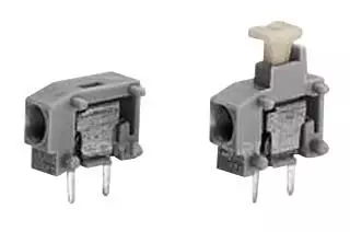

Datasheet Wago 235-401 — Даташит
Стекируемый клеммный блок для печатных плат; 2,5 мм²; Шаг контактов 5/5,08 мм; 1-полюсный; PUSH WIRE
![]() 21 предложений от 10 поставщиков 235-401, Модульная клемма на плату, шаг 5-5,08 мм, серая | |||
235-401/331-000 | от 60 ₽ | ||
235-401/331-000 Wago | 82 ₽ | ||
235-401/331-000 Wago | по запросу | ||
160-2354-01 | по запросу |
Actuation type | Operating tool |
Clamping spring material | Chrome nickel spring steel (CrNi) |
Цвет | gray |
Connection technology | PUSH WIRE® |
Contact material | Electrolytic copper (Ecu) |
Contact plating | tin-plated |
Country of origin | CN |
Габариты: глубина | 12.5 mm / 0.492 inch |
Drilled hole diameter (tolerance) | 1(+ 0.1) мм |
Fine-stranded conductor with ferrule with plastic collar | 0.25 … 1.5 mm² |
Fine-stranded conductor with ferrule without plastic collar | 0.25 … 1.5 mm² |
Fire load | 0.011 MJ |
GTIN | 4044918829977 |
Height | 12.8 mm / 0.504 inch |
Height from the surface | 9.2 mm / 0.362 inch |
Legend (ratings) | (III / 2) ≙ Overvoltage category III / Pollution degree 2 |
Limit temperature range | -60 … +105 °C |
Material group | I |
Number of Poles | 1 |
Number of connection types | 1 |
Number of levels | 1 |
Number of solder pins per potential | 2 |
PCB contact | THT |
Pin spacing | 5/5.08 mm / 0.197/0.2 inch |
Product Group | 4 (Printed Circuit) |
Rated current | 24 A |
Rated impulse voltage (II / 2) | 4 kV |
Rated impulse voltage (III / 2) | 4 kV |
Rated impulse voltage (III / 3) | 4 kV |
Rated voltage (II / 2) | 630 В |
Rated voltage (III / 2) | 320 В |
Rated voltage (III / 3) | 250 В |
Solder pin arrangement | within the terminal block, in line |
Solder pin dimensions | 0.8 x 0.4 mm |
Solder pin length | 3.6 мм |
Solid conductor | 0.5 … 2.5 mm² / 20 … 14 AWG |
Strip length | 9 … 10 mm / 0.35 … 0.39 Inch |
Total number of connection points | 1 |
Total number of potentials | 1 |
Вес | 0.677 г |
Ширина | 6.5 mm / 0.256 inch |
