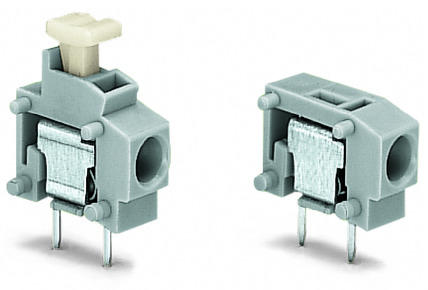

Стекируемый клеммный блок для печатных плат; Кнопка; 1,5 мм²; Шаг контактов 5/5,08 мм; 1-полюсный; Зажим Push-in CAGE CLAMP

Actuation typePush-button
Clamping spring materialChrome nickel spring steel (CrNi)
Цветgray
Connection technologyPush-in CAGE CLAMP®
Contact materialElectrolytic copper (Ecu)
Contact platingtin-plated
Country of originCN
Габариты: глубина12.5 mm / 0.492 inch
Drilled hole diameter (tolerance)1(+ 0.1) мм
Fine-stranded conductor0.75 … 1.5 mm² / 20 … 14 AWG
Fine-stranded conductor with ferrule with plastic collar0.25 … 1 mm²
Fine-stranded conductor with ferrule without plastic collar0.25 … 1 mm²
Fire load0.014 MJ
Flammability class per UL94V0
GTIN4044918830027
Height19.1 mm / 0.752 inch
Height from the surface15.5 mm / 0.61 inch
Insulating materialPolyamide 66 (PA 66)
Legend (ratings)(III / 2) ≙ Overvoltage category III / Pollution degree 2
Limit temperature range-60 … +105 °C
Material groupI
Number of Poles1
Number of connection types1
Number of levels1
Number of solder pins per potential2
PCB contactTHT
Pin spacing5/5.08 mm / 0.197/0.2 inch
Product Group4 (Printed Circuit)
Rated current10 A
Rated impulse voltage (II / 2)4 kV
Rated impulse voltage (III / 2)4 kV
Rated impulse voltage (III / 3)4 kV
Rated voltage (II / 2)400 В
Rated voltage (III / 2)250 В
Rated voltage (III / 3)250 В
Solder pin arrangementwithin the terminal block, in line
Solder pin dimensions0.4 x 0.8 mm
Solder pin length3.6 мм
Solid conductor0.2 … 1.5 mm² / 20 … 14 AWG
Strip length9 … 10 mm / 0.35 … 0.39 Inch
Total number of connection points1
Total number of potentials1
Вес0.76 г
Ширина6.5 mm / 0.256 inch
