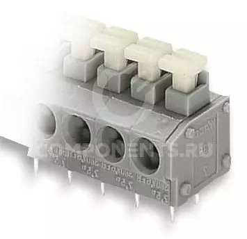

Datasheet Wago 235-408/331-000 — Даташит
Клеммная колодка для печатной платы; Кнопка; 1,5 мм²; Шаг контактов 5/5,08 мм; 8-полюсный; Зажим Push-in CAGE CLAMP
![]() 18 предложений от 6 поставщиков Клеммная колодка типа провод к плате, 5.08 мм, 8 вывод(-ов), 20 AWG, 14 AWG, 1.5 мм², Вставной | |||
235-408/331-000 Wago | 209 ₽ | ||
235-408/331-000. Wago | от 264 ₽ | ||
235-408/331-000 Wago | от 411 ₽ | ||
235-408/331-000 Wago | 591 ₽ |
Actuation type | Push-button |
Clamping spring material | Chrome nickel spring steel (CrNi) |
Цвет | gray |
Connection technology | Push-in CAGE CLAMP® |
Contact material | Electrolytic copper (Ecu) |
Contact plating | tin-plated |
Country of origin | CN |
Габариты: глубина | 12.5 mm / 0.492 inch |
Drilled hole diameter (tolerance) | 1(+ 0.1) мм |
Fine-stranded conductor | 0.75 … 1.5 mm² / 20 … 14 AWG |
Fine-stranded conductor with ferrule with plastic collar | 0.25 … 1 mm² |
Fine-stranded conductor with ferrule without plastic collar | 0.25 … 1 mm² |
Fire load | 0.108 MJ |
GTIN | 4055143258913 |
Height | 19.1 mm / 0.752 inch |
Height from the surface | 15.5 mm / 0.61 inch |
Legend (ratings) | (III / 2) ≙ Overvoltage category III / Pollution degree 2 |
Limit temperature range | -60 … +105 °C |
Material group | I |
Number of Poles | 8 |
Number of connection types | 1 |
Number of levels | 1 |
Number of solder pins per potential | 2 |
PCB contact | THT |
Pin spacing | 5/5.08 mm / 0.197/0.2 inch |
Product Group | 4 (Printed Circuit) |
Rated current | 17.5 A |
Rated impulse voltage (II / 2) | 4 kV |
Rated impulse voltage (III / 2) | 4 kV |
Rated impulse voltage (III / 3) | 4 kV |
Rated voltage (II / 2) | 630 В |
Rated voltage (III / 2) | 320 В |
Rated voltage (III / 3) | 250 В |
Solder pin arrangement | over the entire terminal strip, in line |
Solder pin dimensions | 0.4 x 0.8 mm |
Solder pin length | 3.6 мм |
Solid conductor | 0.2 … 1.5 mm² / 20 … 14 AWG |
Strip length | 9 … 10 mm / 0.35 … 0.39 Inch |
Total number of connection points | 8 |
Total number of potentials | 8 |
Вес | 6.166 г |
Ширина | 41.5 mm / 1.634 inch |
