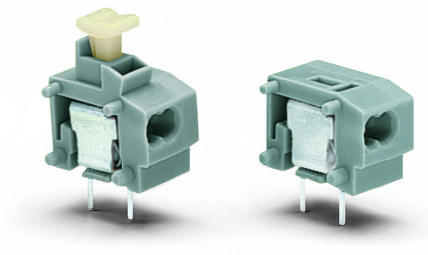

Datasheet Wago 235-551/332-000 — Даташит
Стекируемый 2-проводной клеммный блок для печатной платы; Кнопка; 0,75 мм²; Шаг контактов 7,5/7,62 мм; 1-полюсный; PUSH WIRE

Actuation type | Push-button |
Clamping spring material | Chrome nickel spring steel (CrNi) |
Цвет | gray |
Connection technology | PUSH WIRE® |
Contact material | Electrolytic copper (Ecu) |
Contact plating | tin-plated |
Country of origin | CN |
Габариты: глубина | 12.5 mm / 0.492 inch |
Drilled hole diameter (tolerance) | 1(+ 0.1) мм |
Fire load | 0.018 MJ |
GTIN | 4044918831277 |
Height | 19.1 mm / 0.752 inch |
Height from the surface | 15.5 mm / 0.61 inch |
Legend (ratings) | (III / 2) ≙ Overvoltage category III / Pollution degree 2 |
Limit temperature range | -60 … +105 °C |
Material group | I |
Number of Poles | 1 |
Number of connection types | 1 |
Number of levels | 1 |
Number of solder pins per potential | 2 |
PCB contact | THT |
Pin spacing | 7.5/7.62 mm / 0.295/0.3 inch |
Product Group | 4 (Printed Circuit) |
Rated current | 10 A |
Rated impulse voltage (II / 2) | 6 kV |
Rated impulse voltage (III / 2) | 6 kV |
Rated impulse voltage (III / 3) | 6 kV |
Rated voltage (II / 2) | 800 В |
Rated voltage (III / 2) | 400 В |
Rated voltage (III / 3) | 400 В |
Solder pin arrangement | within the terminal block, in line |
Solder pin dimensions | 0.8 x 0.4 mm |
Solder pin length | 3.6 мм |
Solid conductor | 0.2 … 0.75 mm² / 24 … 18 AWG |
Strip length | 9 … 10 mm / 0.35 … 0.39 Inch |
Total number of connection points | 2 |
Total number of potentials | 1 |
Вес | 0.905 г |
Ширина | 9 mm / 0.354 inch |
