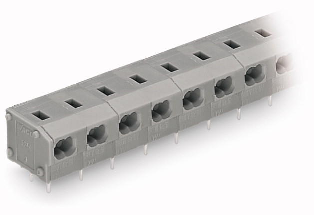

Datasheet Wago 235-553 — Даташит
Клеммная колодка для печатной платы с 2 проводниками; 0,75 мм²; Шаг контактов 7,5/7,62 мм; 3-полюсный; PUSH WIRE
Клеммные Блоки, TERM BLOCK PLUG 5.08MM 23POS | |||
OSTVM235553 On Shore Technology | 891 ₽ | ||
OSTVM235553 | 891 ₽ | ||
235-553 Wago | по запросу |
Actuation type | Operating tool |
Clamping spring material | Chrome nickel spring steel (CrNi) |
Цвет | gray |
Connection technology | PUSH WIRE® |
Contact material | Electrolytic copper (Ecu) |
Contact plating | tin-plated |
Country of origin | CN |
Габариты: глубина | 12.5 mm / 0.492 inch |
Drilled hole diameter (tolerance) | 1(+ 0.1) мм |
Fine-stranded conductor with ferrule without plastic collar | 0.25 … 0.34 mm² |
Fire load | 0.048 MJ |
GTIN | 4044918831369 |
Height | 12.8 mm / 0.504 inch |
Height from the surface | 9.2 mm / 0.362 inch |
Legend (ratings) | (III / 2) ≙ Overvoltage category III / Pollution degree 2 |
Limit temperature range | -60 … +105 °C |
Material group | I |
Number of Poles | 3 |
Number of connection types | 1 |
Number of levels | 1 |
Number of solder pins per potential | 2 |
PCB contact | THT |
Pin spacing | 7.5/7.62 mm / 0.295/0.3 inch |
Product Group | 4 (Printed Circuit) |
Rated current | 10 A |
Rated impulse voltage (II / 2) | 6 kV |
Rated impulse voltage (III / 2) | 6 kV |
Rated impulse voltage (III / 3) | 6 kV |
Rated voltage (II / 2) | 1000 В |
Rated voltage (III / 2) | 630 В |
Rated voltage (III / 3) | 400 В |
Solder pin arrangement | over the entire terminal strip, in line |
Solder pin dimensions | 0.8 x 0.4 mm |
Solder pin length | 3.6 мм |
Solid conductor | 0.25 … 0.75 mm² / 24 … 18 AWG |
Strip length | 9 … 10 mm / 0.35 … 0.39 Inch |
Total number of connection points | 6 |
Total number of potentials | 3 |
Вес | 2.56 г |
Ширина | 24 mm / 0.945 inch |
