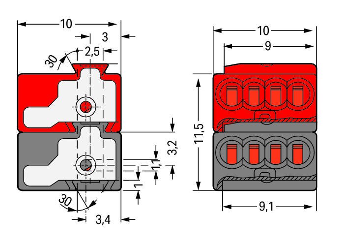

модул. разъем на печатную плату; для индивидуальных выводов под пайку; для KNX; Ø 0,8 мм; Шаг контактов 5,75 мм; 2-пол.
Clamping spring material | Chrome nickel spring steel (CrNi) |
Цвет | dark gray/red |
Conductor diameter | 0.6 … 0.8 mm |
Conductor diameter 2 | 1 mm |
Conductor diameter information | When using different conductor diameters |
Conductor diameter information 2 | When using identical conductor diameters |
Connection technology | PUSH WIRE® |
Connector connection type | for conductors |
Contact material | Electrolytic copper (Ecu) |
Contact plating | tin-plated |
Contact type (pluggable connector) | Female connector/socket |
Country of origin | DE |
Габариты: глубина | 10 mm / 0.394 inch |
Fire load | 0.024 MJ |
GTIN | 4044918442831 |
Height | 11.5 mm / 0.453 inch |
Legend (ratings) | (III / 2) ≙ Overvoltage category III / Pollution degree 2 |
Limit temperature range | -60 … +105 °C |
Material group | I |
Number of Poles | 2 |
Number of connection types | 1 |
Number of levels | 1 |
Rated current | 6 A |
Rated impulse voltage (II / 2) | 4 kV |
Rated impulse voltage (III / 2) | 4 kV |
Rated impulse voltage (III / 3) | 4 kV |
Rated voltage (II / 2) | 630 В |
Rated voltage (III / 2) | 100 В |
Rated voltage (III / 3) | 250 В |
Strip length | 5 … 6 mm / 0.2 … 0.24 Inch |
Total number of connection points | 8 |
Total number of potentials | 2 |
Вес | 1.6 г |
Ширина | 10 mm / 0.394 inch |
