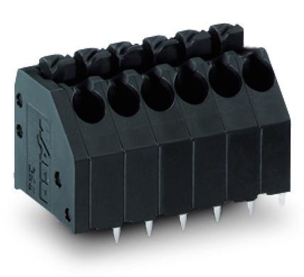

Datasheet Wago 250-108/353-604 — Даташит
Клеммная колодка THR PCB; Кнопка; 1,5 мм²; Шаг контактов 3,5 мм; 8-полюсный; Вставной зажим CAGE CLAMP

Actuation type | Push-button |
Clamping spring material | Copper alloy |
Цвет | black |
Conductor entry angle to the PCB | 45 ° |
Connection technology | Push-in CAGE CLAMP® |
Contact plating | tin-plated |
Country of origin | CH |
Габариты: глубина | 12 mm / 0.472 inch |
Fine-stranded conductor | 0.2 … 1.5 mm² / 24 … 16 AWG |
Fine-stranded conductor with ferrule with plastic collar | 0.25 … 1 mm² |
Fine-stranded conductor with ferrule without plastic collar | 0.25 … 1 mm² |
Flammability class per UL94 | V2 |
GTIN | 4055143243377 |
Height | 15.5 mm / 0.61 inch |
Height from the surface | 13.1 mm / 0.516 inch |
Insulating material | Polyamide 46 (PA 46) |
Legend (ratings) | (III / 2) ≙ Overvoltage category III / Pollution degree 2 |
Limit temperature range | -60 … +115 °C |
Material group | III a |
Number of Poles | 8 |
Number of connection types | 1 |
Number of levels | 1 |
Number of solder pins per potential | 1 |
PCB contact | THR |
Packaging type | BOX |
Pin spacing | 3.5 mm (0.138 inch) |
Plated through-hole diameter (THR) | 1 (+ 0.1) мм |
Rated current | 8 A |
Rated impulse voltage (II / 2) | 4 kV |
Rated impulse voltage (III / 2) | 4 kV |
Rated impulse voltage (III / 3) | 4 kV |
Rated voltage (II / 2) | 320 В |
Rated voltage (III / 2) | 320 В |
Rated voltage (III / 3) | 200 В |
Solder pin arrangement | over the entire terminal strip, staggered |
Solder pin dimensions | 0.4 x 0.75 mm |
Solder pin length | 2.4 мм |
Solid conductor | 0.2 … 1.5 mm² / 24 … 16 AWG |
Strip length | 8.5 … 9.5 mm / 0.33 … 0.37 Inch |
Total number of connection points | 8 |
Total number of potentials | 8 |
Вес | 3.841 г |
Ширина | 29.5 mm / 1.161 inch |
