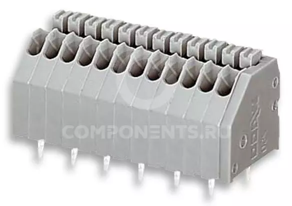

Datasheet Wago 250-410 — Даташит
Клеммная колодка для печатной платы; Кнопка; 0,5 мм²; Шаг контактов 2,5 мм; 10-полюсный; Зажим Push-in CAGE CLAMP

Actuation type | Push-button |
Clamping spring material | Copper alloy |
Цвет | gray |
Conductor diameter | 0.4 … 0.8 mm |
Conductor entry angle to the PCB | 45 ° |
Connection technology | Push-in CAGE CLAMP® |
Contact plating | tin-plated |
Country of origin | CH |
Габариты: глубина | 12 mm / 0.472 inch |
Drilled hole diameter (tolerance) | 1(+ 0.1) мм |
Fine-stranded conductor | 0.2 … 0.5 mm² / 24 … 20 AWG |
Fire load | 0.076 MJ |
GTIN | 4044918643054 |
Height | 16.7 mm / 0.657 inch |
Height from the surface | 13.1 mm / 0.516 inch |
Legend (ratings) | (III / 2) ≙ Overvoltage category III / Pollution degree 2 |
Limit temperature range | -60 … +105 °C |
Material group | I |
Number of Poles | 10 |
Number of connection types | 1 |
Number of levels | 1 |
Number of solder pins per potential | 1 |
PCB contact | THT |
Pin spacing | 2.5 mm (0.098 inch) |
Product Group | 4 (Printed Circuit) |
Rated current | 4 A |
Rated impulse voltage (II / 2) | 2.5 kV |
Rated impulse voltage (III / 2) | 2.5 kV |
Rated impulse voltage (III / 3) | 2.5 kV |
Rated voltage (II / 2) | 320 В |
Rated voltage (III / 2) | 160 В |
Rated voltage (III / 3) | 160 В |
Solder pin arrangement | over the entire terminal strip, staggered |
Solder pin dimensions | 0.4 x 0.75 mm |
Solder pin length | 3.6 мм |
Solid conductor | 0.14 … 0.5 mm² / 24 … 20 AWG |
Strip length | 8.5 … 9.5 mm / 0.33 … 0.37 Inch |
Total number of connection points | 10 |
Total number of potentials | 10 |
Вес | 3.669 г |
Ширина | 26.5 mm / 1.043 inch |
