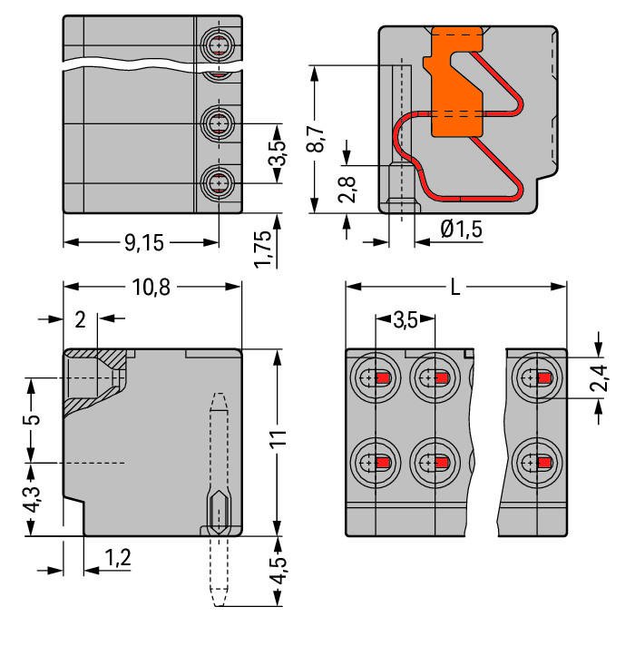

модул. разъем на печатную плату; для индивидуальных выводов под пайку; Нажимная кнопка; Ø 0,8 мм; Шаг контактов 3,5 мм; 5-пол.
Wago 252-105
Actuation typePush-button
Clamping spring materialCopper alloy
Цветgray
Conductor diameter0.4 … 0.8 mm
Connection technologyPUSH WIRE®
Connector connection typefor PCBs
Contact platingtin-plated
Contact type (pluggable connector)Female connector/socket
Country of originPL
Габариты: глубина10.5 mm / 0.413 inch
Fire load0.06 MJ
Flammability class per UL94V0
GTIN4045454039738
Height11 mm / 0.433 inch
Insulating materialPolyamide 66 (PA 66)
Legend (ratings)(III / 2) ≙ Overvoltage category III / Pollution degree 2
Limit temperature range-60 … +105 °C
Material groupI
Mating direction to the PCB90 °
Number of Poles5
Number of connection types1
Number of levels1
PCB contactTHT
Pin spacing3.5 mm (0.138 inch)
Product Group4 (Printed Circuit)
Rated current2 A
Rated impulse voltage (II / 2)4 kV
Rated impulse voltage (III / 2)4 kV
Rated impulse voltage (III / 3)4 kV
Rated voltage (II / 2)630 В
Rated voltage (III / 2)320 В
Rated voltage (III / 3)320 В
Solid conductor0.4 … 0.8 mm² / 26 … 20 AWG
Strip length6 … 7 mm / 0.24 … 0.28 Inch
Total number of connection points10
Total number of potentials5
Вес2.271 г
Ширина17.5 mm / 0.689 inch
