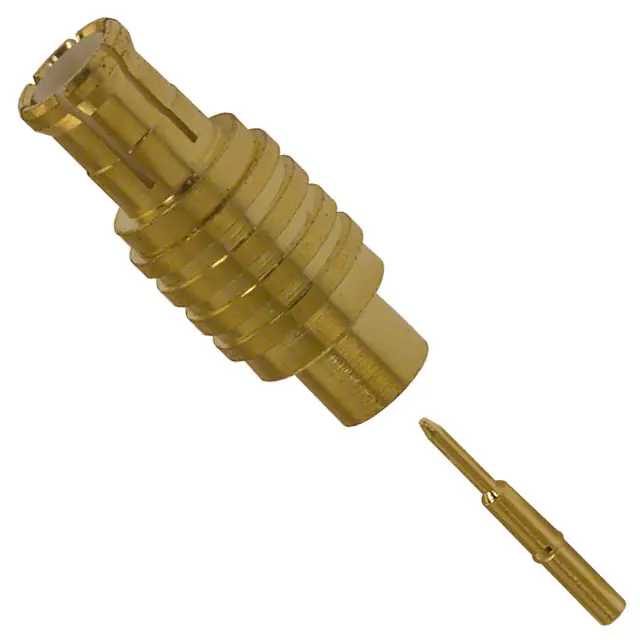

модул. разъем на печатную плату; для индивидуальных выводов под пайку; Нажимная кнопка; Ø 0,8 мм; Шаг контактов 3,5 мм; 7-пол.
| Actuation type | Push-button |
| Clamping spring material | Copper alloy |
| Цвет | gray |
| Conductor diameter | 0.4 … 0.8 mm |
| Connection technology | PUSH WIRE® |
| Connector connection type | for PCBs |
| Contact plating | tin-plated |
| Contact type (pluggable connector) | Female connector/socket |
| Country of origin | PL |
| Габариты: глубина | 10.5 mm / 0.413 inch |
| Fire load | 0.084 MJ |
| Flammability class per UL94 | V0 |
| GTIN | 4045454039752 |
| Height | 11 mm / 0.433 inch |
| Insulating material | Polyamide 66 (PA 66) |
| Legend (ratings) | (III / 2) ≙ Overvoltage category III / Pollution degree 2 |
| Limit temperature range | -60 … +105 °C |
| Material group | I |
| Mating direction to the PCB | 90 ° |
| Number of Poles | 7 |
| Number of connection types | 1 |
| Number of levels | 1 |
| PCB contact | THT |
| Pin spacing | 3.5 mm (0.138 inch) |
| Product Group | 4 (Printed Circuit) |
| Rated current | 2 A |
| Rated impulse voltage (II / 2) | 4 kV |
| Rated impulse voltage (III / 2) | 4 kV |
| Rated impulse voltage (III / 3) | 4 kV |
| Rated voltage (II / 2) | 630 В |
| Rated voltage (III / 2) | 320 В |
| Rated voltage (III / 3) | 320 В |
| Solid conductor | 0.4 … 0.8 mm² / 26 … 20 AWG |
| Strip length | 6 … 7 mm / 0.24 … 0.28 Inch |
| Total number of connection points | 14 |
| Total number of potentials | 7 |
| Вес | 3.177 г |
| Ширина | 24.5 mm / 0.965 inch |
