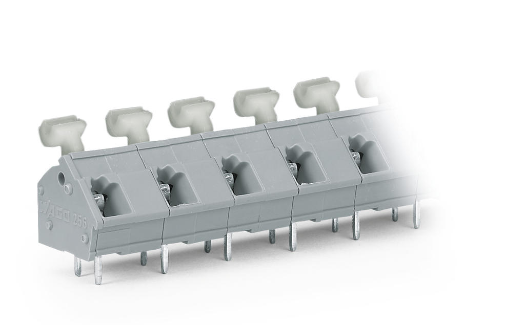

Клеммная колодка для печатной платы; Кнопка; 2,5 мм²; Шаг контактов 10/10,16 мм; 3-полюсный; CAGE CLAMP; возможность объединения
PCB TERMINAL BLOCK; PUSH-BUTTON; | |||
256-603/334-000 Wago | по запросу |
Actuation type | Push-button, angled |
Clamping spring material | Chrome nickel spring steel (CrNi) |
Цвет | gray |
Conductor entry angle to the PCB | 45 ° |
Connection technology | CAGE CLAMP® |
Contact material | Electrolytic copper (Ecu) |
Contact plating | tin-plated |
Country of origin | CH |
Габариты: глубина | 17.2 mm / 0.677 inch |
Drilled hole diameter (tolerance) | 1.1(+ 0.1) мм |
Fine-stranded conductor | 0.08 … 2.5 mm² / 28 … 12 AWG |
Fine-stranded conductor with ferrule with plastic collar | 0.25 … 1.5 mm² |
Fine-stranded conductor with ferrule without plastic collar | 0.25 … 1.5 mm² |
GTIN | 4055143385602 |
Height | 20.1 mm / 0.791 inch |
Height from the surface | 16.1 mm / 0.634 inch |
Legend (ratings) | (III / 2) ≙ Overvoltage category III / Pollution degree 2 |
Limit temperature range | -60 … +105 °C |
Material group | I |
Number of Poles | 3 |
Number of connection types | 1 |
Number of levels | 1 |
Number of solder pins per potential | 2 |
PCB contact | THT |
Pin spacing | 10/10.16 mm / 0.394/0.4 inch |
Rated current | 24 A |
Rated impulse voltage (II / 2) | 6 kV |
Rated impulse voltage (III / 2) | 6 kV |
Rated impulse voltage (III / 3) | 6 kV |
Rated voltage (II / 2) | 1000 В |
Rated voltage (III / 2) | 630 В |
Rated voltage (III / 3) | 500 В |
Solder pin arrangement | over the entire terminal strip, in line |
Solder pin dimensions | 0.7 x 0.7 mm |
Solder pin length | 3.6 мм |
Solid conductor | 0.08 … 2.5 mm² / 28 … 12 AWG |
Strip length | 5 … 6 mm / 0.2 … 0.24 Inch |
Total number of connection points | 3 |
Total number of potentials | 3 |
Вес | 3.724 г |
Ширина | 32.9 mm / 1.295 inch |
