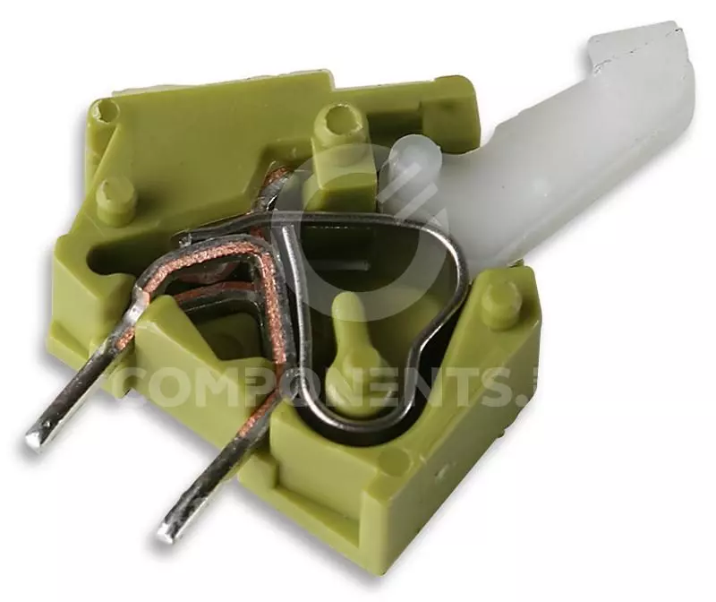

Actuation type | Push-button |
Clamping spring material | Chrome nickel spring steel (CrNi) |
Цвет | light green |
Conductor entry angle to the PCB | 45 ° |
Connection technology | CAGE CLAMP® |
Contact material | Electrolytic copper (Ecu) |
Contact plating | tin-plated |
Country of origin | CH |
Габариты: глубина | 17.6 mm / 0.693 inch |
Drilled hole diameter (tolerance) | 1.1(+ 0.1) мм |
Fine-stranded conductor | 0.08 … 2.5 mm² / 28 … 12 AWG |
Fine-stranded conductor with ferrule with plastic collar | 0.25 … 1.5 mm² |
Fine-stranded conductor with ferrule without plastic collar | 0.25 … 1.5 mm² |
Fire load | 0.013 MJ |
GTIN | 4044918762885 |
Height | 23.7 mm / 0.933 inch |
Height from the surface | 18.2 mm / 0.717 inch |
Legend (ratings) | (III / 2) ≙ Overvoltage category III / Pollution degree 2 |
Limit temperature range | -60 … +105 °C |
Material group | I |
Number of Poles | 1 |
Number of connection types | 1 |
Number of levels | 1 |
Number of solder pins per potential | 2 |
PCB contact | THT |
Pin spacing | 5/5.08 mm / 0.197/0.2 inch |
Product Group | 4 (Printed Circuit) |
Rated current | 24 A |
Rated impulse voltage (II / 2) | 4 kV |
Rated impulse voltage (III / 2) | 4 kV |
Rated impulse voltage (III / 3) | 4 kV |
Rated voltage (II / 2) | 630 В |
Rated voltage (III / 2) | 320 В |
Rated voltage (III / 3) | 250 В |
Solder pin arrangement | within the terminal block, in line |
Solder pin dimensions | 0.7 x 0.7 mm |
Solder pin length | 5.5 мм |
Solid conductor | 0.08 … 2.5 mm² / 28 … 12 AWG |
Strip length | 5 … 6 mm / 0.2 … 0.24 Inch |
Total number of connection points | 1 |
Total number of potentials | 1 |
Вес | 0.925 г |
Ширина | 7.8 mm / 0.307 inch |
