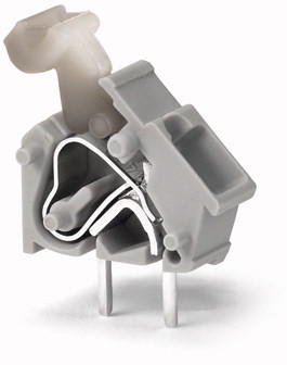

Штабелируемая клеммная колодка для печатной платы; Нажать кнопку; 2,5 мм²; Расстояние между контактами 5/5,08 мм; 1-полюсный; ЗАЖИМ ДЛЯ КЛЕТКИ; вариант объединения
Actuation typePush-button, angled
Clamping spring materialChrome nickel spring steel (CrNi)
Цветblack
Conductor entry angle to the PCB45 °
Connection technologyCAGE CLAMP®
Contact materialElectrolytic copper (Ecu)
Contact platingtin-plated
Country of originCH
Габариты: глубина14.2 mm / 0.559 inch
Drilled hole diameter (tolerance)1.1(+ 0.1) мм
Fine-stranded conductor0.08 … 2.5 mm² / 28 … 12 AWG
Fine-stranded conductor with ferrule with plastic collar0.25 … 1.5 mm²
Fine-stranded conductor with ferrule without plastic collar0.25 … 1.5 mm²
Fire load0.014 MJ
Flammability class per UL94V0
GTIN4055143059374
Height24.2 mm / 0.953 inch
Height from the surface20.2 mm / 0.795 inch
Insulating materialPolyamide 66 (PA 66)
Legend (ratings)(III / 2) ≙ Overvoltage category III / Pollution degree 2
Limit temperature range-60 … +105 °C
Material groupI
Number of Poles1
Number of connection types1
Number of levels1
Number of solder pins per potential2
PCB contactTHT
Packaging typeBOX
Pin spacing5/5.08 mm / 0.197/0.2 inch
Product Group4 (Printed Circuit)
Rated current24 A
Rated impulse voltage (II / 2)4 kV
Rated impulse voltage (III / 2)4 kV
Rated impulse voltage (III / 3)4 kV
Rated voltage (II / 2)630 В
Rated voltage (III / 2)320 В
Rated voltage (III / 3)250 В
Solder pin arrangementwithin the terminal block, in line
Solder pin dimensions0.7 x 0.7 mm
Solder pin length4 мм
Solid conductor0.08 … 2.5 mm² / 28 … 12 AWG
Strip length5 … 6 mm / 0.2 … 0.24 Inch
Total number of connection points1
Total number of potentials1
Вес0.954 г
Ширина7.8 mm / 0.307 inch
