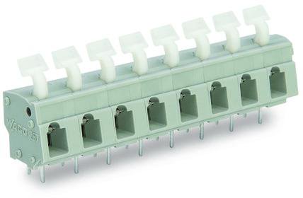

Datasheet Wago 257-553/000-009/999-950 — Даташит
Клеммная колодка для печатной платы; Кнопка; 2,5 мм²; Шаг контактов 7,5/7,62 мм; 3-полюсный; подходит для применения во взрывоопасных зонах; CAGE CLAMP; возможность объединения
Actuation type | Push-button, angled |
Clamping spring material | Chrome nickel spring steel (CrNi) |
Цвет | light gray |
Connection technology | CAGE CLAMP® |
Contact material | Electrolytic copper (Ecu) |
Contact plating | tin-plated |
Country of origin | CH |
Габариты: глубина | 14.2 mm / 0.559 inch |
Drilled hole diameter (tolerance) | 1.1(+ 0.1) мм |
Fine-stranded conductor | 0.08 … 2.5 mm² / 28 … 12 AWG |
Fine-stranded conductor with ferrule with plastic collar | 0.25 … 1.5 mm² |
Fine-stranded conductor with ferrule without plastic collar | 0.25 … 1.5 mm² |
Fire load | 0.08 MJ |
GTIN | 4044918679268 |
Height | 24.2 mm / 0.953 inch |
Height from the surface | 20.2 mm / 0.795 inch |
Limit temperature range | -60 … +105 °C |
Material group | I |
Number of Poles | 3 |
Number of connection types | 1 |
Number of levels | 1 |
Number of solder pins per potential | 2 |
PCB contact | THT |
Pin spacing | 7.5/7.62 mm / 0.295/0.3 inch |
Rated current (Ex e II) | 16 A |
Rated voltage EN (Ex e II) | 275 В |
Solder pin arrangement | over the entire terminal strip, in line |
Solder pin dimensions | 0.7 x 0.7 mm |
Solder pin length | 4 мм |
Solid conductor | 0.08 … 2.5 mm² / 28 … 12 AWG |
Strip length | 5 … 6 mm / 0.2 … 0.24 Inch |
Total number of connection points | 3 |
Total number of potentials | 3 |
Вес | 4.355 г |
Ширина | 25.4 mm / 1 inch |
