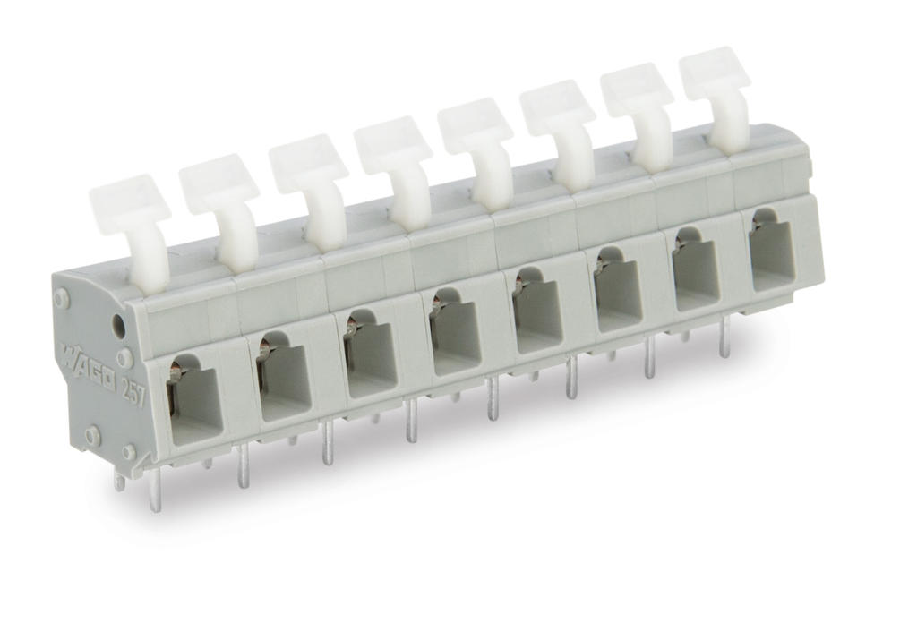

Datasheet Wago 257-559 — Даташит
Клеммная колодка для печатной платы; Кнопка; 2,5 мм²; Шаг контактов 7,5/7,62 мм; 9-полюсный; CAGE CLAMP; возможность объединения
IMDG MP-100*100-B7541 Price per-1 BRADY | |||
GWS257559 BRADY | 382 ₽ | ||
257-559 Wago | по запросу |
Actuation type | Push-button, angled |
Clamping spring material | Chrome nickel spring steel (CrNi) |
Цвет | gray |
Connection technology | CAGE CLAMP® |
Contact material | Electrolytic copper (Ecu) |
Contact plating | tin-plated |
Country of origin | PL |
Габариты: глубина | 14.2 mm / 0.559 inch |
Drilled hole diameter (tolerance) | 1.1(+ 0.1) мм |
Fine-stranded conductor | 0.08 … 2.5 mm² / 28 … 12 AWG |
Fine-stranded conductor with ferrule with plastic collar | 0.25 … 1.5 mm² |
Fine-stranded conductor with ferrule without plastic collar | 0.25 … 1.5 mm² |
Fire load | 0.23 MJ |
GTIN | 4044918677233 |
Height | 24.2 mm / 0.953 inch |
Height from the surface | 20.2 mm / 0.795 inch |
Legend (ratings) | (III / 2) ≙ Overvoltage category III / Pollution degree 2 |
Limit temperature range | -60 … +105 °C |
Material group | I |
Number of Poles | 9 |
Number of connection types | 1 |
Number of levels | 1 |
Number of solder pins per potential | 2 |
PCB contact | THT |
Pin spacing | 7.5/7.62 mm / 0.295/0.3 inch |
Product Group | 4 (Printed Circuit) |
Rated current | 24 A |
Rated impulse voltage (II / 2) | 6 kV |
Rated impulse voltage (III / 2) | 6 kV |
Rated impulse voltage (III / 3) | 6 kV |
Rated voltage (II / 2) | 1000 В |
Rated voltage (III / 2) | 630 В |
Rated voltage (III / 3) | 400 В |
Solder pin arrangement | over the entire terminal strip, in line |
Solder pin dimensions | 0.7 x 0.7 mm |
Solder pin length | 4 мм |
Solid conductor | 0.08 … 2.5 mm² / 28 … 12 AWG |
Strip length | 5 … 6 mm / 0.2 … 0.24 Inch |
Total number of connection points | 9 |
Total number of potentials | 9 |
Вес | 12.672 г |
Ширина | 70.4 mm / 2.772 inch |
