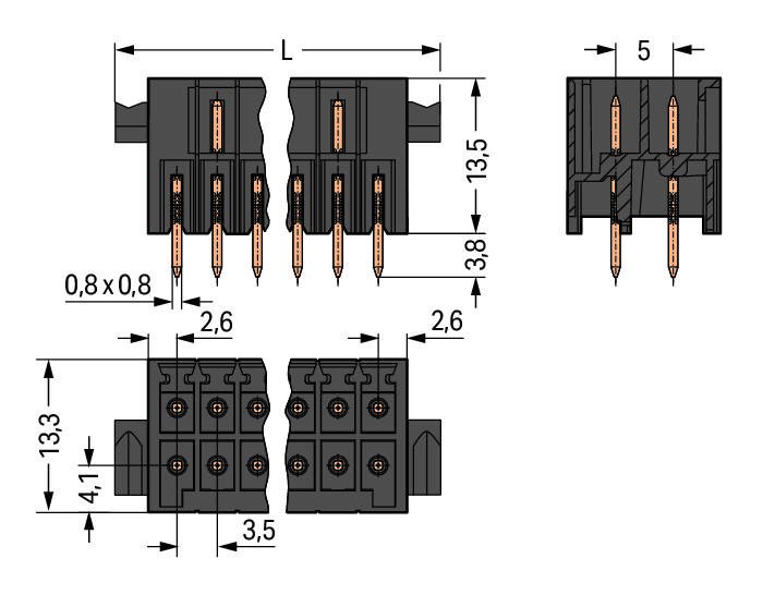

Цвет | black |
Connector connection type | for PCBs |
Contact material | Electrolytic copper (Ecu) |
Contact plating | tin-plated |
Contact type (pluggable connector) | Male connector/plug |
Country of origin | PL |
Габариты: глубина | 13.3 mm / 0.524 inch |
Drilled hole diameter (tolerance) | 1.2(+ 0.1) мм |
Fire load | 0.044 MJ |
GTIN | 4045454808341 |
Height | 17.3 mm / 0.681 inch |
Height from the surface | 13.5 mm / 0.531 inch |
Insulating material | Polyphtalamide (PPA GF) |
Legend (ratings) | (III / 2) ≙ Overvoltage category III / Pollution degree 2 |
Limit temperature range | -60 … +100 °C |
Locking of plug-in connection | Locking lever |
Material group | I |
Mating direction to the PCB | 90 ° |
Mismating protection | Yes |
Number of Poles | 6 |
Number of levels | 2 |
Number of solder pins per potential | 1 |
PCB contact | THT |
Pin spacing | 3.5 mm (0.138 inch) |
Product Group | 3 (Multi Conn. System) |
Rated current | 10 A |
Rated impulse voltage (II / 2) | 2.5 kV |
Rated impulse voltage (III / 2) | 2.5 kV |
Rated impulse voltage (III / 3) | 2.5 kV |
Rated voltage (II / 2) | 250 В |
Rated voltage (III / 2) | 160 В |
Rated voltage (III / 3) | 80 В |
Solder pin arrangement | over the entire male connector, in line |
Solder pin dimensions | 0.8 x 0.8 mm |
Solder pin length | 3.8 мм |
Total number of potentials | 6 |
Вес | 1.922 г |
Ширина | 18.6 mm / 0.732 inch |
