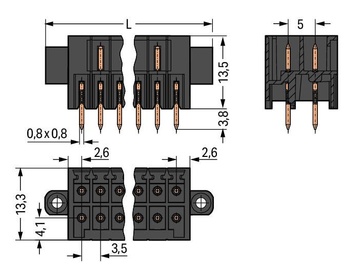

Вилка THT, 2-рядн.; 0.8 x 0.8 mm solder pin; прямые; 100% защита от неправильного подсоединения; Резьбовой фланец; Шаг контактов 3,5 мм; 2 x 5-полюсов
Augswan
713-1405/107-000
Wago
Wago 713-1405/107-000
Цветblack
Connector connection typefor PCBs
Contact materialElectrolytic copper (Ecu)
Contact platingtin-plated
Contact type (pluggable connector)Male connector/plug
Country of originPL
Габариты: глубина13.3 mm / 0.524 inch
Drilled hole diameter (tolerance)1.2(+ 0.1) мм
Fire load0.066 MJ
Flammability class per UL94V0
GTIN4045454808945
Height17.3 mm / 0.681 inch
Height from the surface13.5 mm / 0.531 inch
Insulating materialPolyphtalamide (PPA GF)
Legend (ratings)(III / 2) ≙ Overvoltage category III / Pollution degree 2
Limit temperature range-60 … +100 °C
Locking of plug-in connectionThreaded flange
Material groupI
Mating direction to the PCB90 °
Mismating protectionYes
Number of Poles10
Number of levels2
Number of solder pins per potential1
PCB contactTHT
Pin spacing3.5 mm (0.138 inch)
Product Group3 (Multi Conn. System)
Rated current10 A
Rated impulse voltage (II / 2)2.5 kV
Rated impulse voltage (III / 2)2.5 kV
Rated impulse voltage (III / 3)2.5 kV
Rated voltage (II / 2)250 В
Rated voltage (III / 2)160 В
Rated voltage (III / 3)80 В
Solder pin arrangementover the entire male connector, in line
Solder pin dimensions0.8 x 0.8 mm
Solder pin length3.8 мм
Total number of potentials10
Вес3.39 г
