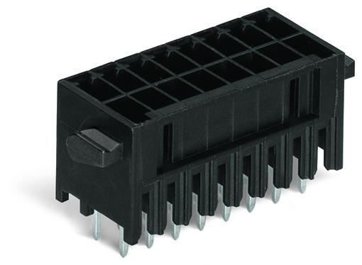

Вилка под пайку THR, 2-рядн.; 0.8 x 0.8 mm solder pin; прямые; 100% защита от неправильного подсоединения; Рычаги; упаковка в ленте на бобине; Шаг контактов 3,5 мм; 2 x 6-полюсов
THR MALE HEADER, 2-ROW; 0.8 X 0. | |||
713-1406/116-000/997-406 Wago | по запросу |
Цвет | black |
Connector connection type | for PCBs |
Contact material | Electrolytic copper (Ecu) |
Contact plating | tin-plated |
Contact type (pluggable connector) | Male connector/plug |
Country of origin | DE |
Габариты: глубина | 13.3 mm / 0.524 inch |
Fire load | 0.079 MJ |
GTIN | 4050821308744 |
Height | 15.9 mm / 0.626 inch |
Height from the surface | 13.5 mm / 0.531 inch |
Insulating material | Polyphtalamide (PPA GF) |
Legend (ratings) | (III / 2) ≙ Overvoltage category III / Pollution degree 2 |
Limit temperature range | -60 … +100 °C |
Locking of plug-in connection | Locking lever |
Material group | I |
Mating direction to the PCB | 90 ° |
Mismating protection | Yes |
Number of Poles | 12 |
Number of levels | 2 |
Number of solder pins per potential | 1 |
PCB contact | THR |
Packaging type | bag |
Pin spacing | 3.5 mm (0.138 inch) |
Plated through-hole diameter (THR) | 1.2 (+ 0.1) мм |
Rated current | 10 A |
Rated impulse voltage (II / 2) | 2.5 kV |
Rated impulse voltage (III / 2) | 2.5 kV |
Rated impulse voltage (III / 3) | 2.5 kV |
Rated voltage (II / 2) | 250 В |
Rated voltage (III / 2) | 160 В |
Rated voltage (III / 3) | 80 В |

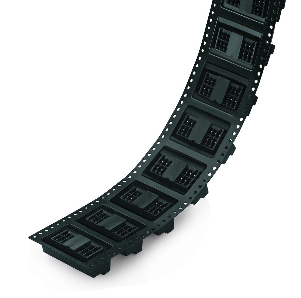

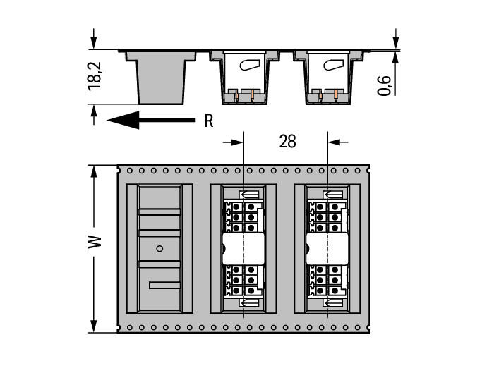

Reel diameter of tape-and-reel packaging | 330 мм |
Solder pin arrangement | over the entire male connector, in line |
Solder pin dimensions | 0.8 x 0.8 mm |
Solder pin length | 2.4 мм |
Tape width | 44 мм |
Total number of potentials | 12 |
Вес | 3.332 г |
Ширина | 29.1 mm / 1.146 inch |
