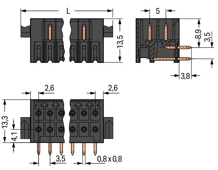

Вилка THT, 2-рядн.; 0.8 x 0.8 mm solder pin; угловые; 100% защита от неправильного подсоединения; Рычаги; Шаг контактов 3,5 мм; 2 x 14-полюсов
| THT MALE HEADER, 2-ROW; 0.8 X 0. | |||
| 713-1434/037-000 Wago | по запросу | ||
| Цвет | black |
| Connector connection type | for PCBs |
| Contact material | Electrolytic copper (Ecu) |
| Contact plating | tin-plated |
| Contact type (pluggable connector) | Male connector/plug |
| Country of origin | PL |
| Габариты: глубина | 13.5 mm / 0.531 inch |
| Drilled hole diameter (tolerance) | 1.2(+ 0.1) мм |
| Fire load | 0.15 MJ |
| Flammability class per UL94 | V0 |
| GTIN | 4045454808907 |
| Height | 17.1 mm / 0.673 inch |
| Height from the surface | 13.3 mm / 0.524 inch |
| Insulating material | Polyphtalamide (PPA GF) |
| Legend (ratings) | (III / 2) ≙ Overvoltage category III / Pollution degree 2 |
| Limit temperature range | -60 … +100 °C |
| Locking of plug-in connection | Locking lever |
| Material group | I |
| Mismating protection | Yes |
| Number of Poles | 28 |
| Number of levels | 2 |
| Number of solder pins per potential | 1 |
| PCB contact | THT |
| Pin spacing | 3.5 mm (0.138 inch) |
| Product Group | 3 (Multi Conn. System) |
| Rated current | 10 A |
| Rated impulse voltage (II / 2) | 2.5 kV |
| Rated impulse voltage (III / 2) | 2.5 kV |
| Rated impulse voltage (III / 3) | 2.5 kV |
| Rated voltage (II / 2) | 250 В |
| Rated voltage (III / 2) | 160 В |
| Rated voltage (III / 3) | 80 В |
| Solder pin arrangement | over the entire male connector, in line |
| Solder pin dimensions | 0.8 x 0.8 mm |
| Solder pin length | 3.8 мм |
| Total number of potentials | 3 |
| Вес | 7.67 г |
| Ширина | 57.1 mm / 2.248 inch |
