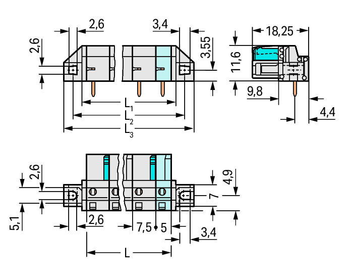

Datasheet Wago 722-836/031-000 — Даташит
Розетка под пайку THT; 0.6 x 1.0 mm solder pin; угловые; 100% защита от неправильного подсоединения; зажимное кольцо; Шаг контактов 7,5 мм; 6-пол.
| 722-836/031-000 Wago | по запросу | ||
| Цвет | light gray |
| Connector connection type | for PCBs |
| Contact material | Copper alloy |
| Contact plating | tin-plated |
| Contact type (pluggable connector) | Female connector/socket |
| Country of origin | DE |
| Габариты: глубина | 18.25 mm / 0.719 inch |
| Drilled hole diameter (tolerance) | 1.3(+ 0.1) мм |
| Fire load | 0.142 MJ |
| Flammability class per UL94 | V0 |
| GTIN | 4044918627566 |
| Height | 16.6 mm / 0.654 inch |
| Height from the surface | 11.6 mm / 0.457 inch |
| Insulating material | Polyamide 66 (PA 66) |
| Legend (ratings) | (III / 2) ≙ Overvoltage category III / Pollution degree 2 |
| Limit temperature range | -60 … +85 °C |
| Material group | I |
| Mismating protection | Yes |
| Mounting type | Mounting flange |
| Number of Poles | 6 |
| Number of levels | 1 |
| Number of solder pins per potential | 1 |
| PCB contact | THT |
| Pin spacing | 7.5 mm (0.295 inch) |
| Product Group | 3 (Multi Conn. System) |
| Rated current | 12 A |
| Rated impulse voltage (II / 2) | 6 kV |
| Rated impulse voltage (III / 2) | 6 kV |
| Rated impulse voltage (III / 3) | 6 kV |
| Rated voltage (II / 2) | 1000 В |
| Rated voltage (III / 2) | 630 В |
| Rated voltage (III / 3) | 500 В |
| Solder pin arrangement | over the entire female connector, in line |
| Solder pin dimensions | 0.6 x 1 mm |
| Solder pin length | 5 мм |
| Total number of potentials | 6 |
| Type of mounting | Feed-through mounting Panel mounting |
| Вес | 7.4 г |
| Ширина | 57.3 mm / 2.256 inch |
