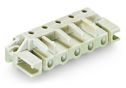

Datasheet Wago 722-836/047-000 — Даташит
Розетка под пайку THT; 0.6 x 1.0 mm solder pin; угловые; 100% защита от неправильного подсоединения; Проходной фланец; Шаг контактов 7,5 мм; 6-пол.
THT FEMALE HEADER; 0.6 X 1.0 MM | |||
722-836/047-000 Wago | по запросу |
Цвет | light gray |
Connector connection type | for PCBs |
Contact material | Copper alloy |
Contact plating | tin-plated |
Contact type (pluggable connector) | Female connector/socket |
Country of origin | DE |
Габариты: глубина | 18.25 mm / 0.719 inch |
Drilled hole diameter (tolerance) | 1.3(+ 0.1) мм |
Fire load | 0.151 MJ |
GTIN | 4044918627603 |
Height | 16.6 mm / 0.654 inch |
Height from the surface | 11.6 mm / 0.457 inch |
Legend (ratings) | (III / 2) ≙ Overvoltage category III / Pollution degree 2 |
Limit temperature range | -60 … +85 °C |
Material group | I |
Mismating protection | Yes |
Mounting type | Mounting flange |
Number of Poles | 6 |
Number of levels | 1 |
Number of solder pins per potential | 1 |
PCB contact | THT |
Pin spacing | 7.5 mm (0.295 inch) |
Product Group | 3 (Multi Conn. System) |
Rated current | 12 A |
Rated impulse voltage (II / 2) | 6 kV |
Rated impulse voltage (III / 2) | 6 kV |
Rated impulse voltage (III / 3) | 6 kV |
Rated voltage (II / 2) | 1000 В |
Rated voltage (III / 2) | 630 В |
Rated voltage (III / 3) | 500 В |
Solder pin arrangement | over the entire female connector, in line |
Solder pin dimensions | 0.6 x 1 mm |
Solder pin length | 5 мм |
Total number of potentials | 6 |
Type of mounting | Flush mounting Panel mounting |
Вес | 7.498 г |
Ширина | 57.3 mm / 2.256 inch |
