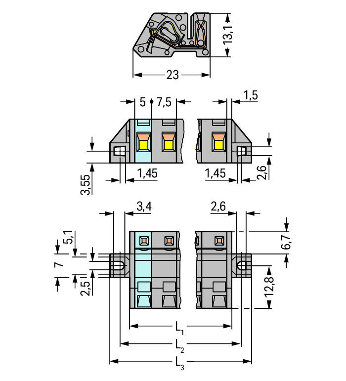

1-проводниковая розетка; угловые; зажимное кольцо; 2,5 мм²; Шаг контактов 7,5 мм; 8-пол.

Actuation type | Operating tool |
Clamping spring material | Chrome nickel spring steel (CrNi) |
Цвет | gray |
Conductor entry direction to mating direction | 90 ° |
Connection technology | CAGE CLAMP® |
Connector connection type | for conductors |
Contact material | Copper alloy |
Contact plating | tin-plated |
Contact type (pluggable connector) | Female connector/socket |
Country of origin | PL |
Габариты: глубина | 23 mm / 0.906 inch |
Design | angled, mountable |
Fine-stranded conductor | 0.08 … 2.5 mm² / 28 … 12 AWG |
Fine-stranded conductor with ferrule with plastic collar | 0.25 … 1.5 mm² |
Fine-stranded conductor with ferrule without plastic collar | 0.25 … 2.5 mm² |
Fire load | 0.307 MJ |
GTIN | 4044918575751 |
Height | 13.1 mm / 0.516 inch |
Legend (ratings) | (III / 2) ≙ Overvoltage category III / Pollution degree 2 |
Limit temperature range | -60 … +85 °C |
Material group | I |
Mismating protection | No |
Mounting type | Mounting flange |
Number of Poles | 8 |
Number of connection types | 1 |
Number of levels | 1 |
Pin spacing | 7.5 mm (0.295 inch) |
Product Group | 3 (Multi Conn. System) |
Rated current | 12 A |
Rated impulse voltage (II / 2) | 6 kV |
Rated impulse voltage (III / 2) | 6 kV |
Rated impulse voltage (III / 3) | 6 kV |
Rated voltage (II / 2) | 1000 В |
Rated voltage (III / 2) | 630 В |
Rated voltage (III / 3) | 500 В |
Solid conductor | 0.08 … 2.5 mm² / 28 … 12 AWG |
Strip length | 7 … 8 mm / 0.28 … 0.31 Inch |
Total number of connection points | 8 |
Total number of potentials | 8 |
Type of mounting | Feed-through mounting Panel mounting |
Вес | 14.32 г |
Ширина | 72.3 mm / 2.846 inch |
